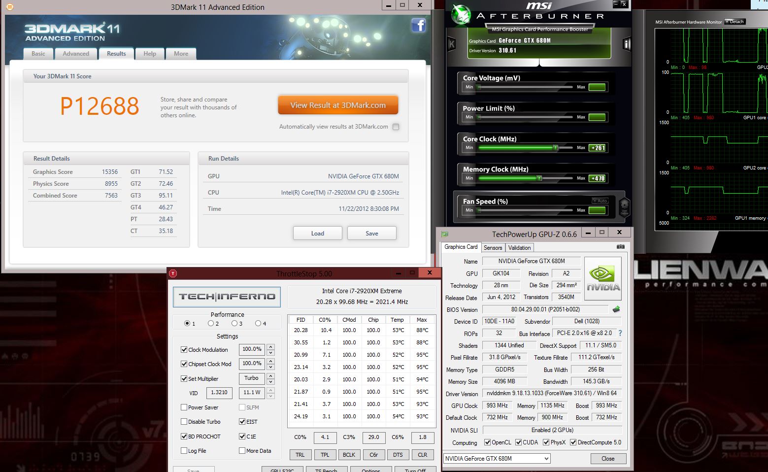

New clevo 680M vbios on the way from @svl7 soon I think (he'll have to give you the details). But here's a preview (check the graphics score):
Wow looks awesome :D
I see it is based off the 80.04.29 vbios again. Looking forward to this!
