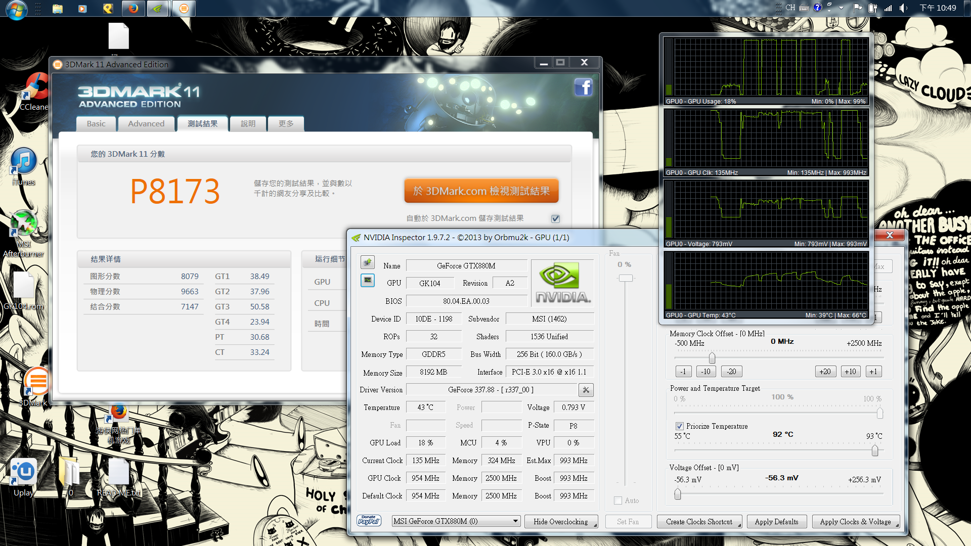

flightposite Posted June 2, 2014 Share Posted June 2, 2014 Thanks to svl7 and Jonhnkss for your great work.But I have a question that my machine is MSI GT70(with 880m),after i flash moded 880m vbios,my laptop doesnt identify 880m,how do i solve this problem? Quote Link to comment Share on other sites More sharing options...

svl7 Posted June 2, 2014 Author Share Posted June 2, 2014 after i flash moded 880m vbios,my laptop doesnt identify 880m,how do i solve this problem?Can you explain this a bit more detailed?What was your original vbios version? Quote Link to comment Share on other sites More sharing options...

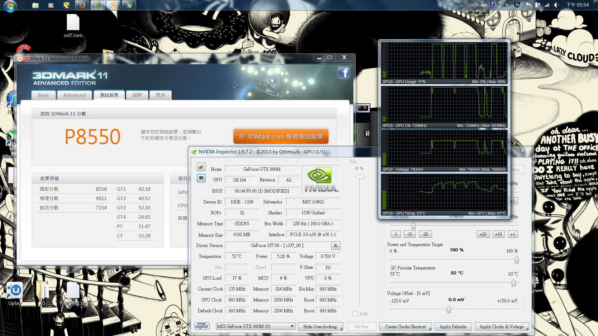

flightposite Posted June 2, 2014 Share Posted June 2, 2014 Can you explain this a bit more detailed?What was your original vbios version? Hi svl7 When I flash your moded vbios,in device manager/display adapter,gtx 880M can't be identified. it became to "Standard VGA Graphic Adapter". Is this because the moded vbios is dell version? I just use the moded INF from Laptopvideo2go,so i can install the driver 337.88. here is benchmark after I flash moded vbios here is with the original msi vbios After flash the moded vbios it is not throttling, but compare to original vbios, 3dmark 11 it just got +500 at stock. is this normail? - - - Updated - - - Can you explain this a bit more detailed?What was your original vbios version? Hi svl7 When I flash your moded vbios,in device manager/display adapter,gtx 880M can't be identified. it became to "Standard VGA Graphic Adapter". Is this because the moded vbios is dell version? I just use the moded INF from Laptopvideo2go,so i can install the driver 337.88. here is benchmark after I flash moded vbios here is with the original msi vbios After flash the moded vbios it is not throttling, but compare to original vbios, 3dmark 11 it just got +500 at stock. is this normail? BTW,here is my original MSI vbios. backup.zip Quote Link to comment Share on other sites More sharing options...
deadsmiley Posted June 2, 2014 Share Posted June 2, 2014 Hi svl7When I flash your moded vbios,in device manager/display adapter,gtx 880M can't be identified.it became to "Standard VGA Graphic Adapter".Is this because the moded vbios is dell version?I just use the moded INF from Laptopvideo2go,so i can install the driver 337.88.here is benchmark after I flash moded vbios[ATTACH=CONFIG]11772[/ATTACH]here is with the original msi vbios[ATTACH=CONFIG]11773[/ATTACH]After flash the moded vbios it is not throttling,but compare to original vbios, 3dmark 11 it just got +500 at stock.is this normail?BTW,here is my original MSI vbios.This is my 2 cents:The GPU graph tells the tale here. Your GPU isn't throttling, it is performing as it should have been from the factory. That is a good score and what you should expect from stock clocks with the modded vbios. Your temps are better than mine. I see 85c or more during 3DMark 11. Quote Link to comment Share on other sites More sharing options...
johnksss Posted June 2, 2014 Share Posted June 2, 2014 Hi svl7When I flash your moded vbios,in device manager/display adapter,gtx 880M can't be identified.it became to "Standard VGA Graphic Adapter".Is this because the moded vbios is dell version?I just use the moded INF from Laptopvideo2go,so i can install the driver 337.88.here is benchmark after I flash moded vbios[ATTACH=CONFIG]11772[/ATTACH]here is with the original msi vbios[ATTACH=CONFIG]11773[/ATTACH]After flash the moded vbios it is not throttling,but compare to original vbios, 3dmark 11 it just got +500 at stock.is this normail?- - - Updated - - -Hi svl7When I flash your moded vbios,in device manager/display adapter,gtx 880M can't be identified.it became to "Standard VGA Graphic Adapter".Is this because the moded vbios is dell version?I just use the moded INF from Laptopvideo2go,so i can install the driver 337.88.here is benchmark after I flash moded vbios[ATTACH=CONFIG]11772[/ATTACH]here is with the original msi vbios[ATTACH=CONFIG]11773[/ATTACH]After flash the moded vbios it is not throttling,but compare to original vbios, 3dmark 11 it just got +500 at stock.is this normail?BTW,here is my original MSI vbios.Short answer, no. you are a bit off of what a possible stock number should be, but of course this shows in my review of where should be at stock. Or basically with in 200 points.Sorry, no real explanation for why you are not getting near those numbers. Quote Link to comment Share on other sites More sharing options...
deadsmiley Posted June 2, 2014 Share Posted June 2, 2014 Short answer, no. you are a bit off of what a possible stock number should be, but of course this shows in my review of where should be at stock. Or basically with in 200 points.Sorry, no real explanation for why you are not getting near those numbers.After I read your post I went back and looked at what you did. You definitely did better in your 880M trial. However, all things aren't equal. Overclocked I was pulling close to 240w from the wall on my 230w PSU. Doesn't really matter in my case as I am limited by my thermals anyway. Quote Link to comment Share on other sites More sharing options...
