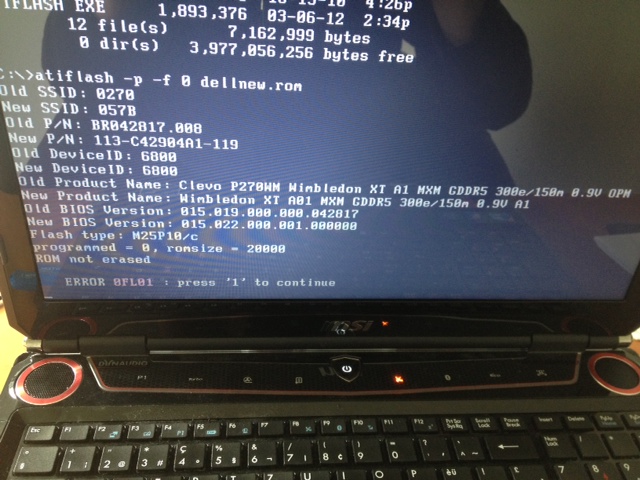

Darksnow47 Posted June 15, 2013 Share Posted June 15, 2013 Hi guys I have a very strange problem. I first had a Dell vbios which worked fine but the HDMI port didn't work. I then received a new vbios which by the seller which should fix the hdmi problem. Its a Clevo vbios with SSID 0270 for Clevo P278WM (see picture in the attachment). The problem I have is that there is no way to change the vbios anymore. It is like this vbios is locked in a special way (never had something like that). I always receive a 0FL01 error. I tried to force it. I also tried it with about 10 different vbios and with winflash. I was so desperate I event tried it with all different versions of Atiflash. No I just get: Adapter not found. But the card works great. Is overclocked and I get 7000 3dmark11 gpu score. Has anyone an idea how to unlock this bios and change it to a different one? Or any way to get a working hdmi? Greetings from Switzerland Quote Link to comment Share on other sites More sharing options...
