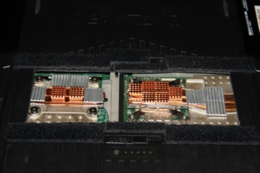

Khenglish Any other ideas to improve cooling based on the picture above?

Khenglish I tried to put this in a PM but I see you can't receive them so I hope people don't mind me putting this here. Regarding your post above on increasing cooling capacity, I've added some copper vram heatsinks to my heatpipes and have a big 140mm fan blowing air on them which definitely drops temps quite a bit. I wonder if you have any ideas to take this further or how I might add more heatpipes with or without integrated radiator fins to increase cooling on what is quite a limited cooling system in m15x, particularly on CPU side, where fan bracket is integrated into the heatsink. I've checked out Enertron and may buy a few standard heatpipes just for fun (unless you have some spares?) but how do I go about bending them? Thanks!
