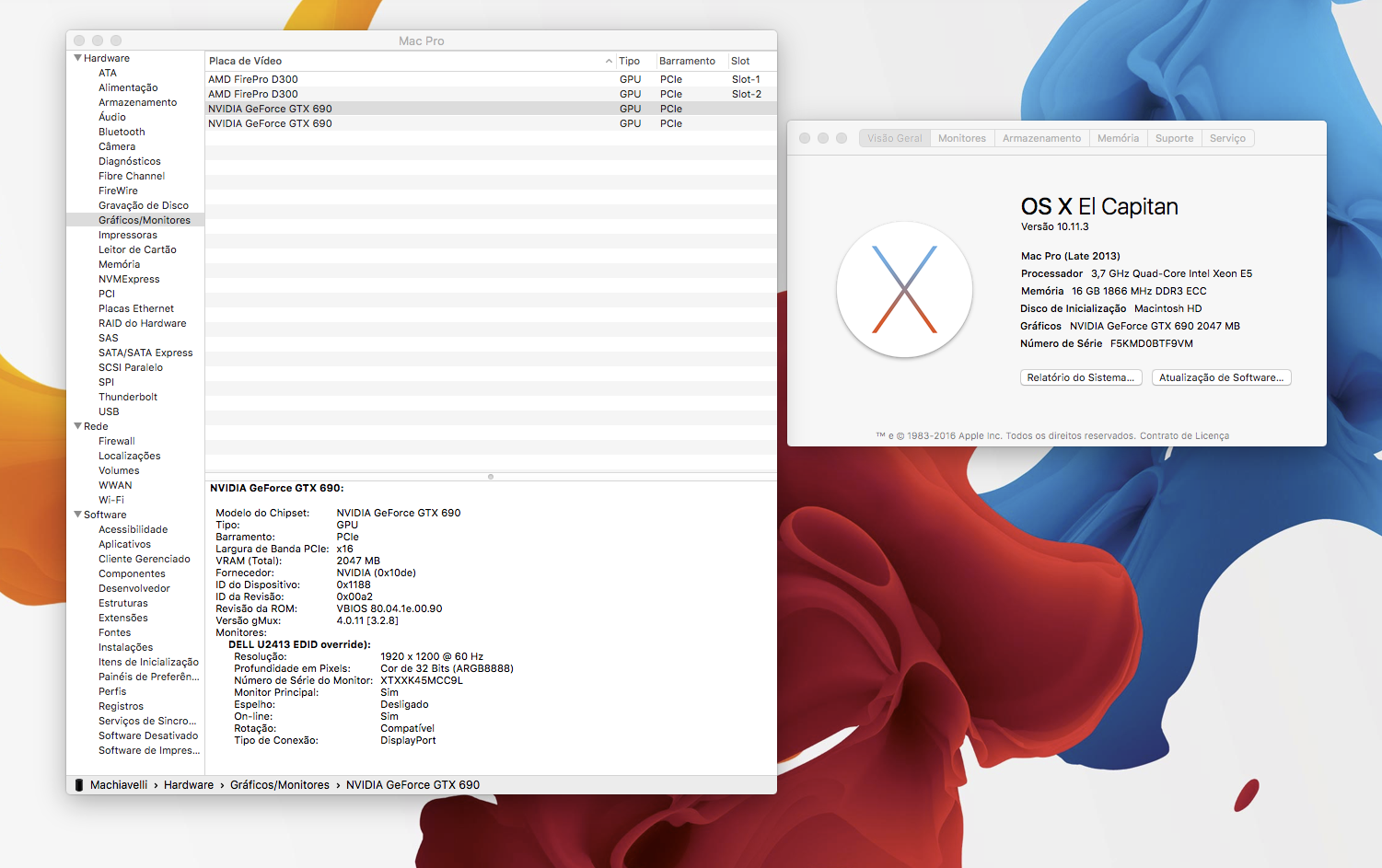

@Manjerone You have a dual-chip GPU, so the view is normal. I don’t know how OS X behaves with those cards via TB. Could be that OS X can only utilize the other GPU of your card.
