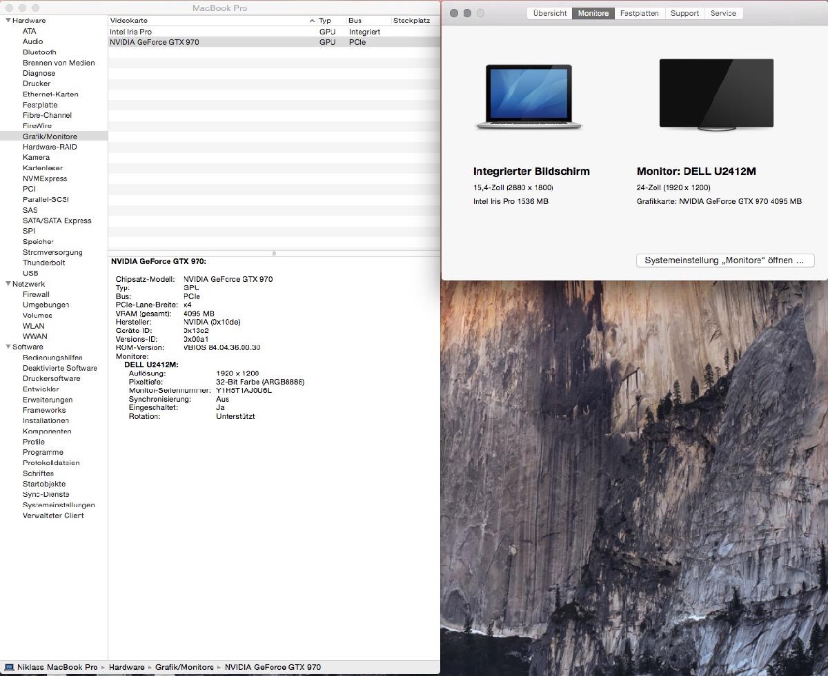

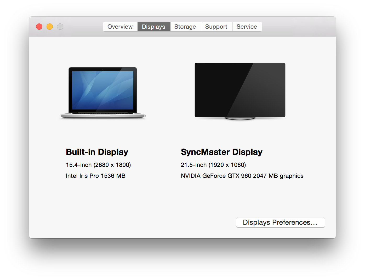

Tested on Late 2013 15” rMBP Iris Pro, External Display and eGPU is now working, epic! :joyous:

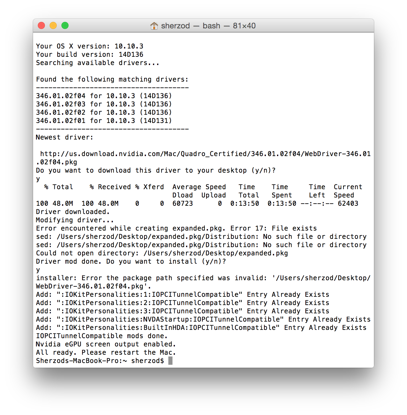

But I have that errors from script:
Error 17 File Exists, but there is no any file with name expanded.pkg on the desktop and it wasn't there. :suspicion:
Thanks!
- Are you sure that you didn’t have your own “expanded.pkg” on your desktop before running the script? I should add check or force delete if there exists such a file.
- Did you run the script with sudo?
- The expanded.pkg is a temporary file, it will be deleted right after web driver modification (in order to pass validateHardware/validateSoftware checks). If you try to run the script again, do you still see “file exists” error? Answer “n” if you see error messages.
- You have previously added manually IOPCITunnelCompatible keys, that’s why it notifies “Entry already exists”. This is a known issue.

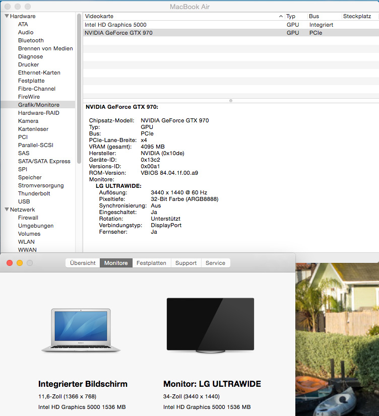

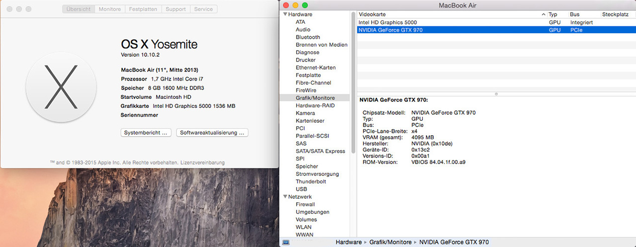

Hey Goalque,
first of all, I want to express my deepest respect for this amazing work. I think this is a huge step forward – towards a "install and then plug and play"-solution. Really great job, I cannot appreciate that enough.
I tried it with a Macbook Air 13" (mid-2013, OS X 10.10.3) with a Gigabyte GTX 750Ti Windforce + Sonnett Echo SE II. Unfortunately, the card is just detected as Nvidia chip model afterwards but as this was not my first try to use this card, I'm beginning to think that the card is the problem and not the setup. I'll try out another card as soon as I can get it. Will keep you posted if it works with that.

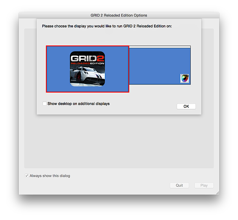

Ran a lot of benchmarks and it worked really good. But in Luxmark I can only run LuxBall and not Hotel Lobby or Neumann TLM.102 SE.
Added benchmarks in my guide: http://forum.techinferno.com/implementation-guides-apple/9821-2014-15-macbook-pro-iris-gtx970%4016gbps-tb2-akitio-thunder2-win8-1-%5Bdschijn-2%5D.html#post131966

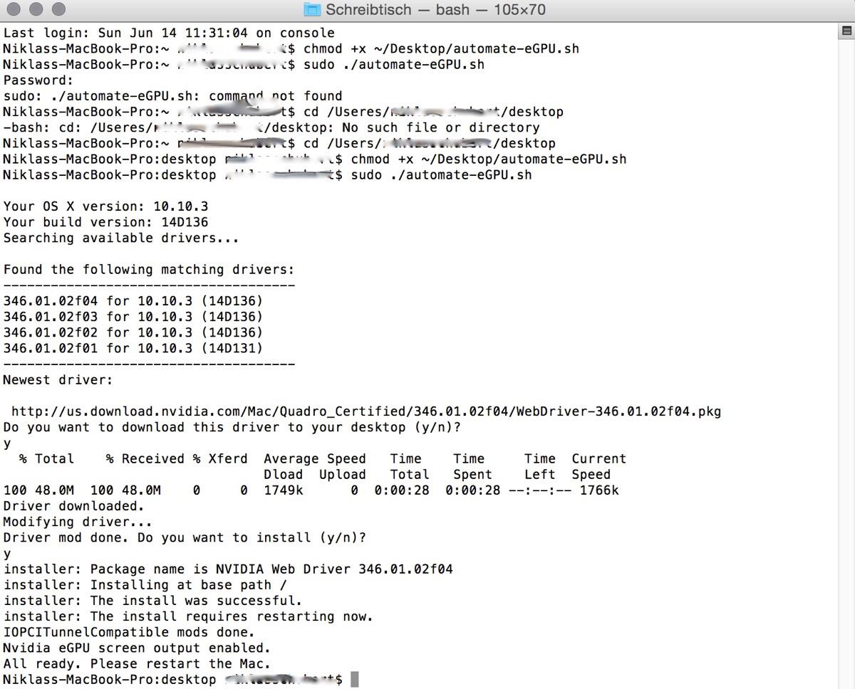

@Shez: Was the eGPU switched on during the installation? Or was it turned off, installed everything and rebooted with eGPU?
Fully off and not connected, rebooted with eGPU after installation.
Yes I'm sure.
Without sudo, looks like I missed sudo word being so exciting from this script
I think you should add force permission check before start the script, if possible. And if someone is already installed Web driver but want only activate eGPU screen output, your script doesn't allow that at that state of version of course ;)

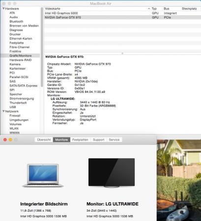

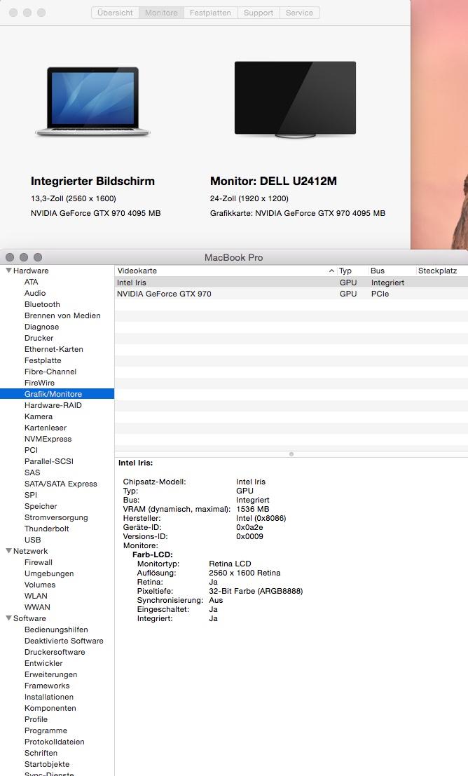

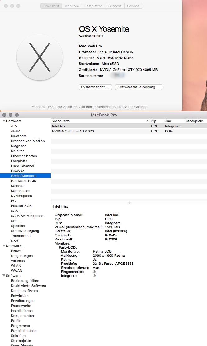

post-36170-14495000360068_thumb.jpgHi guys,
can you give me some advice how to select my eGPU after using the script?
Nvidia taskbar icon, syssettings panel active, Web Driver is selected, I see both cards in sysinfo but on the screen tab only iGPU is "active".
I'm on OSX 10.10.2

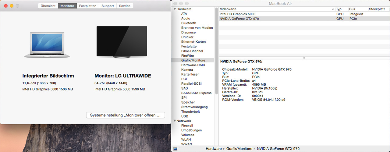

@Dschijn: Air -Apple TB-Cable-> Akitio -Akitio TB-Cable-> LGI even switched TB ports on the Akitio, detached Akitio and switched to default gfx driver and back on; nothing.--checked kext files for CFBundleIdentifier:
/System/Library/Extensions/NVDAStartup.kext/Contents/Info.plist/System/Library/Extensions/IONDRVSupport.kext/Info.plist[FONT=Consolas]/System/Library/Extensions/AppleHDA.kext/Contents/PlugIns/AppleHDAController.kext/Contents/Info.plist[/FONT]
[FONT=Consolas]<[/FONT][FONT=Consolas]key[/FONT][FONT=Consolas]>IOPCITunnelCompatible[/FONT][FONT=Consolas]key[/FONT][FONT=Consolas]>[/FONT][FONT=Consolas]<[/FONT][FONT=Consolas]true[/FONT][FONT=Consolas]/>[/FONT]
^ was missing a couple of times, reboot but no luck.
Quote
Where's that second TB cable from Akitio to LG plugged into? The Akitio itself, second port? That way you'd be daisy chaining it with your Macbook which won't let it be powered by the eGPU. Attach the monitor directly to the graphics card.
No no no no no… you are connecting a Thunderbolt display to the 2nd TB port on the AKiTiO? That is daisy chaining TB devices and by that your LG is directly connected to the MacBook. To get eGPU display output, you have to connect the display to the output ports of the GPU you are using and not the TB device hosting it.

So I just reinstalled the script (new version) and connected though DP to my LG but the only difference is in sysinfo: the LG screen is now assigned to my gtx 970.
But on the screen tab you can see that only iGPU is used for both screens, web driver is selected.
Air -original TB cable-> Akitio -DP cable-> LG
tried switching drivers with and without TB cable attached
thanks for your support :)
