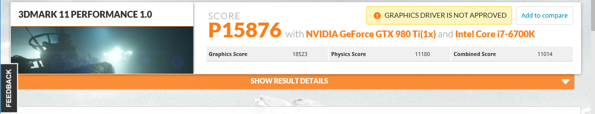

  3. Ok, I'm not sure if my settings were correct the last time I benchmarked. Here are updated results. 3DMark11 = http://www.3dmark.com/3dm11/10969734 GPU=19343 3DMark FireStrike = 3DMark Vantage = http://www.3dmark.com/3dmv/5417862 GPU=53759 I am using the most current NVidia drivers yet 3D Mark says graphics driver is not approved. These scores are from within Windows 10 Enterprise N 1511
  4. I completely forgot to link to get the link results until after I ran the tests. I'll re-do them tomorrow. Here's just some screenshots for now. I also noticed in the 3dmark11/13 results, the top results I clicked and the linked results weren't even close to what is noted on the chart. Maybe a mixup ? Actually the results are still in my history 3dmark11.GPU=18523 3dmark13-FS.GPU=15066 Vantage: http://www.3dmark.com/3dmv/5415007
