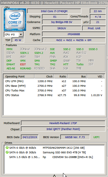

Our chipset is Mobile Intel QM77 Express. That chipset has 4 ports of SATA2 and 2 ports of SATA3. SATA HDD and SATA ODD are SATA3. It means that in our laptop available RAID0 only.
I use the eSATA port to easily move the same main boot drive between 2 different units (so to maintain only one common software system). Although the internal SATA port is always @SATA 3 speed level, eSATA port is always limited to SATA 2 on every HDD/SSD I have used. I do not know if this limit is there by design. So, if the DVD drive is connected to the 2nd and last SATA 3, then the eSATA port, is limited to SATA 2 speed.
2020-01-29 22_38_21-HWiNFO64 v6.20-4030 @ Hewlett-Packard HP EliteBook 2570p - System Summary.png

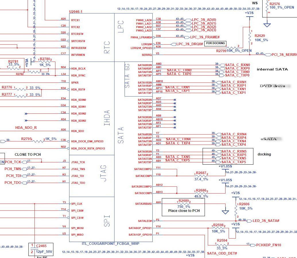

Because of the schematic:
Spoiler

12 hours ago, istinnstudio said:
Ok it is clear now.  Strange choice by hp... wasted SATA3 speed on a slow DVD device
Because DVD is installed as Extension Bay device, and probably HP made some original HDD/SSD caddies for these laptops.

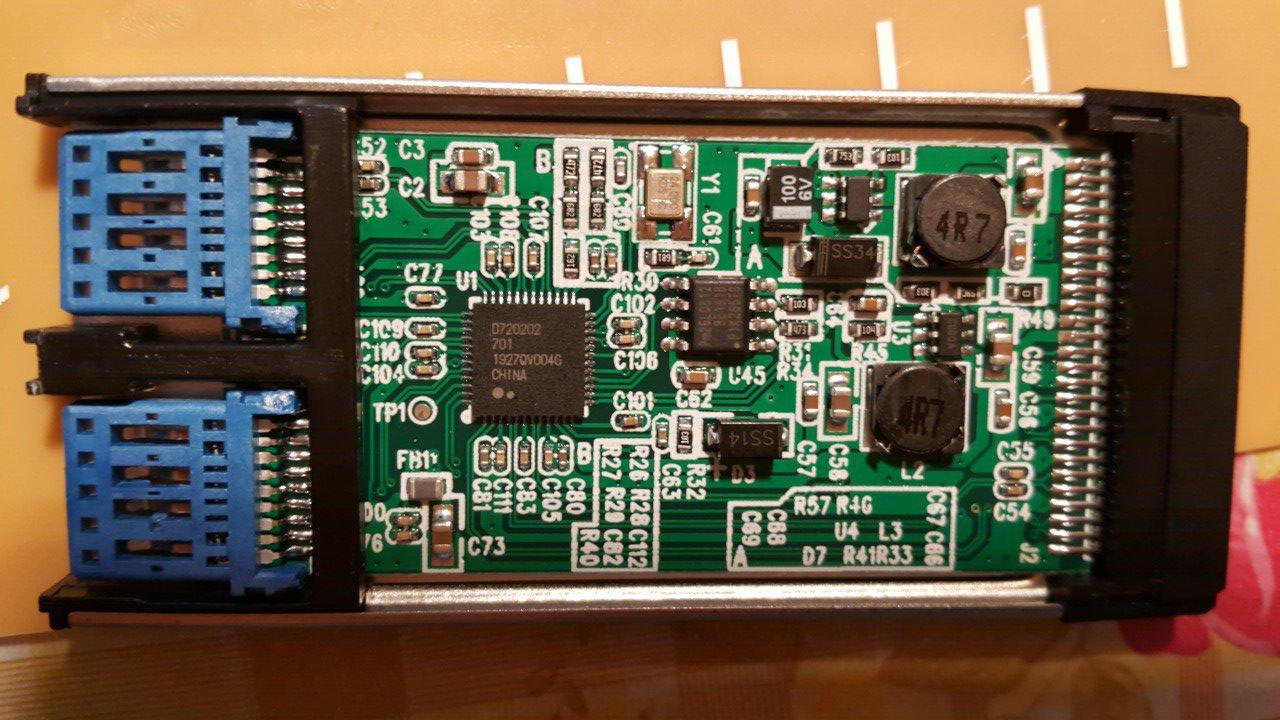

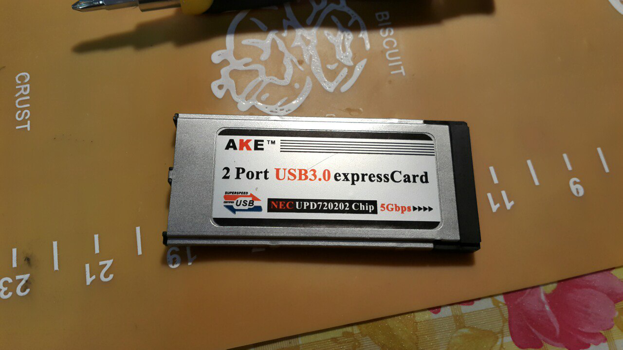

Guys, is there any owner of USB 3.0 "AKE" expresscard adapter that based on the uPD720202 chip? I've received one from ali, but cannot get it to work on Windows (error 10) and also cannot update the firmware (update tool just hangs). In linux it works after manual firmware upload, but only upon reboot. I want to try upload a dump from a definitely working
card.
card.
I had 2 of those (same chip, I do not remember the firm, I do not use it any more), the one failed after some days or it was problematic from the beginning. Similar issues with you as far as I can remember with a hp 8710w, and then 2570p. Check settings about USB power management and disable all about this device from the Reneseas driver and the windows device manager. Somehow I have updated firmware without problem, alternatively try to update firmware on a different notebook, but there always be a chance of hardware being faulty.

Can you dump the data from 8-pin EEPROM of the working one, please? Well, i've tried to update firmware with disabled controller and it works now, thank you!
...it works like crap.
Edited by MioIV

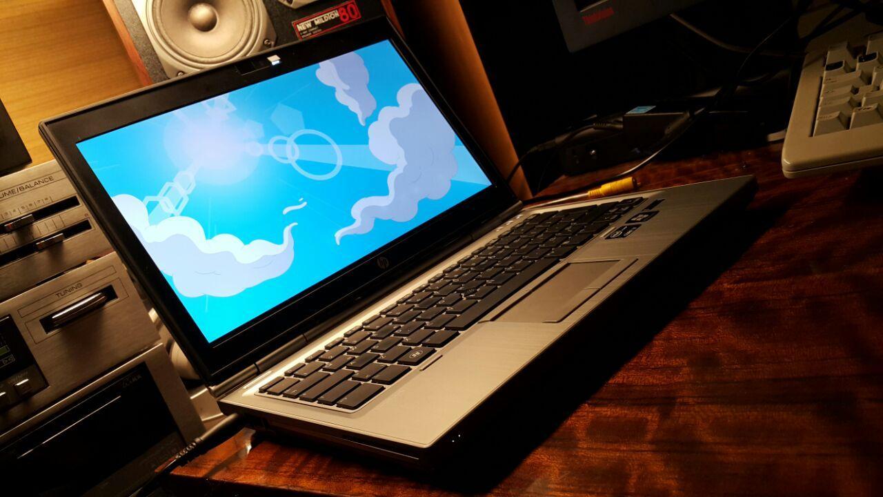

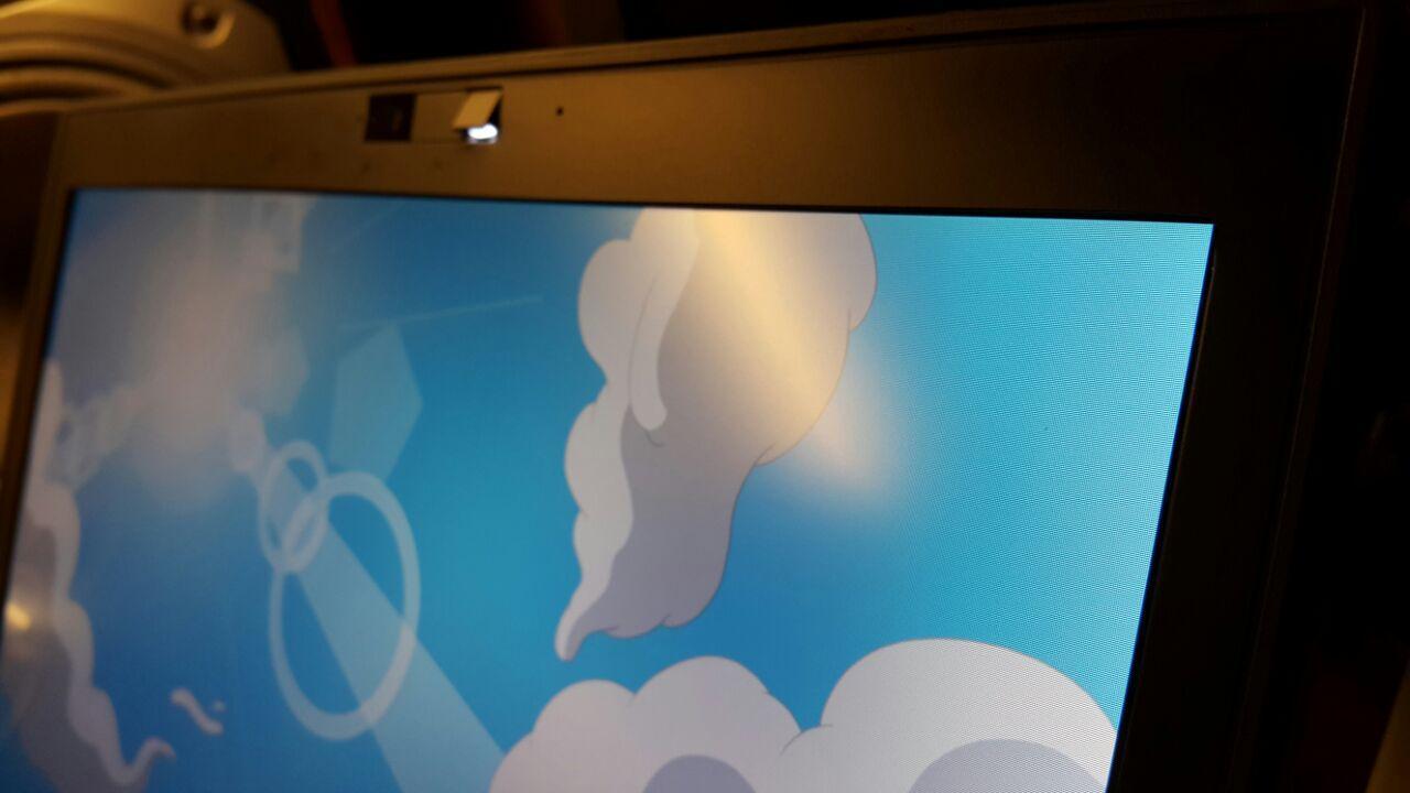

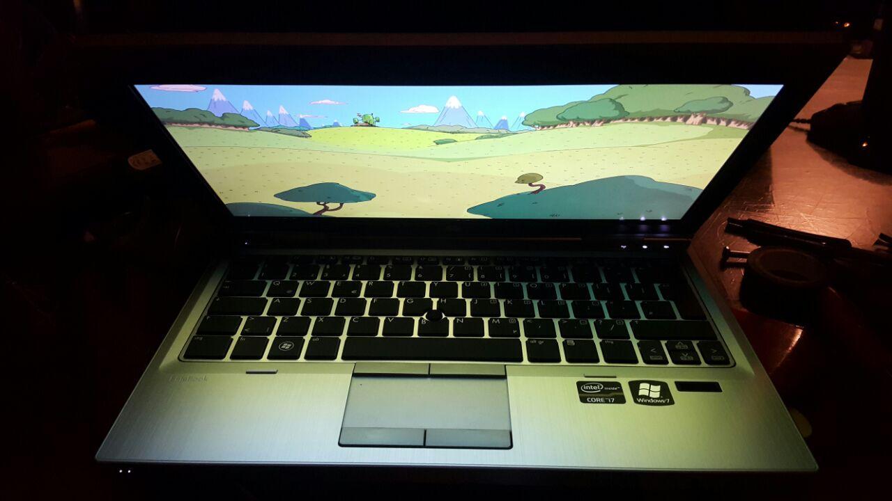

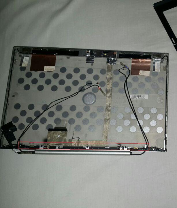

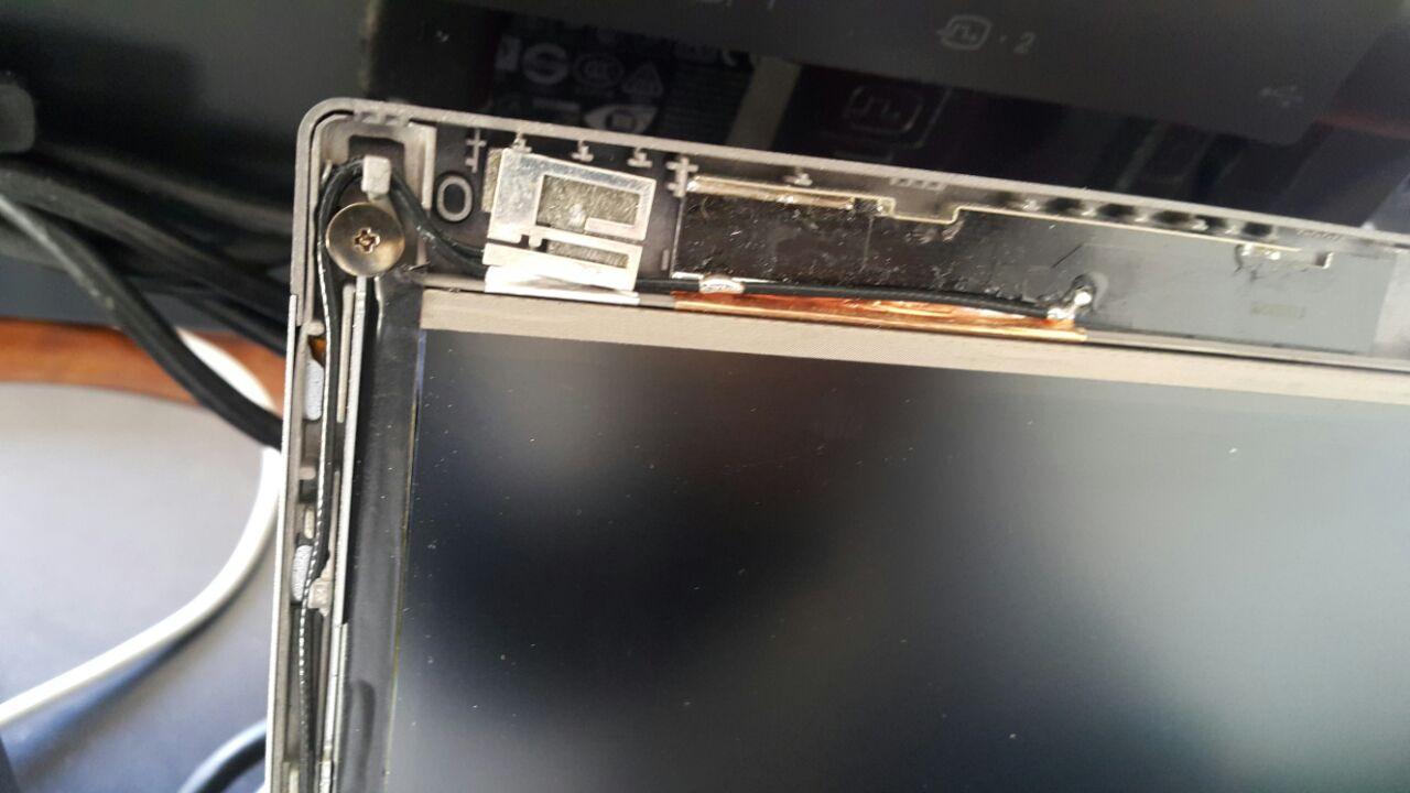

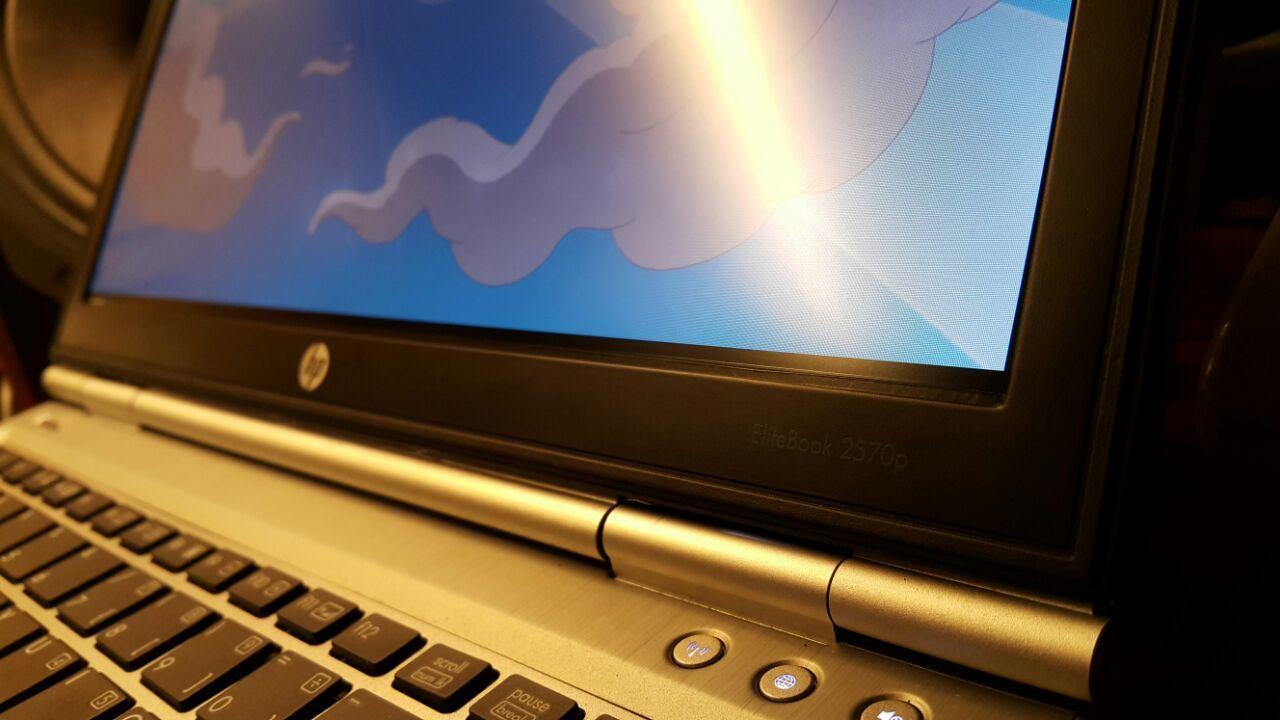

My 2570p successfully modified with X230's LG IPS Panel
The first thing I did was removing all the magnesium guinding lines for antenna wires and LCD cable compartment screw mounting holes that were on the LCD's way. And because the LCD cable compartment can't be screwed anymore it's held on place with epoxy.
Removing the the panel's screw mounting points was the most risky part, but the metal was soft enough to be cut with long scissors. That required replacing the LCD tape, otherwise screen layers would come off. I used kapton tape covered with electric tape all along the edges.
LCD cable appeared to be flexible enough to reach LCD's connector. The X230's panel is much thinner so there was enough room to do it.
The last thing to do was adapting the LCD bezel to the new screen. Because X230's panel is higher (the location of the circuit board) I had to cut 4 milimeters from the top of the LCD bezel. The different screen height exposed bottom LCD tape, so I replaced it with black tape. I also had to remove LCD bezel's bottom latches, now it's held on place with double-sided tape.
If you've got any questions feel free to ask.

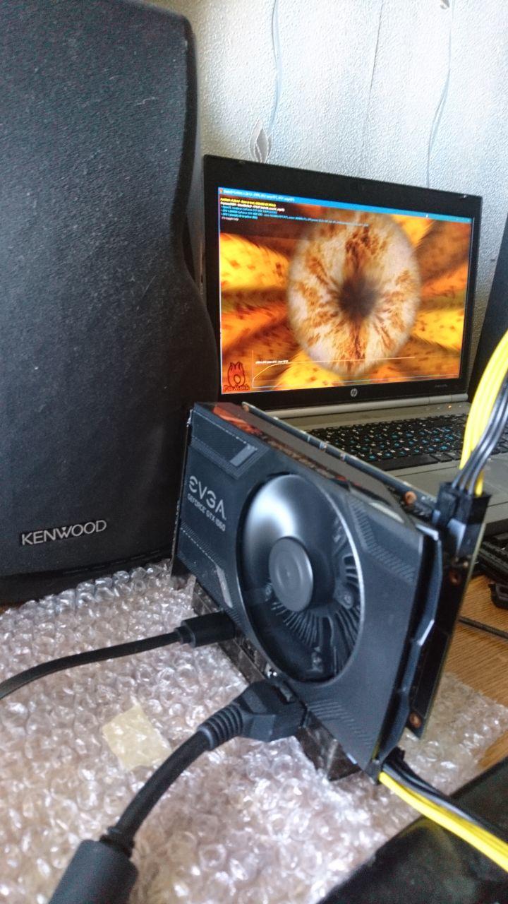

I used EXP Gdc expresscard + PSU Dell da-2. Works good but it's difficult to set up.  More information you can find at egpu io
