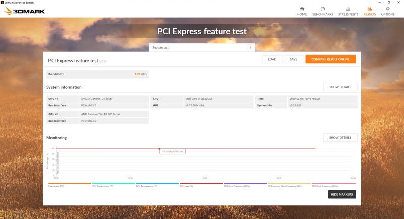

I got UL 3DMark Advanced Edition benchmark and it's PCI Express test, so i actually tested bandwidth for both: EVGA GeForce GTX 1080 Ti SC2 Gaming and Sapphire Radeon R9 380X. It's same - 3.28 GB\s.

Good news for anyone who wants to use adapter for 4k or 1440p gaming, pci-e 3.0 x8 is not a big bottleneck for RTX3080 (cpu will be for 1080p and maybe for 1440p, but probobly for 4k its still fine)
Pci-e benchmark
