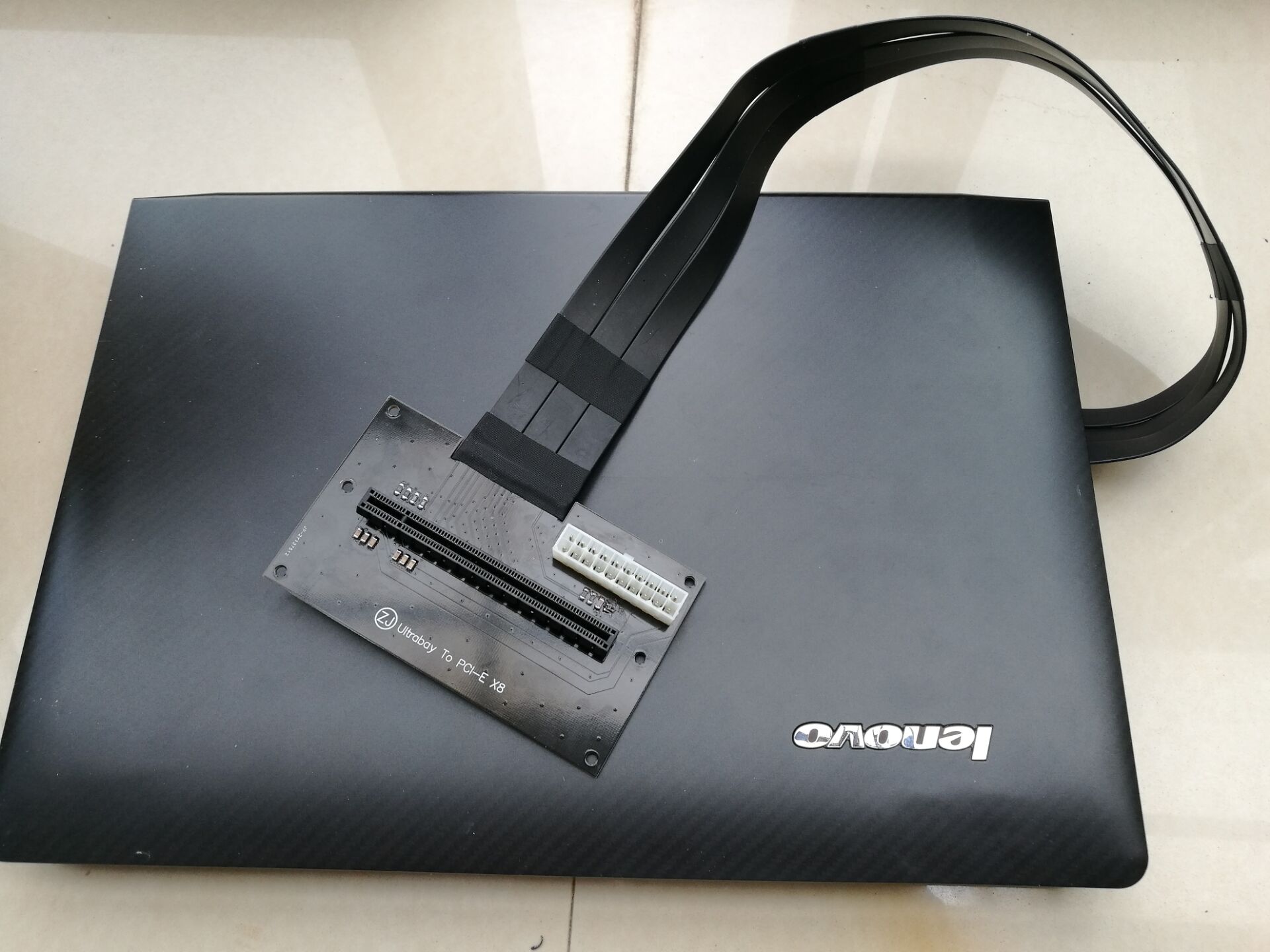

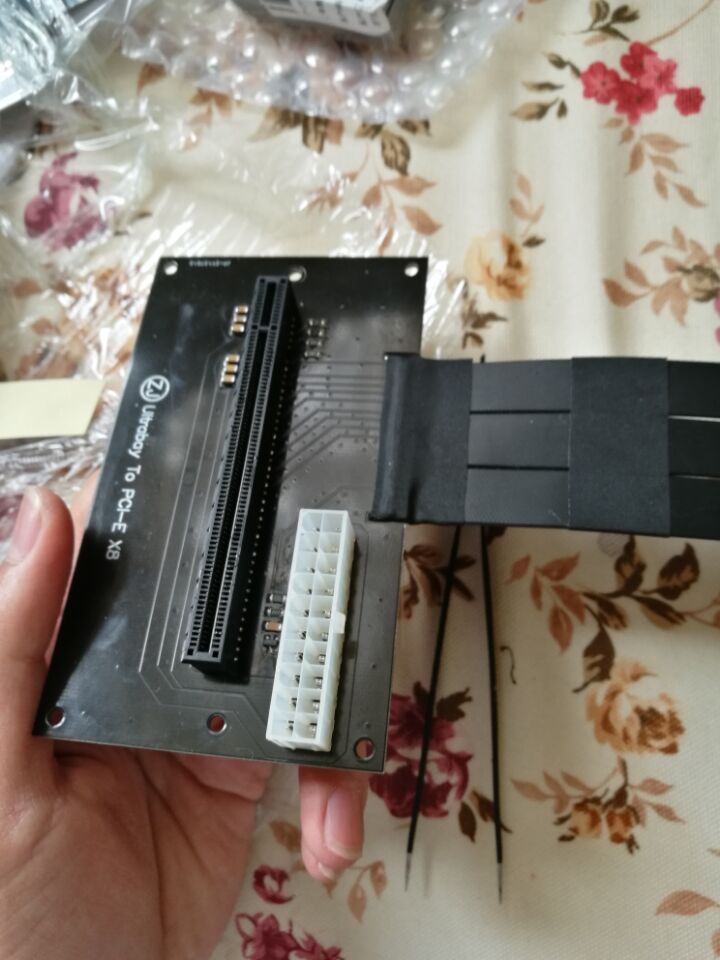

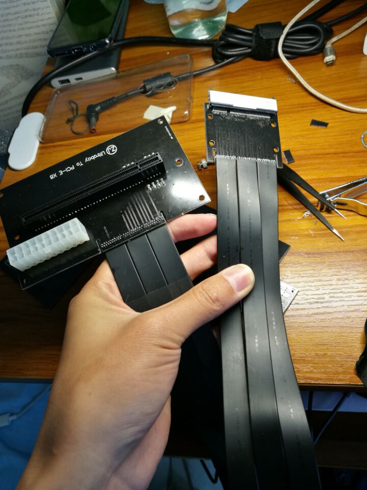

On 4/9/2018 at 3:37 PM, AllanDavidson said:
do you have any more pictures/information on this mod? What is this? A Ultrabay adaptar that have both PCI Express and SATA connectors?
That's simple.Just glue a 2.5“ to ODD tray and the adapter together then everything is great

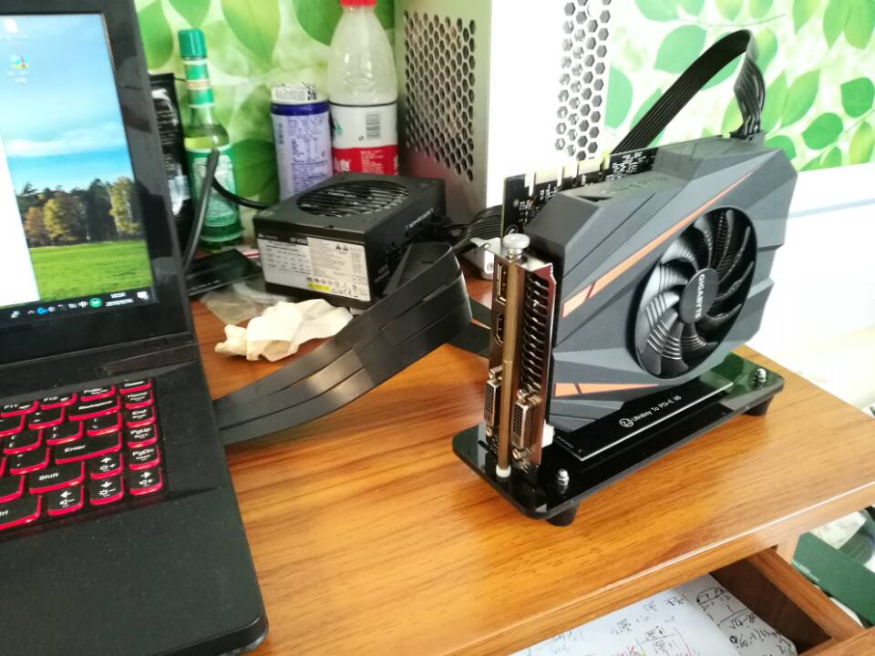

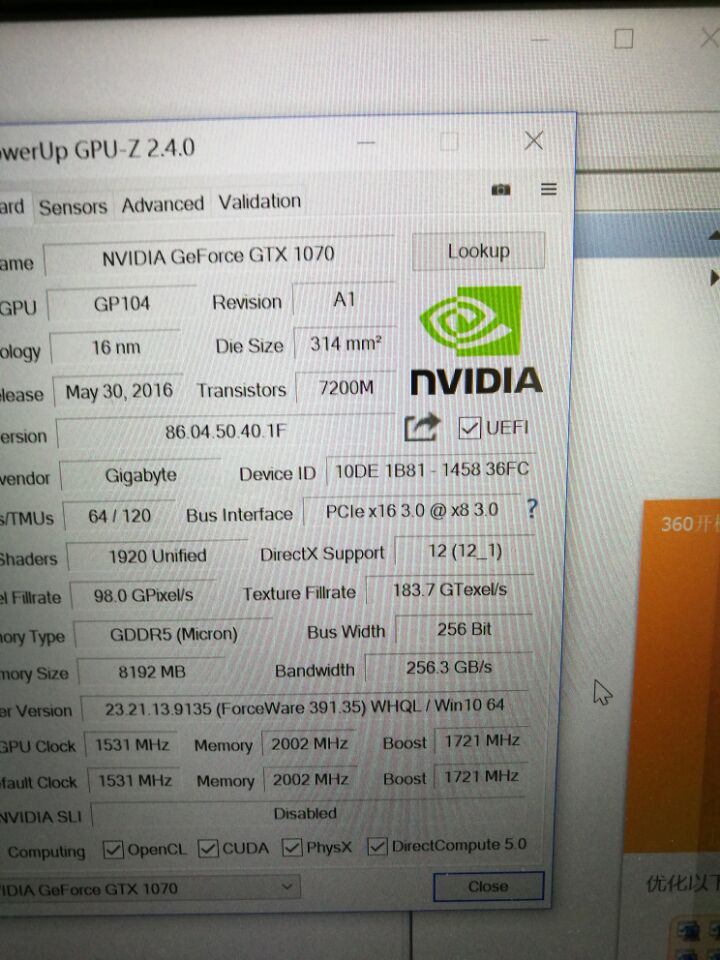

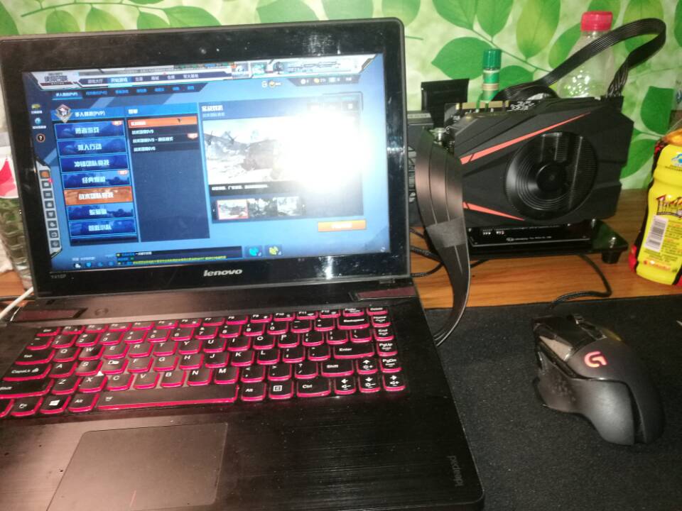

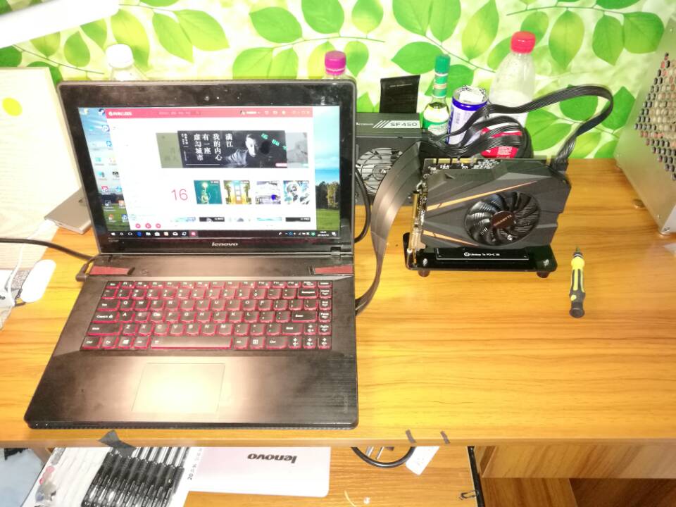

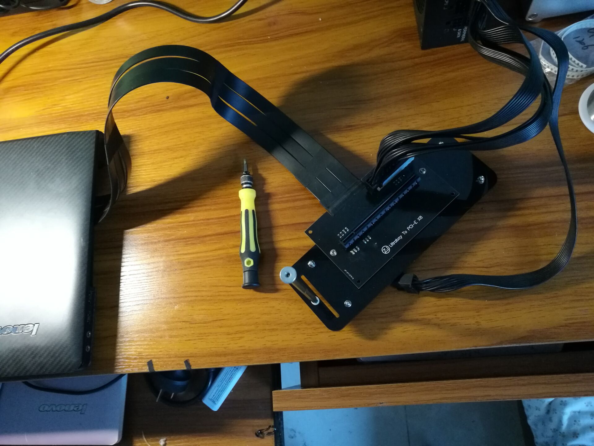

15 hours ago, MWichni said:
Hi, could you describe how to get the internal display to work with the eGPU?
for y410p/510p, attach the egpu (must be nvidia card), disable the GT750M/GT755M, disconnect any external display and everything should work fine. Optimus should be utilized in this way.
30 minutes ago, MWichni said:
Hi and thanks for the reply. Just tested it and everything works fine.
So you're saying it works with internal screen now? This is awesome! What GPU model are you using? And did it only require disabling internal Nvidia in device manager or also in BIOS?
According to my tests,just disable them in the device manager.(Haven't found related bios options lol) nvidia ones works fine. It seems that amd ones don't work in this way.
