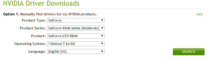

panda Posted January 7, 2016 Share Posted January 7, 2016 (edited) I tried Nvidia's 361.43 notebook driver. A thing to take note is that the notebook driver and the desktop version of 361.43 have the same filesize and version number. I did not check the files contents to see if they are identical. All tests were done using internal LCD only. Update: 361.43 drivers whether for desktop or notebook are exactly the same, same file size, same folder structure when extracted Background: I am currently on Nvidia 344.75 desktop driver on Windows 10, I find that any newer drivers gave me stuttery performance and flickering in Starcraft 2, WoW and Furmark. This has been happening even when I was on Windows 7, starting with drivers around 347.XX range (can't remember exactly which). System Specs: Thinkpad X220 Tablet i5-2520m 16GB Ram HD graphics 3000 Geforce GTX 560SE @ PE4L 2.1b running on internal LCD only (1366 x 768) WIndows 10 64bit Nvidia notebook driver test: Unmodded Surprisingly, the 361.43 notebook driver install without any problem unmodded. The flickering and stuttering only occur when I start a game in Starcraft 2. Tomb raider 2013 crashed while navigating in the main menu. Modded (with Nando's instruction above) Since it's a Windows 10 driver, some steps will differ such as "[NVIDIA_SetA_Devices.NTamd64.6.0]" will be "...NTamd64.10.0" instead. For this driver, Starcraft 2 starts flcikering and stuttering even in the main menu. This symptom is similar to some of the newer desktop driver I tried (35X.XX). Was not able to start a game due to the amount of flickering. Tomb Raider 2013 crashed as well. Thus, performance and stablity is worse than the unmodded driver. In the end I reverted back to driver 344.75. Hope the above info helps anyone who is troubleshooting optimus problems on their systems. Edited January 7, 2016 by panda Link to comment Share on other sites More sharing options...

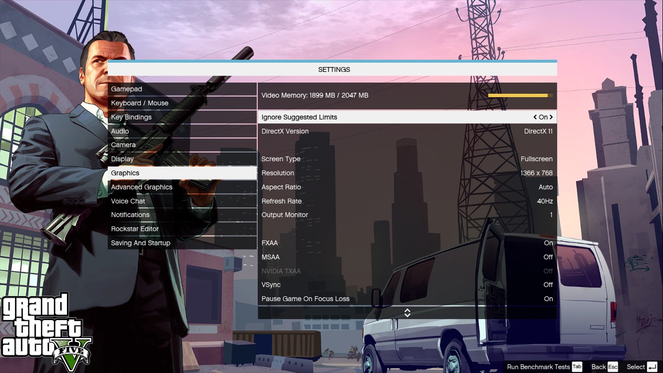

gharimanto Posted January 29, 2016 Share Posted January 29, 2016 I've been tried 361.75 version that the driver can detect egpu when playing game on internal mode As you see, I try GTA V. In setting menu, It's appeared about 2047mb. That's my gtx 750ti video memory in previous version, video memory only show up 1792 mb. It indicate egpu doesn't detected I clean install this driver for avoiding system failure. Good Luck 1 Link to comment Share on other sites More sharing options...

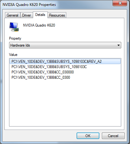

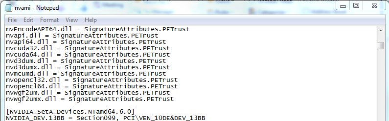

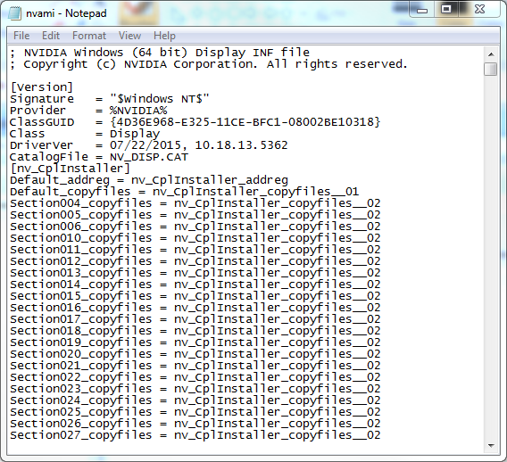

utopian201 Posted June 4, 2016 Share Posted June 4, 2016 (edited) On 06/01/2016 at 5:44 PM, Tech Inferno Fan said: Would someone pls try the steps in my last post to see if modified NVidia laptop drivers enable Optimus under Win10? It has no effect on 368.22. I am testing with an old Geforce GT440 and it installs the drivers from nv_dispi.inf, not nvami.inf. There is no need to modify nv_dispi.inf as it already contains the definitions for desktop cards. I have also tried 350.12 on Windows 10 (mechwarrior online). It crashes with the following error: The GPU activity window shows the game. With the latest drivers (368.22), it just goes back to the integrated graphics. Edited June 4, 2016 by utopian201 Link to comment Share on other sites More sharing options...
