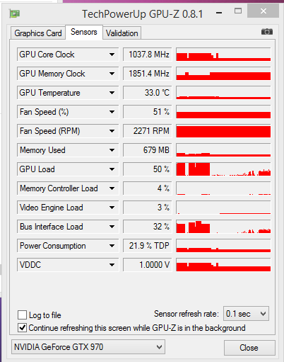

After messing around with my TOLUD and installing brand new nVidia drivers, I noticed this new counter in GPUz. Very cool thing to have and I can easily tell what games are being bandwidth limited by Thunderbolt. Anybody else have/notice this counter? (Bus Interface Load)
