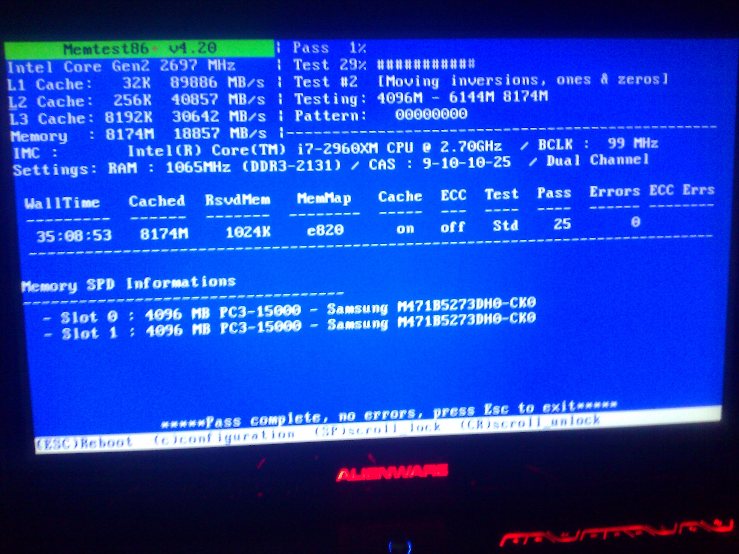

Hey guys got some cool infos and more progress on overclocking my ram... but my project has been put on hold due to my 580m's causing shorts in my system. So i am not going to post the bulk of my findings yet... as I have not finished and was interrupted by my video card mess.
So here is 35 hours passed error free in memtest86+ version 4.2 newest. The ram is set at 1.55v via bios and 2133 via bios... I even got XMP to work correctly at 2133 now.
Get this though I got them stable at 2133mhz on CL9-10-10-25 :) that's right eat your heart out Kingston :P

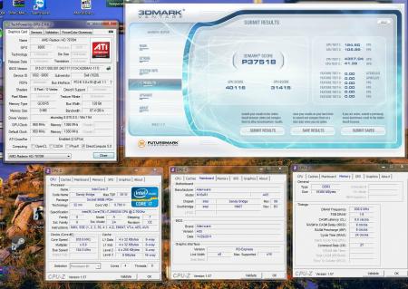

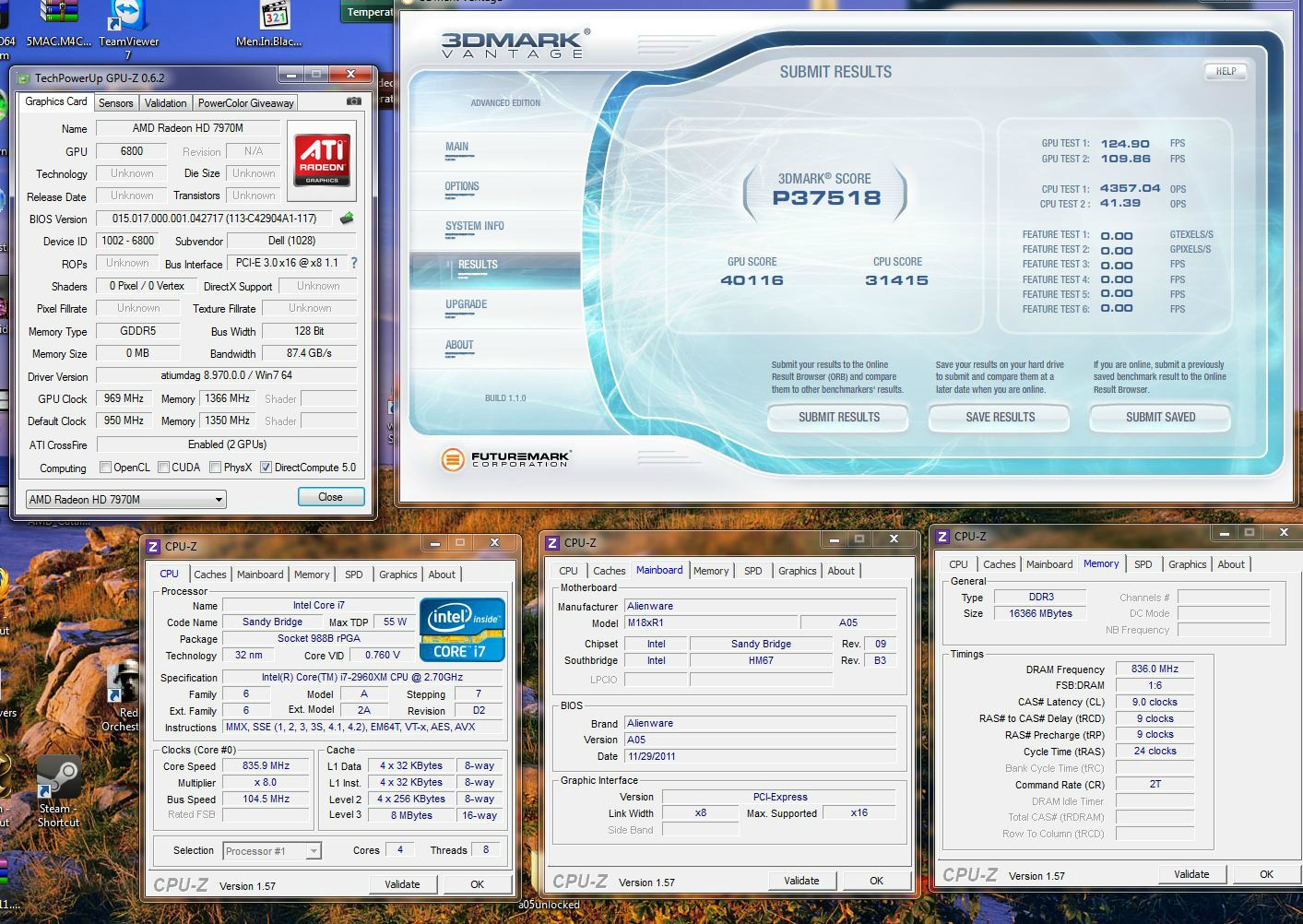

Great job digitalfubar I see you got the drivers all set now congrats. Those are awesome gpu scores and you broke 10k 3dmark11 that's epic. So was John able to assist in get a driver stable? How stable are they now. The driver version is in the posted scores 8.9etc
Was all you need a added line to the .inf file before installing driver?
Fubar, are those dell cards? If so how did you get your hands on them? I've tried from dell but they are back ordered.
yes those are Dell cards but the drivers are not fully working as of yet 100%... so this and maybe supply is low right now... but yes those are Dell see here http://forum.techinferno.com/general-notebook-discussions/1736-amd-7970m-modified-vbios.html#post21542
Dell is probably not going to have them available like that for a little longer... Digital Fubar got granted a pair in a special circumstance. Most likely as soon as AMD releases a generic driver for the mobile 7000 series the Dell cards should be for sale... I spoke with a tech working in the labs with that card so they do have them but I guess aren't quite ready to sell them or issue any more till better driver is released soon.
my discrete cards that are broken are out of my system till I have a resolution from Alienware... waiting on word from a tech. I went back to my ram project and decided to game on IGP. Previous testing rendered IGP useless at 2133mhz ram as its dependent on ram speed and even long to short term windows usage with a full dual channel set in use. My 1866 Corsair Vengeance gave me trouble too and they are stock right now. So since the discrete cards have been out for a few... i am no longer having issues throw my results. Previous I seemed to have issue using IGP and ram set to anything but auto...(1.5v) and now its working fine on increased volts. So I tested the corsair and they are now stable on IGP. i tested my Samsung chips at 2133mhz 13-13-13 timings... and they ran fine on 1.5v but long term wasn't stable. So I tried again with the increased volts and the previous corruption i got before didn't reoccur. So I set 1.55v as I needed and confirmed with memtest above... and the 2133 at 13-13-13 was running stable in windows :) I then loaded my tightest timings that i came up with and they are running stable in wndows on IGP at 2133mhz ram 9-10-10-26 timings with 1.55v :) I will post a WINSAT mem comparison and some more info tommorow. Been gaming for a few hours on IGP and no probs :) Been running Dirt 3 but am going to try a stronger one like the witcher 2.... i'll see if the is a FPS difference. Notice the GPU bandwith... its usually about 15-16gb for average ram at 1067-1600mhz the 35gb is from it being 2133mhz ram
so my system has been fully stable like this in windows now. i'll run my system like this for atleast a month and I may leave it permanently but wither way i'll report back on how the system has handled it.

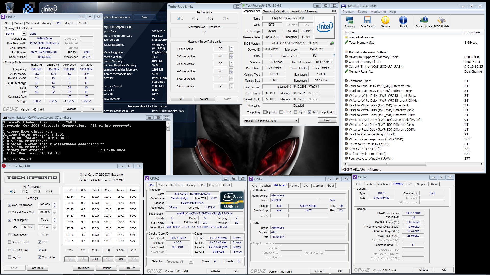

Guys check this out 31.6gb bandwidth on Winsat MEM (windows assesment tool) on laptop ram :o

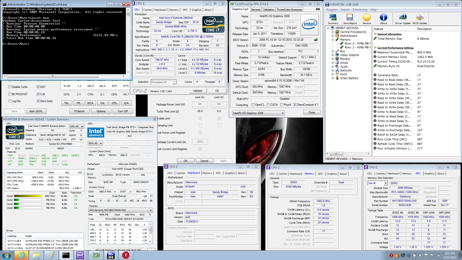

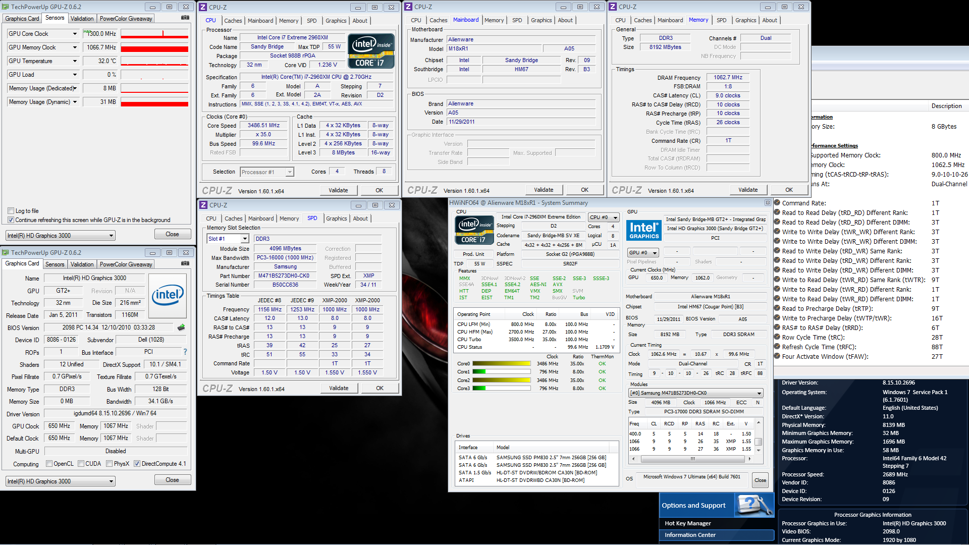

this isn't the bulk of my work or anything but here is my 2133mhz 8gb dual channe DDR3 So-dimm fully stable and usable in windows and on IGP for that matter so I know its really stable as the gpu uses the system ram exclusively for its VRAM :)
Been playing some Dirt3 and Diablo 3 on it:)
3.5ghz 2960XM @ 1.55v 2133mhz ram 9-10-10-25

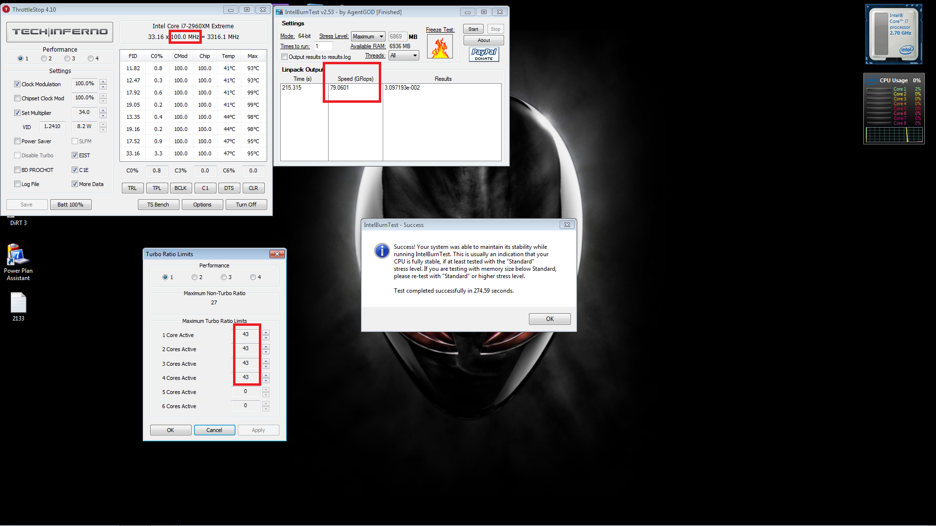

4.5ghz 2960XM @ 1.55v 2133mhz ram 9-10-10-25
IBT 4.3ghz
