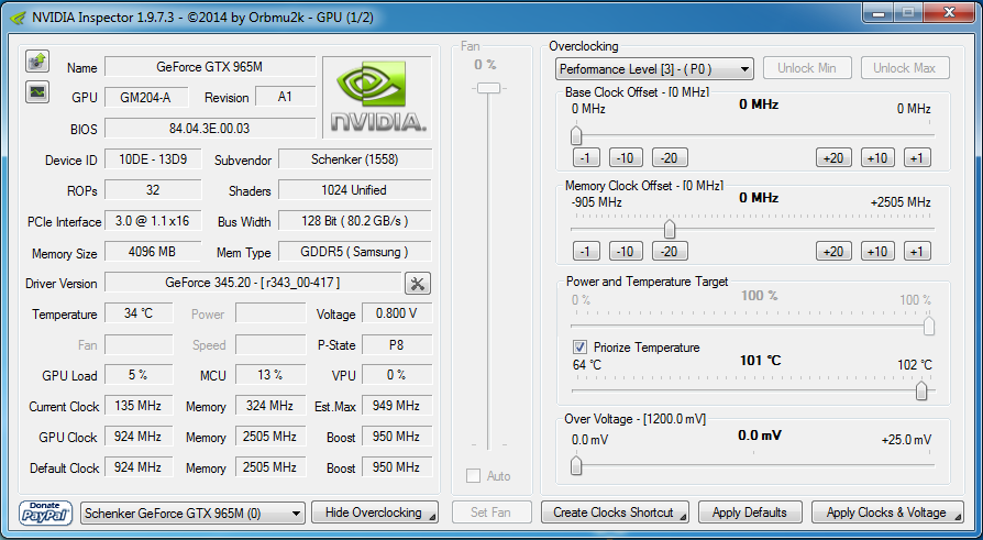

Well, here the currently shipping GTX970M vBIOS:
It is NOT modified, that's an Inspector error!
These are all systems that until now used to ship and have been reviewed with overclock enabled vBIOS.
The only way they can still fix this is to let the next driver ignore the new "core OC disable" bit, which now appears to be present in every single vBIOS made since December. clear.png
These are all systems that until now used to ship and have been reviewed with overclock enabled vBIOS. The only way they can still fix this is to let the next driver ignore the new "core OC disable" bit, which now appears to be present in every single vBIOS made since December. clear.png

Correct, they used to ship the same systems with OC enabled vBIOS.
With the latest batch of the same system GTX980M, GTX970M & GTX965M are all locked.
If NVIDIA doesn't set a new driver to ignore the "OC disabled bit" then these cards can not be OCed without flashing the vBIOS to a Mod or older version (if available).
Until now there is no driver (old or new) that can OC these cards in their current state.
I haven't seen a single Maxwell Mobile vBIOS that's dated December or later (from any OEM) that doesn't have this new block.
The first OC-blocked 347 driver also dates to early December, so they pushed both to OEMs at the same time...
