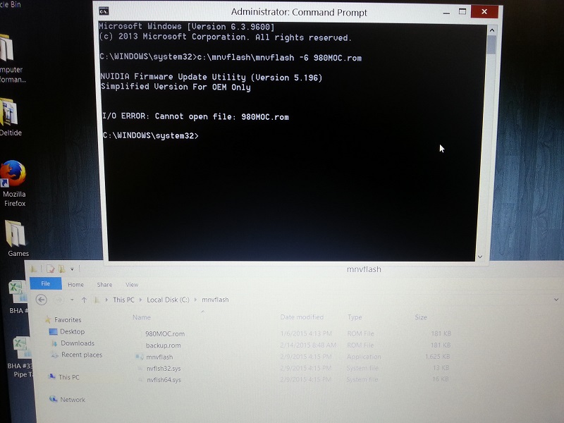

Can anybody please help me!? Whenever I try to flash with mnvflash it is telling me I/O Error: Cannot open file: 980MOC.rom.
I backed up my current vbios and was able to flash it, did this just to see if it worked. Whenever I try to flash the overclock vbios I get the I/O error message every time.post-33046-14494999444876_thumb.jpg

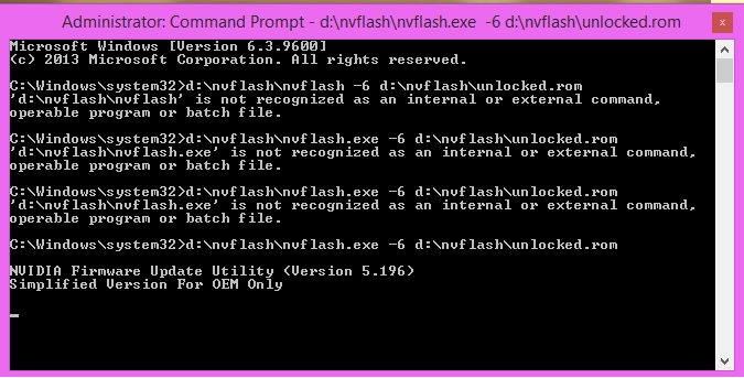

You don't run it from the nvflash file. You should open an elevated command prompt then type in the commands. In my case: c:\nvflash\nvflash.exe -6 c:\nvflash\XXXXX.rom where XXXX is the vbios file name located in the nvflash folder.
Pic to help you out:
[ATTACH=CONFIG]14008[/ATTACH]
PS: Don't forget to disable the display driver in the device manager before running the above command. ;)
I tried flashing the card with unlocked BIOS. This is how far I get, but it gets stuck at this point. The card is disabled in the device manager before the flashing. What could be wrong?
