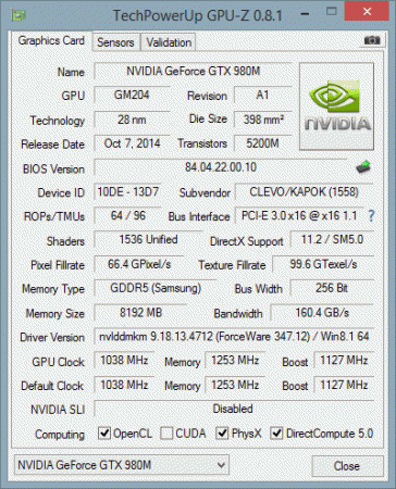

jarredwalton Posted February 23, 2015 Share Posted February 23, 2015 Hi everyone,So I'm researching overclocking of GTX 980M, as NVIDIA has apparently capitulated and will be re-enabling the functionality with a future driver. I've got a Clevo P750ZM notebook, and I've installed the 344.75 drivers. Long story short: I can't figure out what program will let me overclock at all. EVGA Precision crashes immediately on loading, and MSI Afterburner 4.1 doesn't allow GPU core adjustments (though I can tweak RAM clocks apparently). GPU Tweak seems to be in the same category as MSI Afterburner. Is it possible the P750ZM isn't supported right now and that's my problem, or is there some other utility you'd recommend for this?On a related note, what about the Prema VBIOS mods? If anyone wants to email me for some discussion, please do so. Yes, I'm *that* Jarred Walton. Quote Link to comment Share on other sites More sharing options...
Founder Brian Posted February 24, 2015 Founder Share Posted February 24, 2015 Hey Jarred, welcome to T|I, good to have you here. Did you recently get a hold of that Clevo? If so, you may be interested to take a look here: http://forum.techinferno.com/general-notebook-discussions/8998-nvidia-officially-states-they-cut-overclocking-mobile-gpus-3.html#post124474 Apparently NVIDIA has began locking down vbios now in new 970M/980M shipments. So while technically they claim they will re-enable overclocking in their drives, they're putting in lockouts on their vbios. Definitely something worth noting in your article on AT when the time comes. Also, @Prema and @svl7 are our resident modders so they should be able to help you with any questions you have. Quote Link to comment Share on other sites More sharing options...
Khenglish Posted February 24, 2015 Share Posted February 24, 2015 It sounds like you have a vBIOS locked 980m. It only allows memory overclocking. Basically you need to use a modded version of NVFLASH to flash on svl7's vbios to have full overclocking. This also enables power limit and voltage control.http://forum.techinferno.com/general-notebook-discussions/8998-nvidia-officially-states-they-cut-overclocking-mobile-gpus-12.html#post124474 Quote Link to comment Share on other sites More sharing options...

jarredwalton Posted February 24, 2015 Share Posted February 24, 2015 @JarredDisable UEFI in F2 BIOS menu and boot from USB with F7 afterwards. BIOS flash in DOS. vBIOS flash in Windows. Just figured that out. So question: I was intending to just update the VBIOS, but should I also get an updated system BIOS? Current version/firmware is 1.03.06EC v1a, KBC/EC: 1.03.03. It's Eurocom and already mentions Prema, so maybe no need? If you're wondering, the VBIOS is listed as 84.04.3E.00.01, dated 12/08/14 -- this is locked as far as I can tell to RAM adjustments. Quote Link to comment Share on other sites More sharing options...
Guest Posted February 24, 2015 Share Posted February 24, 2015 That's an older BIOS/EC version, I'll mail you the current one...The vBIOS you have there is the current stock one with NVIDIAs new OC lock... Quote Link to comment Share on other sites More sharing options...

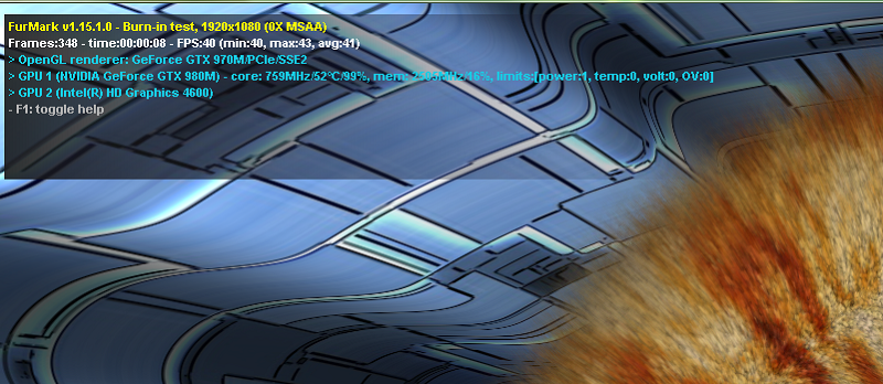

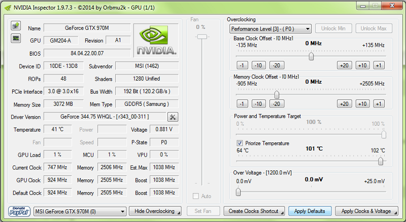

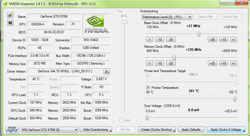

michael.stoch Posted February 25, 2015 Share Posted February 25, 2015 not OC & oc results from Furmark Not OC settings OC settings. same thing before it drops. Current Clock always hangs around 759 mhz core clock during FurMark stress tes; where i do my testing to see what its actually pumping. its pumping less then default stock..... Does Dragon Gaming centre have anything to do with this? or any other third party software? msi afterburner was turned off here. should i try a different program to check? Quote Link to comment Share on other sites More sharing options...
jaybee83 Posted February 25, 2015 Share Posted February 25, 2015 nvidia gpus have a builtin throttle mechanism for furmark/kombustor/occt, so i wouldnt use those to stress test ur gpu. just use a benchmark like firestrike, unigine valley or a demanding game like bf4 or crysis 3 instead Sent from my Nexus 5 using Tapatalk Quote Link to comment Share on other sites More sharing options...
