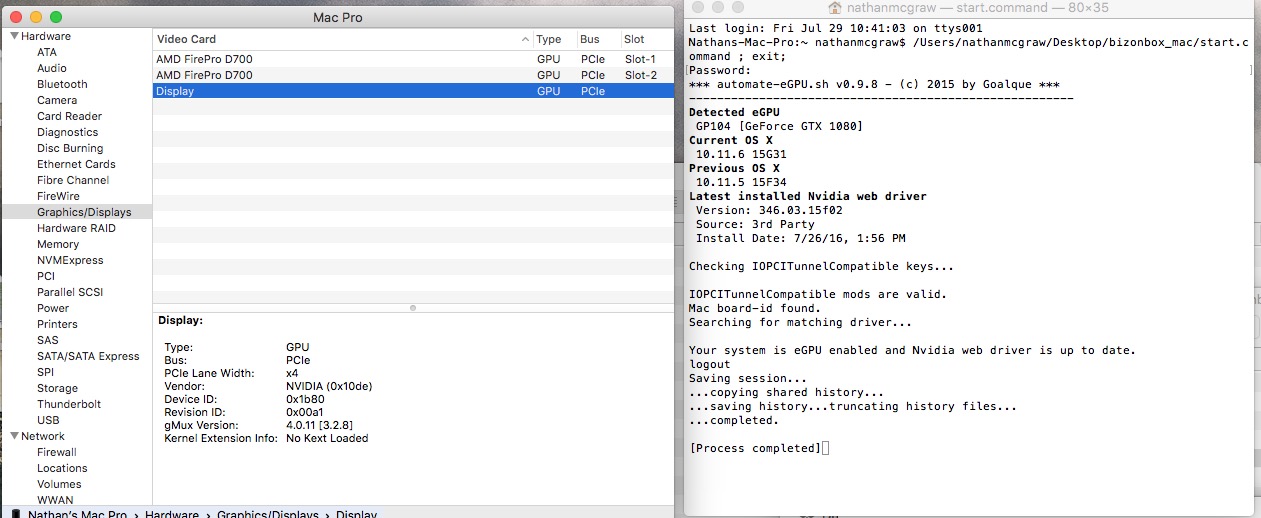

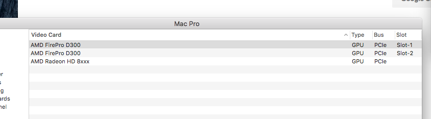

Hey everyone, I've been trying to get my eGPU set up for about a month on and off now and haven't had any luck. I have a Late 2013 (trash can) Mac Pro running El Capitan 10.11.5 (15F34). I have a Corsair 1000W PSU powering my MSI GTX 980 ti that is plugged directly into my Akito that is being powered by a molex - barrel plug from the PSU. My end goal is to use this eGPU to run Octane Render in Cinema 4D.
 At first I followed this tutorial posted on the Octane Mac+eGPU Forum. I followed this since the guy has a Mac Pro trash can as well and his end goal was to use for Octane. No luck, my Mac would never start up with the eGPU connected, it wouldn't even get to the start up chime. I then messed around with plugging it in a certain times during startup or turning the Mac and eGPU on at the same time but again, no luck.
I thought it must be me making a silly software mistake b/c I don't have much knowledge of this so when I came across the goalque script I thought I was in the clear. No luck with that either. I followed all instructions and still get the same results as before. Until recently my Mac would never even get through the startup while the eGPU was connected. The other day I bought an Apple TBolt 2 cable to use instead of the stock one that came with the Akito and my Mac would get past the startup and I could log in. Instead of seeing my NVIDIA 980ti below my two AMD's under graphics/displays in system report I would see this AMD Radeon HD 8xxxamdradeonhd8xxx?.png
I never really understood this and could not find any information about it online. I've restarted my Mac from backups and the AMD Radeon HD 8xxx does not appear anymore. Whenever I install the drivers and edit the kext files or use the goalque script this AMD Radeon HD 8xxx appears when the eGPU is connected.
Any insight anyone has into this would be greatly appreciated! I will gladly provide additional information to anyone that needs it.
Thanks,
Luke

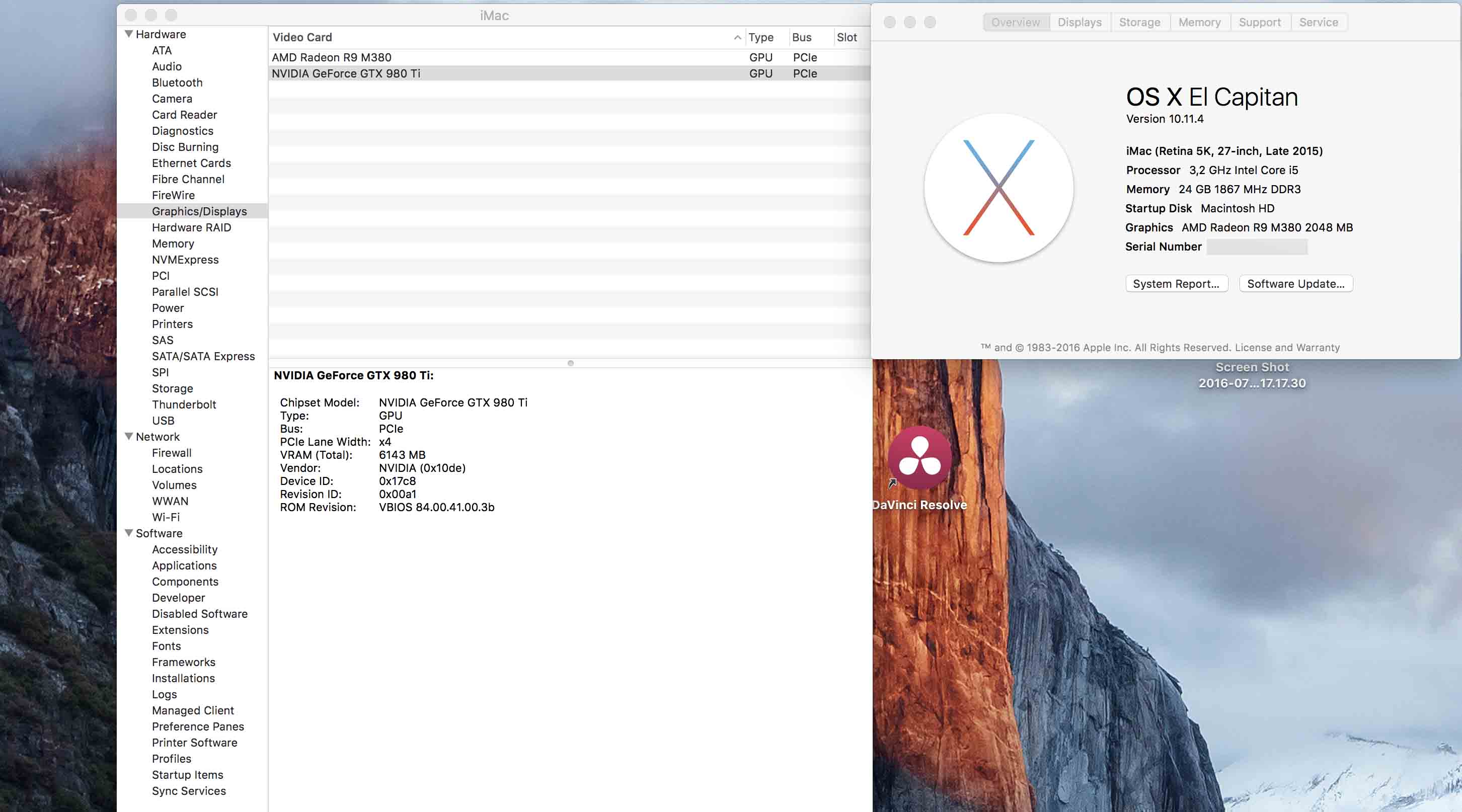

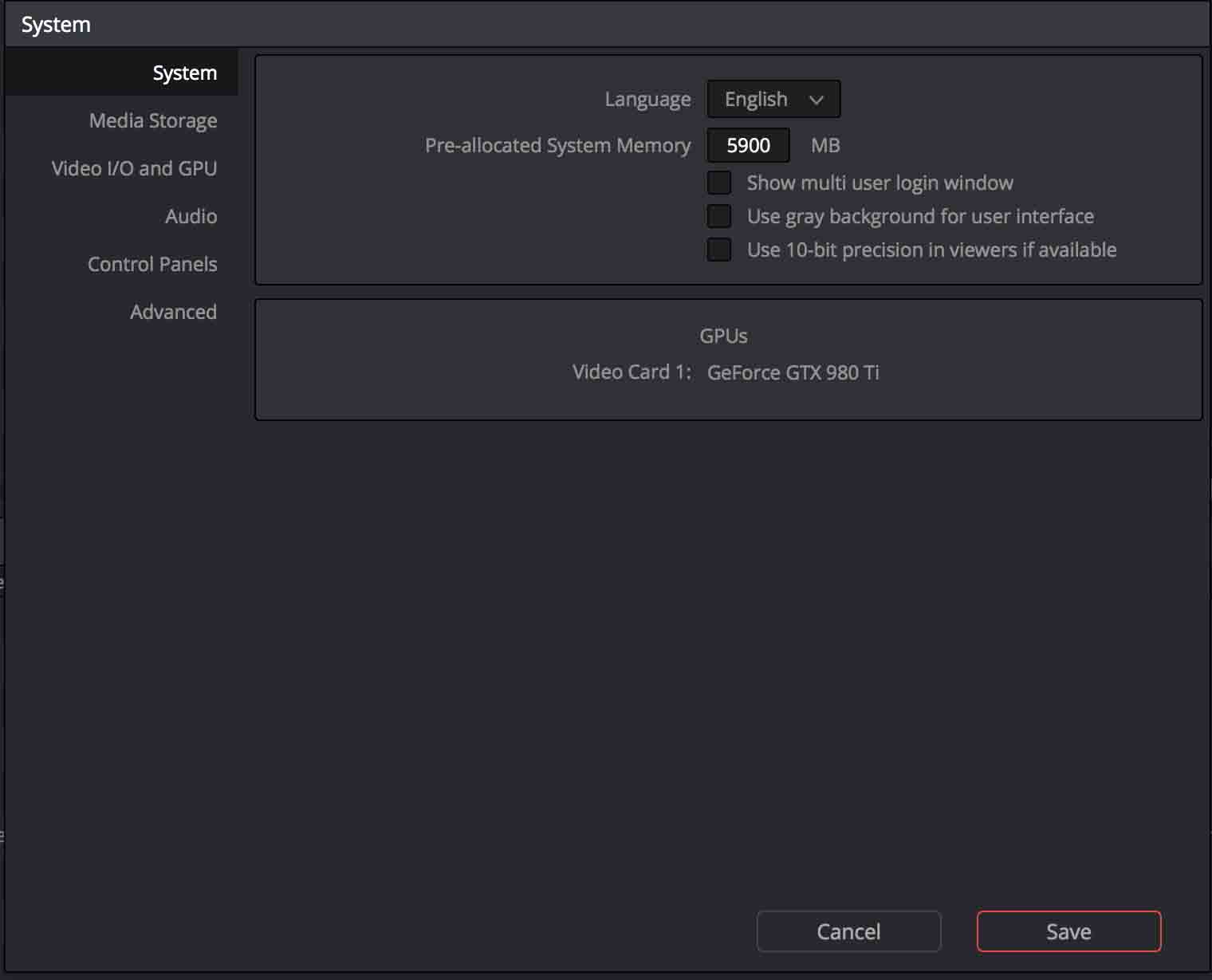

Hi Everyone,
I have followed the tutorials of this forum to build an eGPU for my 2015 late iMac. I wanna use it with Davinci Resolve, for CUDA rendering and NOT for external display.
My config:
5k iMac 27" i5 24GB RAM
Akitio Thunder2
Gigabyte GTX 980 ti 6GB
Zallman 400W PSU
After I installed Goalque's script and fixed the SIP thing, I can see my GTX in the System Report / Graphics part. (at the "About Mac" window it shows only the AMD card under Displays). After any restart my screen comes up cropped to 1/3rd. The sleep trick works, but my display starts to jump around. I cant fix that. The jumping remains, independently from selecting the OS X driver or the Nvidia web driver. DaVinci Resolve starts, but says no CUDA driver installed, and exits.
Is the connecting an external monitor is a must step, or should I be ok without it? Should I download the CUDA driver package too?
Many thanks.
Update: I have found the solution and it works! No sleep and wake, CUDA render is available, no flicker and real 5k resolution on the retina. It was here:
Thanks a lot again for the community to make this possible for us!

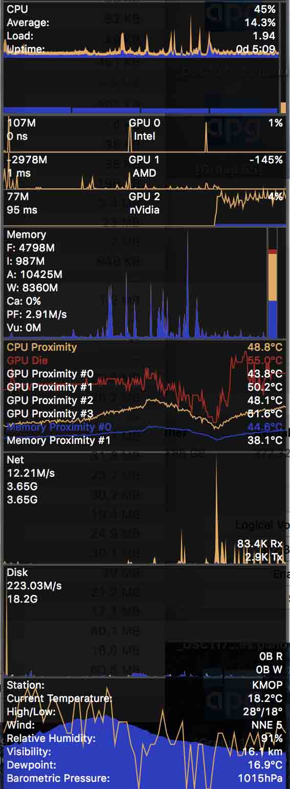

Hi goalque,
I managed to build the eGPU system according to the implementation guide succesfully. My specs:
iMac late 2015 5k, i5 24GB ram (no bootcamp)
Akitio Thunder2
Zallman ZM400LE PSU
Gigabyte GTX980ti 6GB
I do not have an external monitor , I would like to use only the CUDA rendering in DaVinci Resolve. I have applied the quickfix by goalque, not to have an external display. Since then, my 5k works as before. Now my mac shows the GTX980ti under the Graphics pane inside System Report, but not at "About my mac". There is still the built in AMD r380. In Davinci Resolve, the system shows only the GTX980ti, which seems to be victory, but I cannot see the performance gain. It is the same slow 6fps, what I get from my AMD GPU. Although I can hear ticking noise from the card during playbayk or render. This is the same with a Lite version and with the full, Studio version as well (Lite version is using only one gpu). It seems, that nothing utilizes the eGPU.

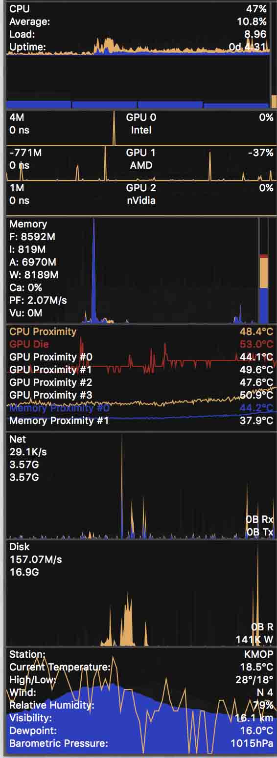

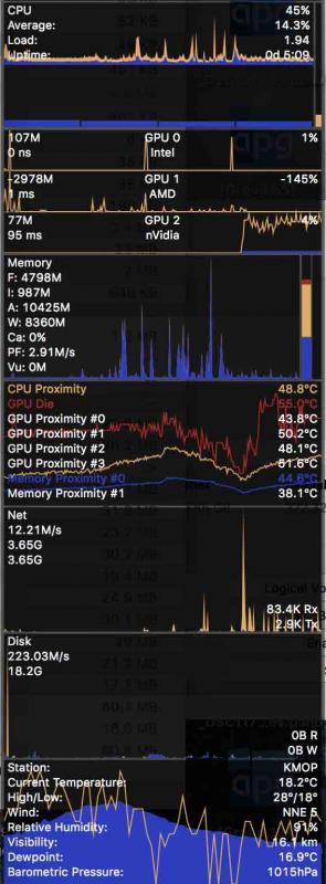

I have downloaded an app, called XRG, saying it is monitoring my all gpus. It does, and what is weird, that during using Resolve, the nvidia gpu is at 0 percent. Same with Adobe Premiere. But if I have a Facetime call or a youtube video, suddenly the nvidia gets active. You can see on the 2nd XRG screenshot, that it had activity for Nvidia gpu. That is a youtube video on my retina display.
Is there any software to monitor the egpu's performance somehow? Did you have experience with XRG?
Thanks a lot.

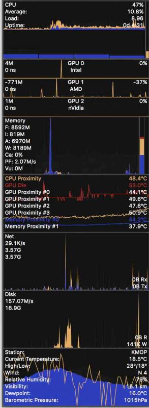

I updated OSX to 11.6 which made me to upgrade nvidia driver as well. This fixed the issue with XRG showing me activity on nvidia gpu during normal os tasks like youtube and facetime.
XRG monitors gpu faulty.
I have installed iStatMenus, which shows you bars for gpu activity without values, and it shows the active gpu. Finally I could see the performance growth, so I made a quick benchmark uninstalling and reinstalling the egpu.

It’s a pity that software developers are not aware of the possibility of external GPUs - iGPU (or AMD dGPU) is often selected as the primary OpenCL device and Nvidia dGPU for CUDA processing because the software is designed for specific hardware. That’s not always the case, for example the new OpenCL rendering core of the Indigo Renderer supports multiple GPUs.
I don’t have experience with XRG. I use an energy meter plugged into a floor power strip. The OS X Terminal is a very useful tool:
ioreg -c nvAccelerator | grep \"PerformanceStatistics\" | sed -E 's/.*\"Device Utilization %\"=([0-9]+).*/\1/'
Thanks a lot. I have run the script during Resolve playback, I got a number: 75. What does this mean? What is this script reading? Sorry for being dumb.
Edited by Phtoon
It shows the current eGPU utilization in percent. In Unigine Valley benchmark it went up to 90-100% (you need an external monitor).

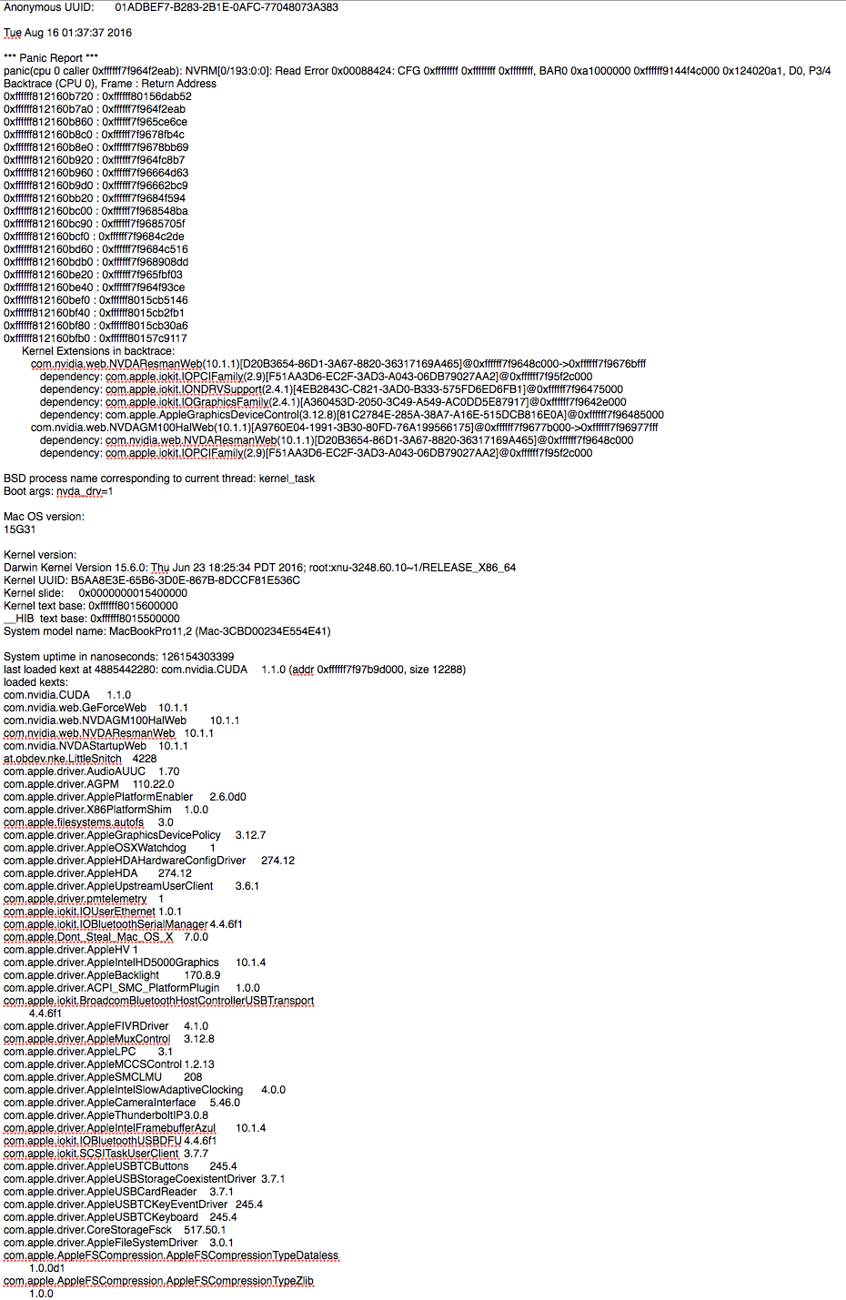

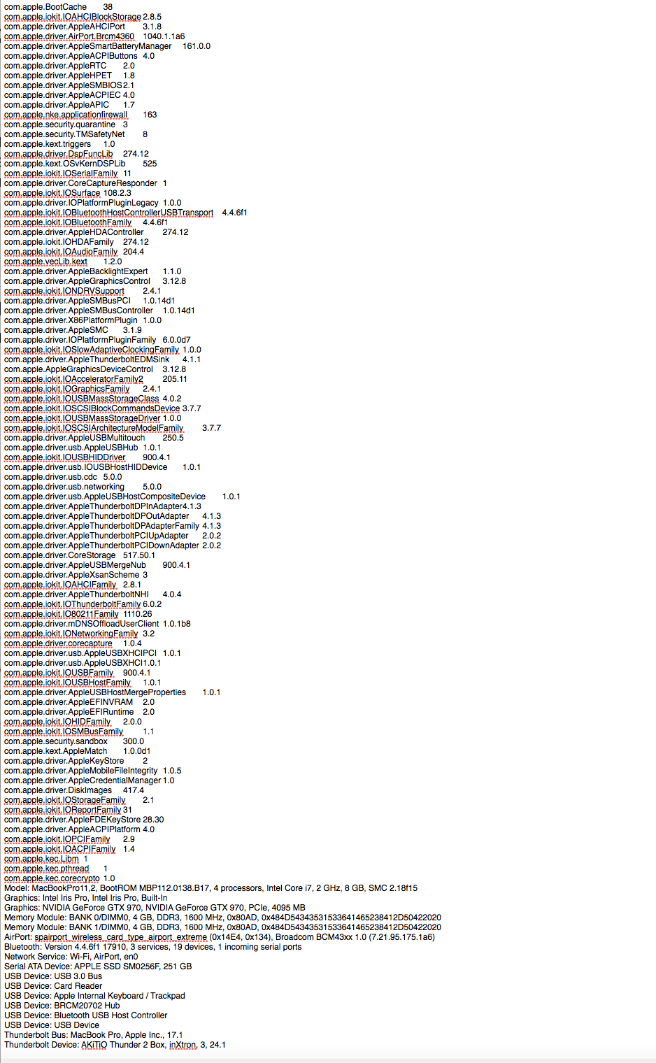

I finally got the script to run successfully, it now says Mac is egpu ready, however Mac only recognizes eGPU as  NVIDIA Chip Model (I'm running a GTX 960) and doesn't show any display other than internal. Also, when I restart the Mac with egpu  plugged in, it crashes and restarts halfway through loading bar. Anyone have any success running an  eGPU on beta? Unfortunately downgrading to el cap is not an option for me.
