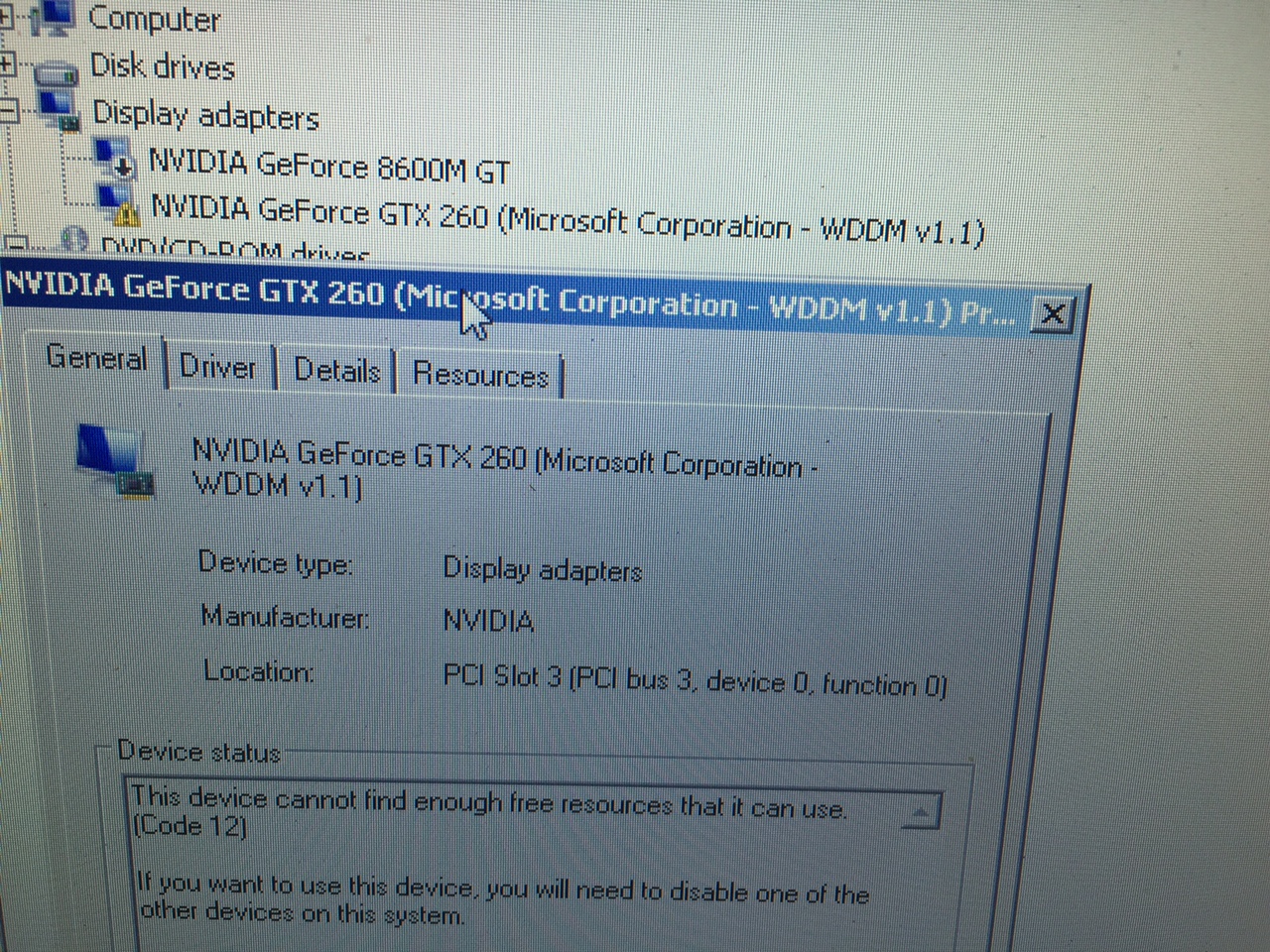

While you may not be able to get the eGPU to work, it should at least appear as a device in device manager. If it doesn't appear in device manager then for whatever reason the eGPU isn't appearing on the PCIe bus. A faulty expresscard slot may be one reason. Worth also hotplugging the powered eGPU to see if you get detection as well as sleep, hotplug eGPU, resume.

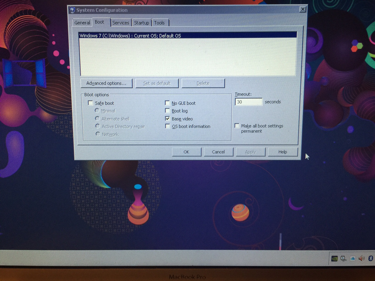

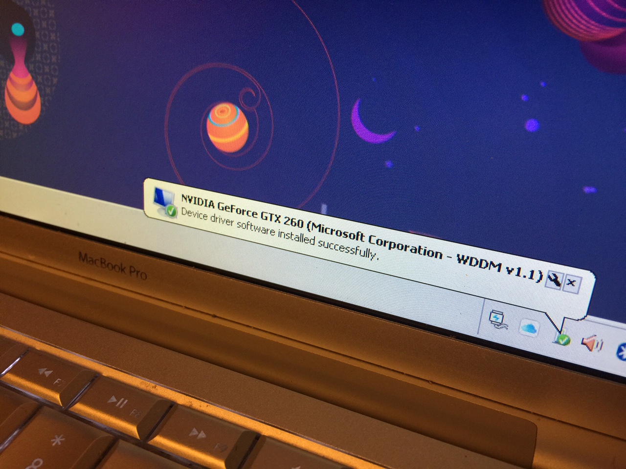

Hey sorry for the late response but life pulled me away from my eGpu project for a while. I hope your still around and willing to help, and sorry if you feel I left you hangin. Last we left off I had gotten the eGpu with the PE4C 1.2 setup to work with a toshiba laptop, but was unable to get anything whatsoever on my 2008 macbook pro. I was able to fiddle with it for a short time tonight and I've got an update:
I've been able to get the macbook pro to detect the card and install the drivers by using msconfig to check the "base video" option under Boot options Tab. Now the sytem detects both my dedicated gpu (8600m GT) AND the eGPU (gtx 260) but under device manager properties it says: "This device cannot find enough free resources that it can use...).
I've included some pics of the progress I've made tonight:

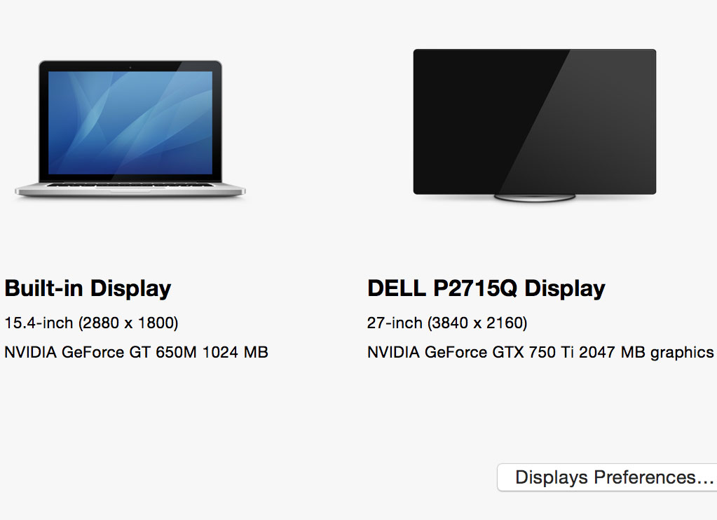

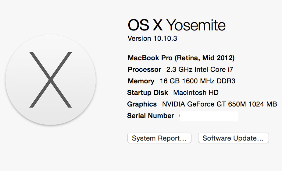

Hi my egpu setup on mac always crash. The "About My Mac" does not shows my GTX750TI on Graphics section unlike many others. Does it matter ? Can anyone please help ?
No idea what you are asking.
Please include details. Are those screen shots yours?
Can't help by guessing
Hi MVC,
Yes, those screen shot are mine.
I have follow the instruction to mod the NVidia Web Driver and changed those kext files. I have my TB1 connected to Akitio with GTX750TI, pcie riser with molex 4 pin from 500w PSU, and output it to Dell 27 4k monitor. The screen did show up, but I will get Kernel Panic randomly (while browsing web or even if I restart my mac). The Kernel Panic reasons are not always the same. One things, I realized that my new GPU never shows in "About My Mac" graphic section (attacted pic), but it did show in the Display section.
Should I uninstall the NVidia driver and redo all over again ?
newon,
Look and see that the 3 kexts you modded all loaded, but also list "loadable - no"
The System profiler means nothing, the fact that it shows up in the 2nd screen is good enough. Make it primary display and maybe that will change, but that isn't the issue causing KPs.
Check the kexts and if they are OK, I imagine it may be your powered riser. I never found them to help, only make things more unstable.
And I imagine that you will have trouble getting 4K output anyhow, as 2012 rMBP on blacklist for 4K via MST.
Might work on SST, I will plug my machine in with 750Ti tonight when done working and see what I get.
