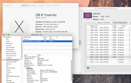

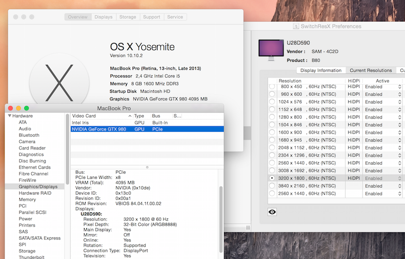

I'm sorry i obviously caused some confusion here:
Concerning the HiDPI mode i just wanted to say that my GTX 970 is able to deliver the full resolution of 3840x2160 pixels that the Dell up2414q has as native resolution but can even put out resolutions as high as 3200x1800 HiDPI, which is equivalent to 6400x3200 pixels.
The Intel Iris however is limited to 3840x2160 pixels, so every "higher" resolution (e.g. 2560x1440) is a non HiDPI resolution resulting in computing less pixels then the native resolution of the up2414q.
The thing is just that i am limited to 30Hz with both GPUs or that my eGPU doesn't put out any video whilst the iGPU can then deliver the 60Hz.
I think your Samsung monitor is indeed a SST model? My Dell is a MST model which makes me dependent of MST support in any driver, no matter if its apple's or Nvidia's.
Also, i already tried all the drivers available from a fresh install of 10.10.1 as well as 10.10.2 ( every OS with their own drivers of course). So i fear i already did everything you advised me to do.
So i think the basic question is:
1. Does Apple somehow block MST support of the nvidia web drivers in some of their kext?
2. Is it a problem limited to the new Maxwell series?
Background:
I was able to swap in an old (borrowed) GTX 260 (PC) inside the box today an everything worked with MVC's hack, meaning i was able to put out video to an old external screen over DVI whilst "AppleGraphicsDevicePolicy.kext" in "AppleGraphicsControl.kext" was modded. But as it is already supported in Appel's own drivers i was not dependent on the web drivers.
Problem is this card could of course not drive the up2414q in any way so i cannot tell if it would have worked?
Sorry for the delay. The problem must be your monitor or DP cable, because I am writing this post now with a Late 2013 13” rMBP and it is able to output 3200x1800@60Hz HiDPI via DisplayPort v1.2 on OS X 10.10.2 (Web driver 343.02.02f01). The funny thing is that the operating system detects two monitors if you are using PIP mode and DP + HDMI from the eGPU, but that’s not very sensible :) Working with a Windows and OS X side by side would be great but the monitor cannot be rotated to vertical position. Unfortunately HDMI 2.0 is not supported and will never be (I asked) because it’s impossible to update the firmware (no USB port as with TVs).
