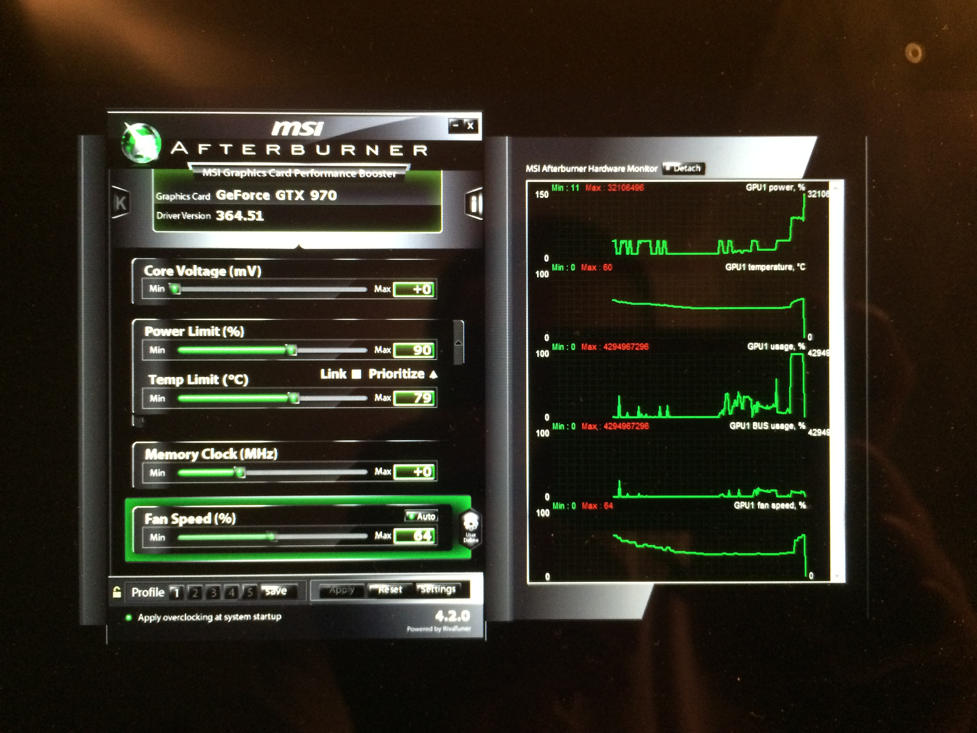

  1. Have checked Afterburner settings and found that all custom voltage settings were disabled by default so ticking appropriate options and changing skin to v3 made a trick and now I can play with power limit, change core voltage, etc! Thanks for tip, @Dschijn! I have lowered Power limit down to 90%, saved profile settings and run the game to see how it works... First run about 20 minutes - everything stable. What was found that actual GPU power usage is a bit higher then Afterburner settings, so sometimes it jumped up to 103%. Then, I've loaded location where I've experienced crash before and after 5 minutes in game e-GPU shutted down once again, same place, same textures... I've managed to capture Afterburner screenshot just after crash occured, looks like a huge jump in power usage! Now I'm wondering is it something wrong with Afterburner or is it more hardware related?...

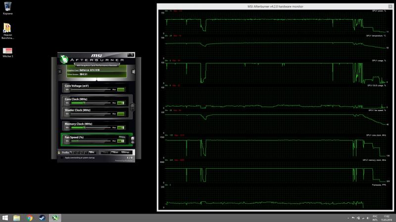

  2. Hi Dschijn, I'm using Zotac GTX 970 . Strange thing! I've just spent another hour in Witcher 3 in same location where I've experienced crashes before and today everything is running smooth. No problems... I was keeping MSI Afterburner and GPU-Z in background and made few screenshots of graphs. The only thing that I've noticed is GPU power usage peak that was 113% at some point. Max GPU temperature 78, suppose that is normal. Also, in GPU-Z prevailing PerfCap Reason during game session was Power restriction. It might be a good idea to lower power limit as you advised above, however not sure if it is a case, since this time game was running stable in same locations without any adjustments... Will keep monitoring graphs and will post e-GPU behaivor in any further crashes. It is also possible to suspect problem with Dell DA-2. Forgot to mention in previous post that I have power switch button installed in Akitio and after e-GPU failed, I was not able to start it by switching power button on and off and had to unplug DA-2 adaptor from socket in order to get yellow/green light indication back. Hi davidexD, Thanks for reply, I've expereinced same crashes both with 361.75 and 364.51 drivers (updated yesterday), not an expert but seems like drivers are not an issue.
