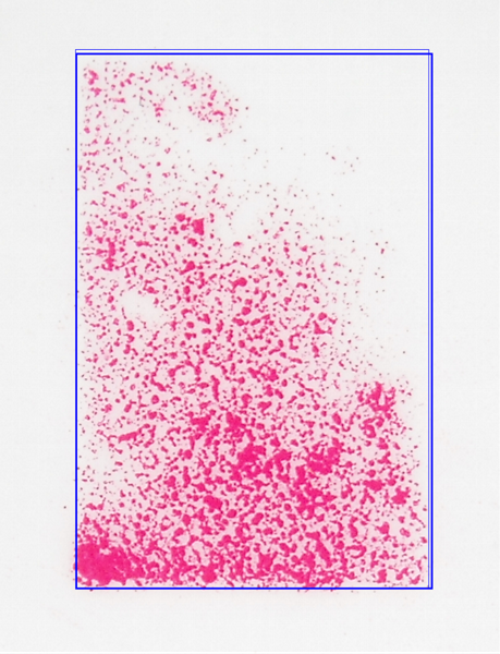

I am doing a reliability study and looking for people to do a simple Contact & Pressure (C/P) test to link to their recorded temperatures - two pieces of plastic paper mount sink as you would normally would release and remove throw away blank then mail back self addressed envelope for lab analysis. Lots of good info % contact area, psi are key and can be linked to long term reliability as quoted below. Laptops are about the toughest thermal environment out there and this would be useful data to have
N
o IHS on this one, so direct contact area is smaller so the watt density is higher.
Kind of like here
http://forums.overclockers.co.uk/sho...&postcount=285
The compound had an early failure
The C/P image above is from a laptop, our first to date. We are in the early stages of gathering long term data on the laptops and you have real diverse mix of temperature experiences some of the compounds tested here only last from a few weeks to a year. IC Diamond seems OK at a year to about a year and half give or take with only one at 2 years contrasted with a guy over at Anandtech who is 4 years on ICD on a PC.
The increased watt density is a killer and I suspect the 20% early failures are low C/P in numbers something like the Pareto principle aka the 80-20 rule
I was taking a look at some published information on laptop reliability linked below and a rough analysis might be with their 30% failure rate in 3years approx 1/3 of that due to breakage and about 2/3 or 20% of all laptops is a component failure probably due in large part to high thermal loads - Heat is number one enemy of electronics.
After a re-paste on a PC in the overclockers forums you have an average of 61C after a repaste and the laptops so far average 71 C after a re-paste. I think the extra 10C is the dividing line, in the PC market you may see a few degrees decline and here and there you get the rare 15 -20 C degree improvement but generally most of those are mount related issues unless the compound has been installed a couple of years or more.
The PC failures were generally less than half laptops. The prevalence of early temperature creep in laptops is quite surprising along with the relatively large number of 85 - 90 C systems reported---- 25 to 30 C higher than the PC's, if you have a weak component those kinds of temps have a good chance of killing it. As a kind of general recommendation to avoid being the 1 in 5 failures and as a good maintenance procedure has been suggested here blowing the dust out regularly, I would add a secondary laptop cooler as well as changing the compound every-time it creeps up 10 C past the initial install temps. The cooler it is and the longer time periods it remains cool, the odds that longer system life increases.

Lots of good info obtained. Raw images reveal much as well as pictures of paste impressions
I cannot find the exact full die size but then have not looked too hard yet but initially pressure is very good as I suspected it would be and contact appears to be around 50% - 60%, 9/10 th's of a centimeter
So basically you have half the area for dissipating 35W - +2X the thermal stress on a compound in an environment that is already warmer than most to begin with, little wonder why people are experiencing accelerated compound degradation.
I currently have 3 people on tap for C/P testing it would be nice to get a broader profile of 20 to 30 and to see how things trend.

Great I will put together some test kits the weekend and send out Monday, you are pretty close to us so you will probably get it Tues. or Wed.
Stock pressure is pretty good from first sample and would be interesting to see if you are off the scale for this paper with the mod.
