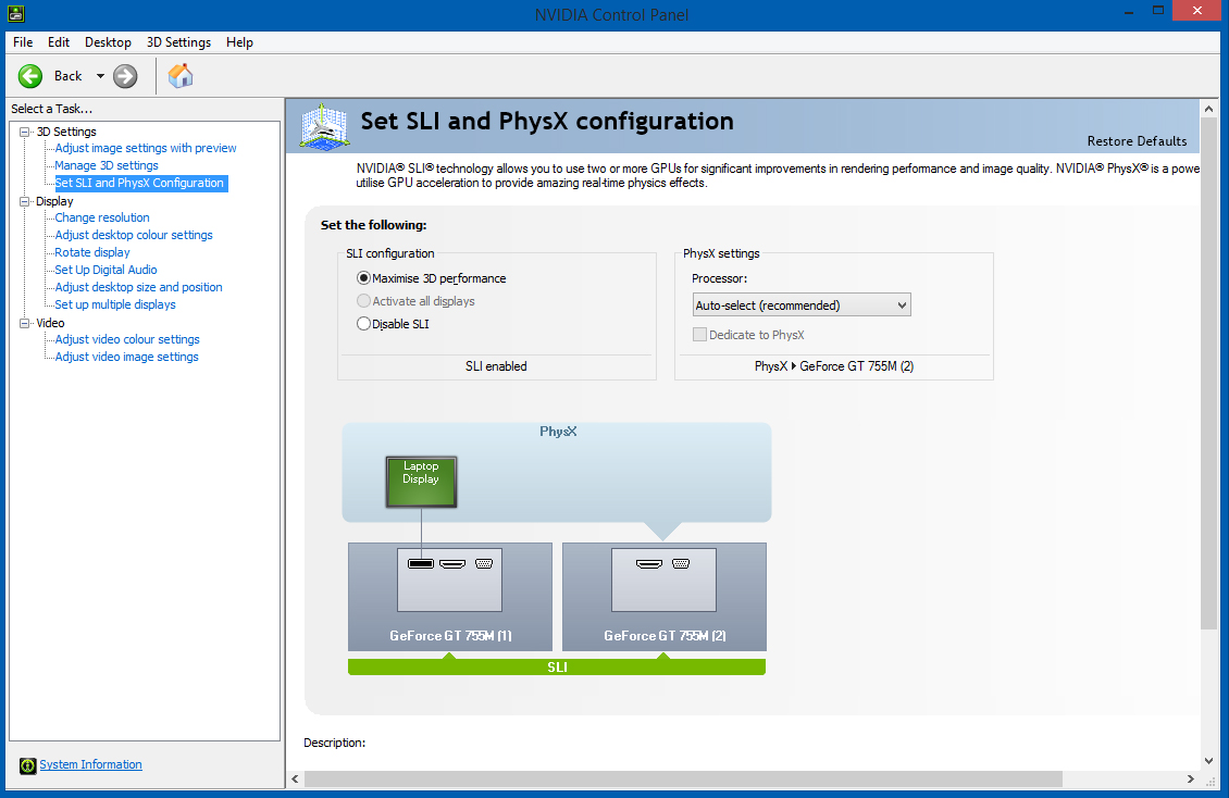

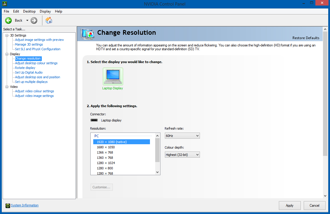

Can't overclock my LCD anymore on the Windows 10 Technical Preview (9879 Build)...Was able to overclock my matte Display to 83Hz or 80Hz on Windows 8.1 and I used "back then" the Nvidia Driver 344.11 for Windows 8.1 64Bit version...I "updated" my OS to the Technical Preview also 64Bit and used the same Driver(and I reinstalled it) yet when I try to overclock it to 83Hz, 80Hz or even anything above 60Hz my screen goes black and I have to restart.
I am currently using the 344.75 Driver (64bit) with a clean installation and still cant overclock it anymore.
I have the y510p matte display with 750m sli and the Windows Technical Preview 9879 also I use the 344.75 Game Ready Driver for Win 8,1 64bit...any help, any Ideas?
P.s.:I have no other issues...my Overclock on the sli gpus runs just perfect and I saw oddly enough a increase of fps and in benchmarking :)

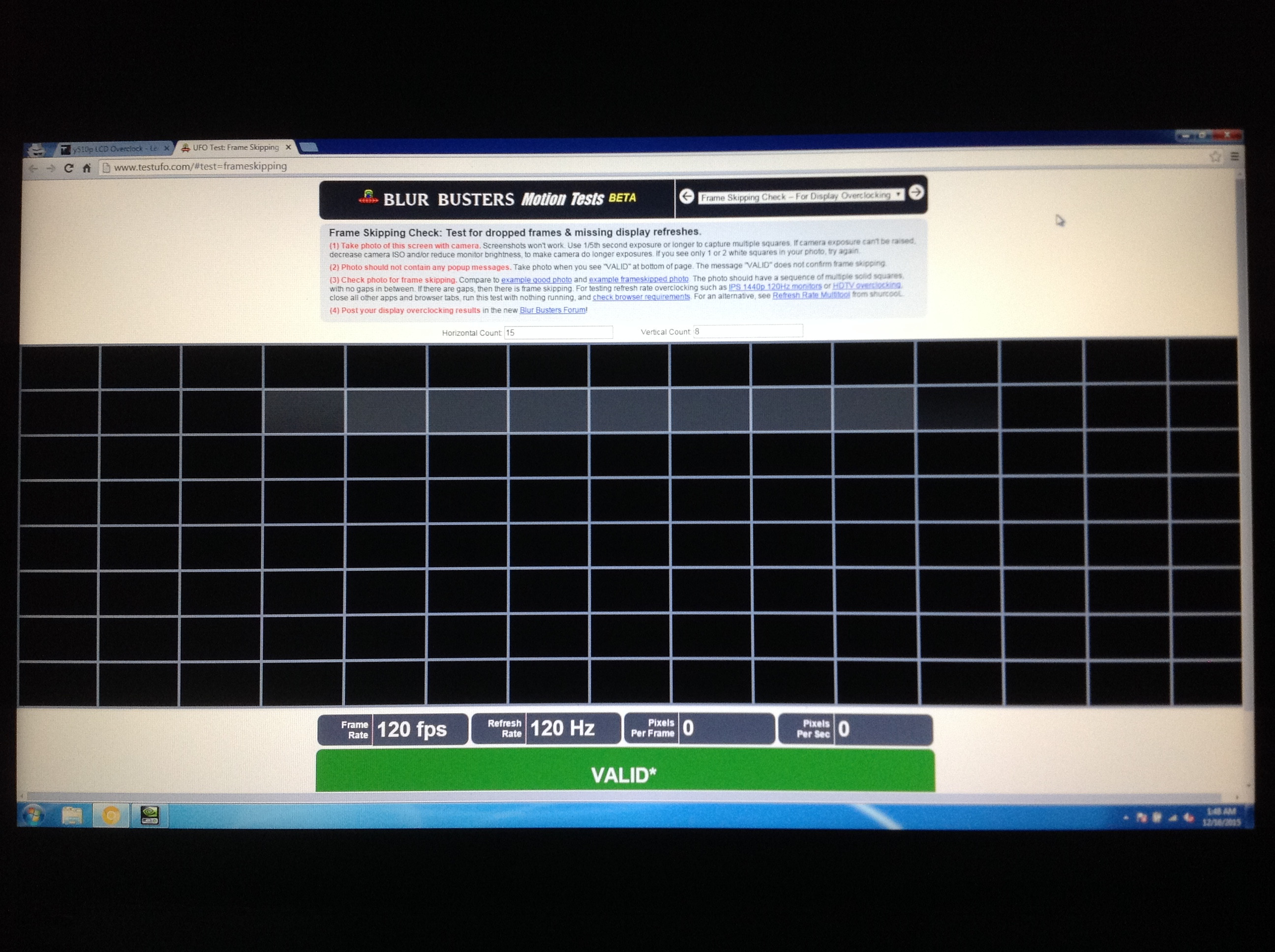

I've got the Y500 and it tops out at 112hz for me, personally. It's good enough for me, but I can do 120fps with pixel artifacts - not worth it, and also a bit unstable. Not sure which version of the screen I've got, sorry.

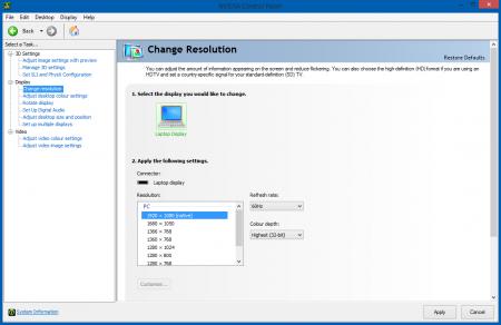

Well I decide to try and overclock my y510p which came with LG mate FHD LCD and used the CRU utility without any success :( None of my custom resolutions show up in advanced settings, just the default 60Hz. I tried everything i could think of, even running it as admin, and nothing succeeded. Any ideas what needs to be done to make this work? I'm on Windows 8.1 Pro.

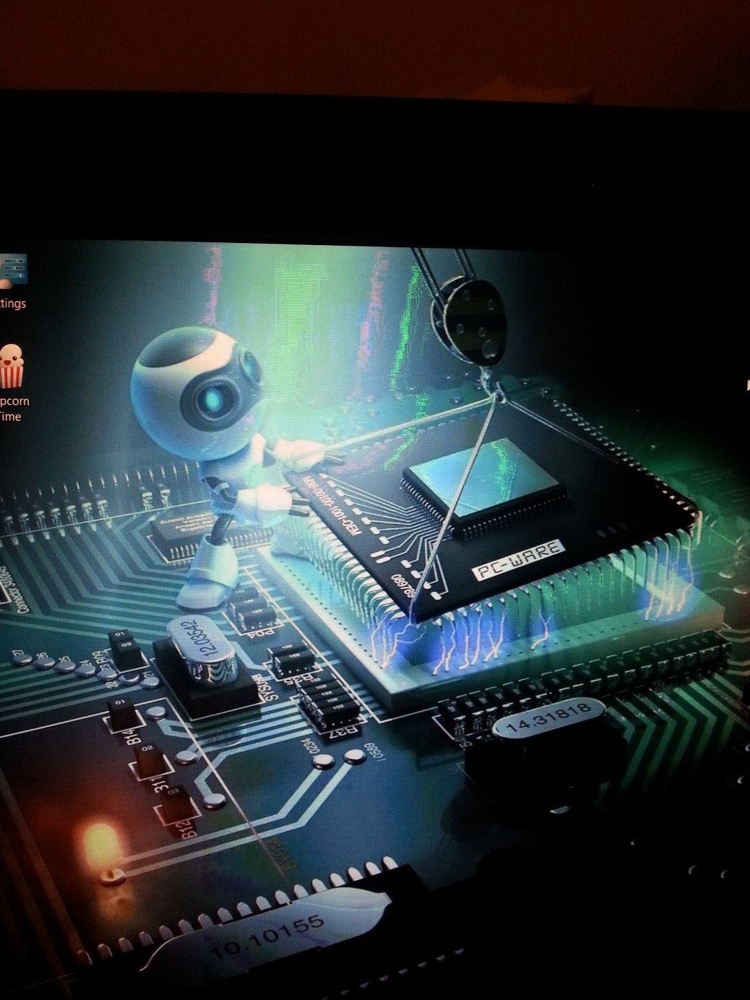

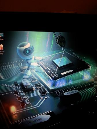

I have the TLB2 matte monitor and I can hit 84Hz. But anything over 60Hz gives me red and green flashing pixels at random areas on the screen. Anyone know what's going on with this? Apart from the flashing pixels everything else is stable. This is what it looks like.. post-36843-14495000462567_thumb.jpg
Edit: ends up the display connector wasn't connecting fully. I just taped a bit of folded paper to hold it in place.

Most likely matte since 80Hz seems to be the common limit for that panel and 100Hz for glossy. But YMMV as with any kind of OC. I was lucky to have a panel that can do 120Hz (see above).
I haven't heard of any horror stories resulting from LCD overclocking.
