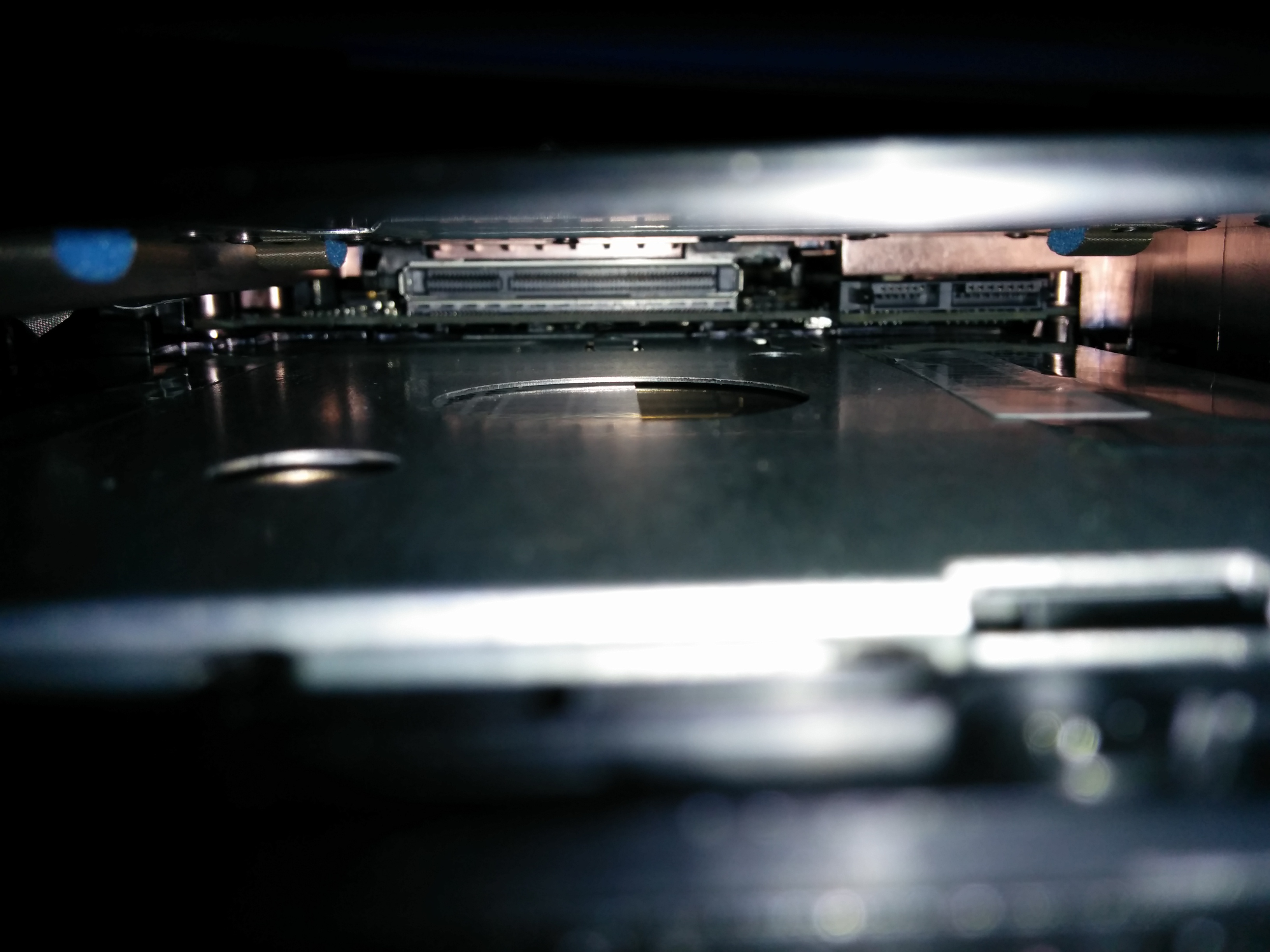

busterbytes Posted February 13, 2014 Share Posted February 13, 2014 I purchased teh IdeaPad Y510p Laptop - 59401512 - Dusk Black version I will attach some pictures of the interior layout. I can see where you could replace the optical drive with another hdd. Is that where the SSD will go as well? Will I have to replace the optical? Quote Link to comment Share on other sites More sharing options...

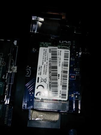

nono Posted February 15, 2014 Share Posted February 15, 2014 I just bought a y510p from the Lenovo Outlet and it came with a 24gb SSD in the m.2 slot. Quote Link to comment Share on other sites More sharing options...
