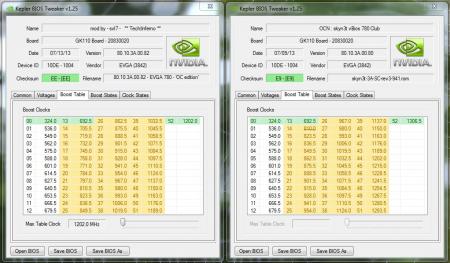

Dicehunter 15 Posted September 30, 2013 According to a gent on another forum I frequent he has this information about Skyn3ts VBios I have just inspected both BIOS's and they are different. Completely different in fact.SVL7 uses 80.10.3A.00.82 and Skyn3t uses 80.10.3A.00.80All the boost tables are different and the common settings also differ. Different checksum as well. Quote Share this post Link to post Share on other sites
Brian 1980 Posted September 30, 2013 According to a gent on another forum I frequent he has this information about Skyn3ts VBios Not sure what to make of this whole debacle :-/Having a different vbios version and checksum doesn't mean anything.Sent from my GT-N7000 Quote Share this post Link to post Share on other sites
Gregster 10 Posted September 30, 2013 Not sure what you are saying Brian but after comparing these BIOS's (one is SVL's and the other is Skynet's), I can't see how you can say that Skyn3t ripped off SVL's work and is taking credit for it. They are completely different and unless you have proof, you should wind your neck in. We need guys like Skyn3t/SVL/Naennon etc and those kind of comments are unfounded. Quote Share this post Link to post Share on other sites
