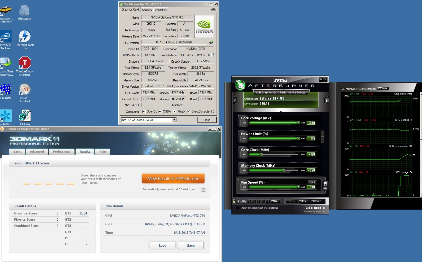

[settings]
VDDC_Generic_Detection = 0
VDDC_NCP4206_Detection = 3:20h
This works for my Titan.
Can set 1300 mv in Afterburner. OSD shows me varying values between 1.25V-1.26V.

[settings]
Almost reached the Powertarget of the svl7 Bios with Unigine Valley and 1306 Mhz.

I haven't checked it on my card, but I'm under the impression that the vid7 is directly wired to ground and vid6 is pulled to high, resulting in a max voltage of 1.2125V that can be set by the vids. Therefore I doubt that anything is possible per vbios, I tried quite some things. The voltage control is purely per vids it seems, which makes sense because it's much easier to use a similar vbios base code for pretty much all kind of VRs.
If you set the voltage higher with the MSI AB method (got it to work btw, was user error, lol) then it disables VID control and sets the voltage regulator to I2C control only, meaning the voltage will be fix until the chip gets the next command.
Also I'm not sure how it looks with the current limit, but it's possible that it may already have an effect at 1.3V, I kinda doubt that MSI AB makes any change there, even if it seems that the VR allows adjusting the hardware set current limit it within a certain range per software.
So, as I said, there's pretty much no chance to get this to work per vbios (unfortunately) but there are some other interesting possibilities here... I'll have too look into this when I find some time, way too busy at the moment. On the other hand, a higher current limit and voltages beyond 1.3V are probably not very healthy for the power supply circuits of the Titan or any current GK110 (and also GK104) reference board.
