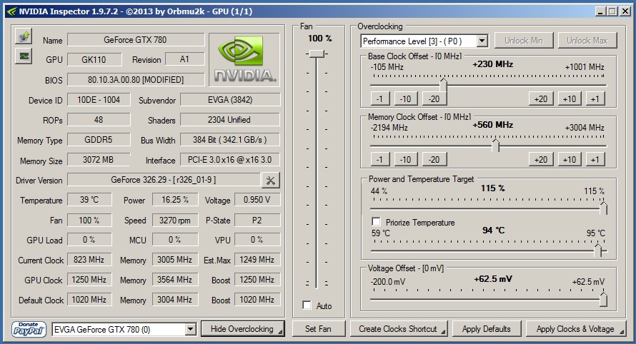

  19. If you are talking about ACX BIOS just force flash with -4-5-6 .36 one , after that you shouldn't have any problem to update 37 from EVGA executable file Somebody tried ASUS DC2 BIOS on a reference card till now ?

  21. Hi, I flashed it just to test ref.card and there's no change compared to EVGA 780 - SC ACX - 80.10.37.00.0B - 'OC edition v00'.zip 40% fan = 1300-1333 RPM 100% fan = 3250-3300 RPM
