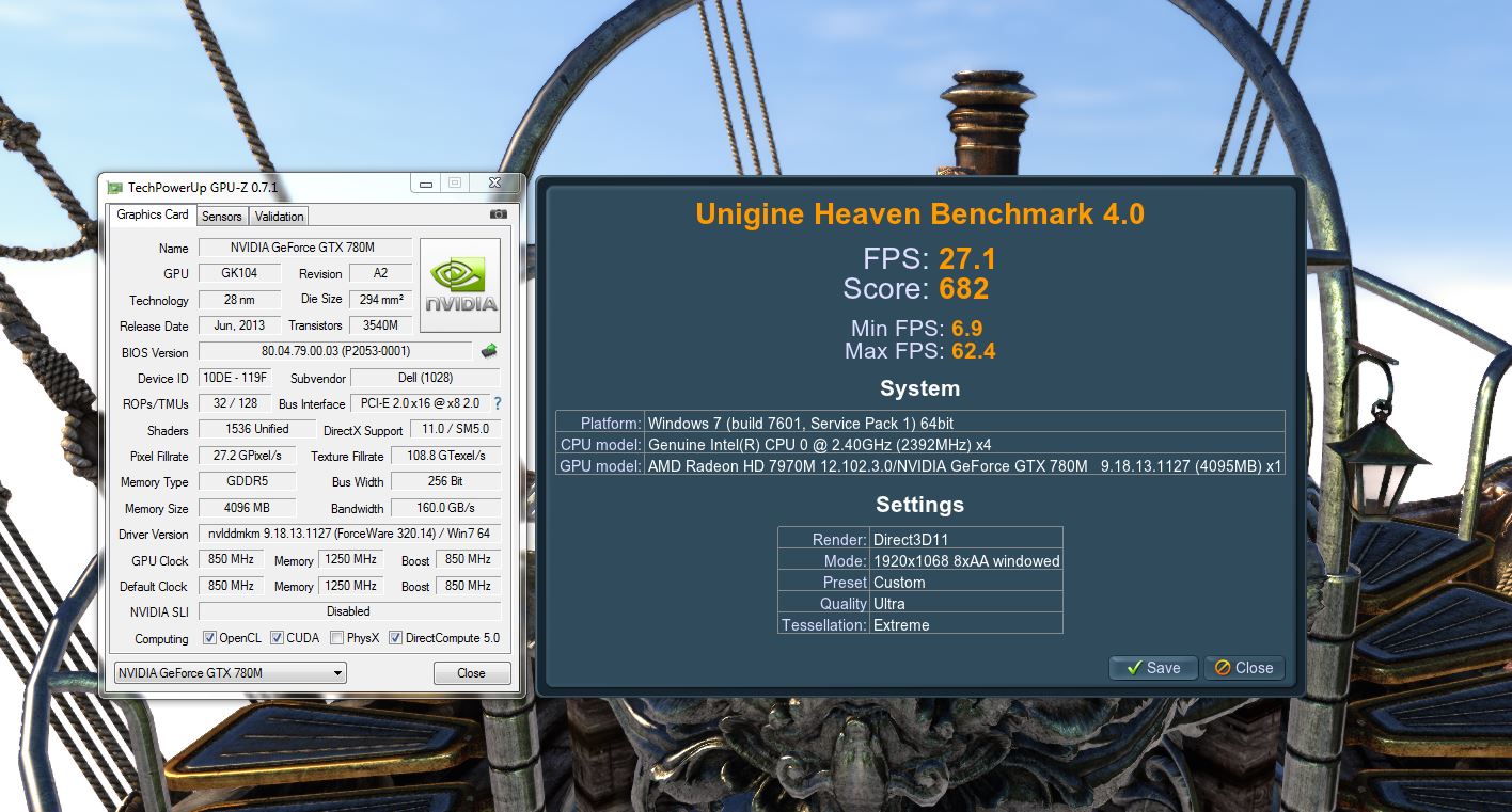

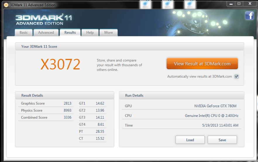

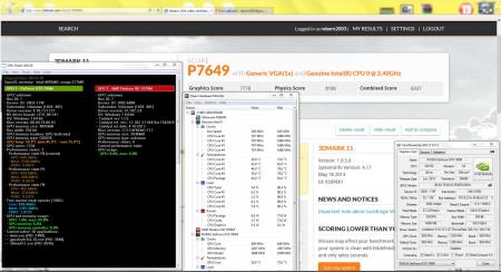

Alienware M18x R1 running a Nvidia GTX 780M - Let the testing begin

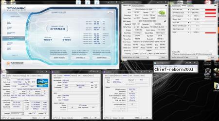

:Banane53::Banane53:A special thanks to Prema and Svl7 for their tweaking expertise. Stay tuned for more tests. :Banane21:
Core Clock set to 850Mhz and MEM set to 1250Mhz
http://www.3dmark.com/3dm11/6590300
Core Clock set to 1000Mhz and MEM set to 1450Mhz
Generic VGA video card benchmark result - Genuine Intel® CPU 0 @ 2.40GHz,Alienware M18xR1 score: P8539 3DMarks
http://www.3dmark.com/3dm/664875?
http://www.3dmark.com/3dm/664914?
3D MARK 11 Special!
http://www.3dmark.com/3dm11/6592798
http://www.3dmark.com/3dm11/6592828
http://www.3dmark.com/3dm11/6592848

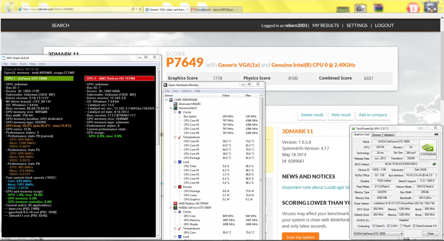

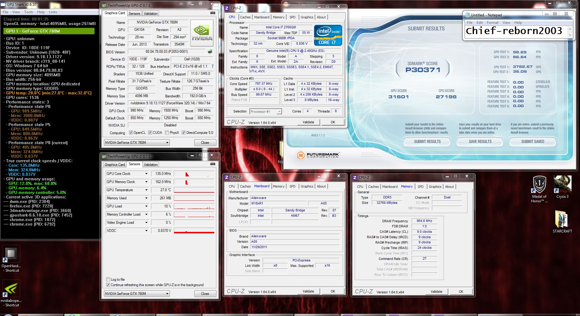

Overclocked runs:
Core Clock set to 980Mhz and MEM set to 1450Mhz
http://www.3dmark.com/3dm11/6592889
http://www.3dmark.com/3dm11/6592908
Core Clock set to 980Mhz and MEM set to 1500Mhz
http://www.3dmark.com/3dm11/6592927
Core Clock set to 1000Mhz and MEM set to 1550Mhz
http://www.3dmark.com/3dm11/6593108

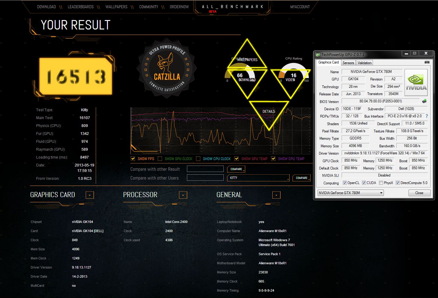

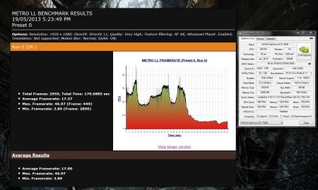

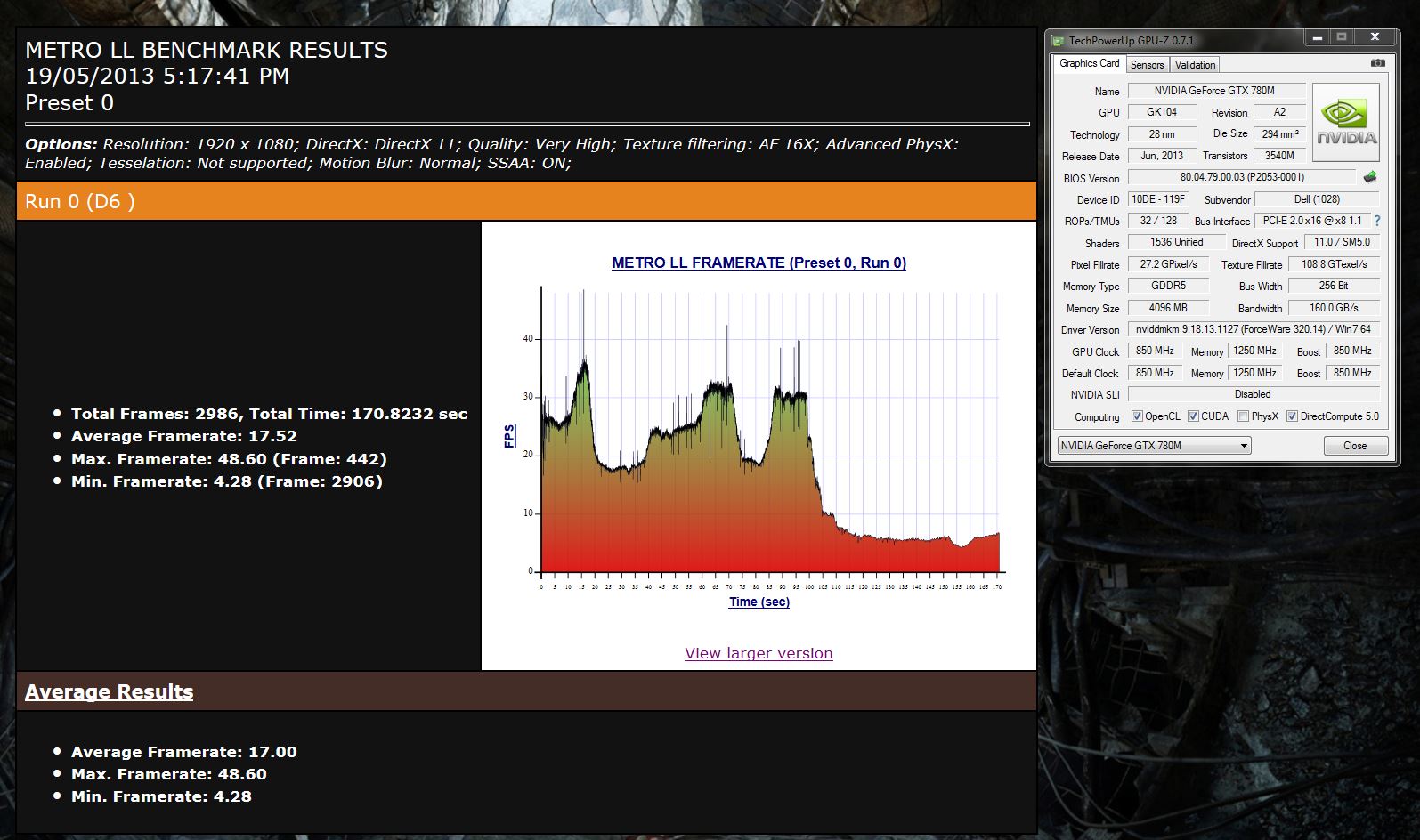

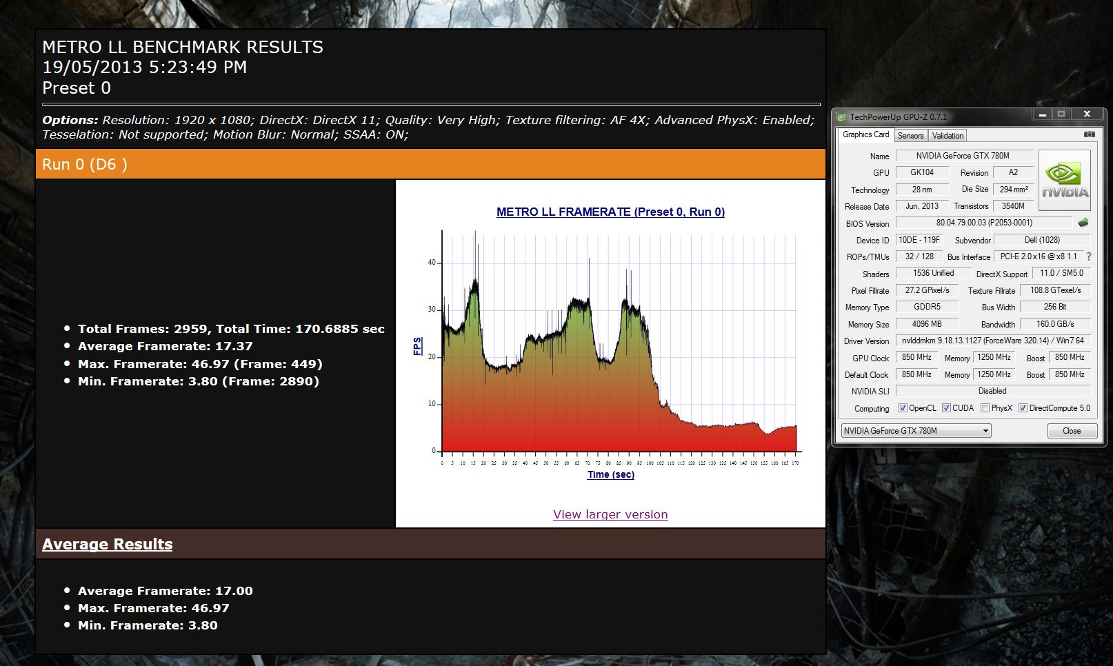

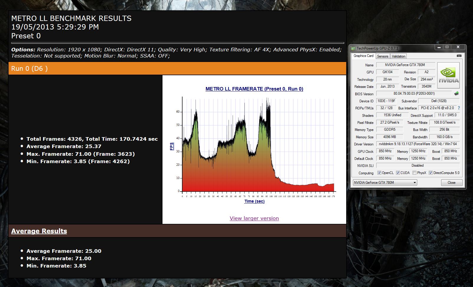

Metro Last Light benchmark - Multiple settings.
YOUR RESULT
Test Type: Kitty
Main Test: 16107
Physics (CPU): 809
Fur (GPU): 1342
Fluid (GPU): 974
Raymarch (GPU): 589
Loading time (ms): 8497
Date: 2013-05-19 17:59:15
From Version: 1.0 RC3
GPU Rating
66
0
100
CPU Rating
33
0
100
SHOW FPS
SHOW GPU CLOCK
SHOW CPU CLOCK
SHOW GPU TEMP
SHOW CPU TEMP
Compare with other ResultCompare with other UsersKITTY
GRAPHICS CARD
Chipset nVIDIA GK104
Card nVIDIA GK104 [DELL]
Clock 849
Mem Size 4096
Mem Clock 1249
Driver Version 9.18.13.1127
Driver Date 14-2-2013
MultiCard no
PROCESSOR
Name Intel Core-2400
Clock 2400
Clock used 4386
GENERAL
Laptop/Notebook yes
Computer Name Alienware M18xR1
Operating System Microsoft Windows 7 Ultimate (x64) Build 7601
OS Service Pack Service Pack 1
Motherboard Model Alienware M18xR1
Memory Size 23030
Memory Clock 665
Memory Timing 9.0-9-9-24
Memory Type
Memory Manufacturer
Desktop Resolution 1920x1080
Disc Model OCZ-VERTEX4
Disc Capacity[GB] 256
Disc Rotation Non-Rotating (SSD)
Disc Cache[MB] 32
SHOW LOG
2013-05-19
Log created: __05_19_2013__17_55_27
USED GFX: GeForce GTX 780M/PCIe/SSE2
OpenGL version: 4.2
OpenGL mem info: dedicated video mem: 4095 [MB], total available mem: 4095 [MB]
ADAPTER INFO:
Description: NVIDIA GeForce GTX 780M
VendorId: 0x10de
DeviceId: 0x119f
SubSysId: 0x48f1028
Revision: 161
DedicatedVideoMemory: 4036 [MB]
DedicatedSystemMemory: 0 [MB]
SharedSystemMemory: 11258 [MB]
USED GFX: NVIDIA GeForce GTX 780M
SLI Num AFR Groups: 1
GPUInfo
OpenGL Supported: 1 (custom, 1)
DirectX Supported: 1 (custom, 1)
OpenGL Used GPU: GeForce GTX 780M/PCIe/SSE2 (custom, 1)
DX Used GPU: NVIDIA GeForce GTX 780M (custom, 1)
SLI/Crossfire Enabled: 0 (custom, 1)
NumAFRGroups: 1 (custom, 1)
MsaaModes
Msaa: 8 (custom, 1)
Msaa: 4 (custom, 1)
Msaa: 2 (custom, 1)
Msaa: 1 (custom, 1)
APP PARAMS:
arch: x64
api: directx11
resolution: 576p
exit: true
loop: false
vsync: false
music: true
msaa: 1
ssao: 0
postprocess: 0
shadowMapQuality 2
mtbuild 1
mtdraw 0
fullscreen -1
secDisp -1
nmips -1
Tests:
miastoPico
miastoPico_physicsTest
miastoPico_furTest
miastoPico_fluidTest
miastoPico_raymarchTest
Sensor info
Cpu #0 name: Intel Core-2400
Gpu #0 name: nVIDIA GK104
Gpu #1 name: ATI/AMD Radeon HD 7970M (WIMBLEDON XT)
12 sensors detected!
SensorName #0: System
SensorName #1: CPU [#0]: Intel Core-2400
Cpu Clock: Core #0 Clock
Cpu Clock: Core #1 Clock
Cpu Clock: Core #2 Clock
Cpu Clock: Core #3 Clock
SensorName #2: CPU [#0]: Intel Core-2400: DTS
Cpu Temperature: Core #0
Cpu Temperature: Core #1
Cpu Temperature: Core #2
Cpu Temperature: Core #3
SensorName #3: CPU [#0]: Intel Core-2400
Cpu Clock: ICC DIV1-S: Display
Cpu Clock: ICC DIV2-S: BCLK/DMI/PEG
Cpu Clock: ICC DIV3: PCIe/PCI33/SATA/USB3
Cpu Clock: ICC DIV4: Display Bending
Cpu Clock: ICC DIV1-NS: Display
Cpu Clock: ICC DIV2-NS: BCLK/DMI/PEG
SensorName #4: COMPAL EC
SensorName #5: Intel PCH
SensorName #6: S.M.A.R.T.
SensorName #7: S.M.A.R.T.
SensorName #8: GPU [#1]: ATI/AMD Radeon HD 7970M (WIMBLEDON XT): ATI Internal
GPU Temperature: GPU Thermal Diode
SensorName #9: GPU [#0]: nVIDIA GK104: nVidia Internal
GPU Temperature: GPU Temperature
SensorName #10: GPU [#0]: nVIDIA GK104: NVAPI
SensorName #11: Battery
Sensor info finished
ADAPTER INFO:
VendorId: 0x10de
DeviceId: 0x119f
SubSysId: 0x48f1028
Revision: 161
SLI/CrossFire: off
SLI/CrossFire nb AFR groups: 1
Default resolution is 1080p
Loading time: 8 (8497 [ms])
YOUR SCORE IS:
demo: 16107
physics: 809
fur: 1342
fluid: 974
raymarch: 589
APPLICATION TERMINATED SUCCESSFULLY
Cheers. :)

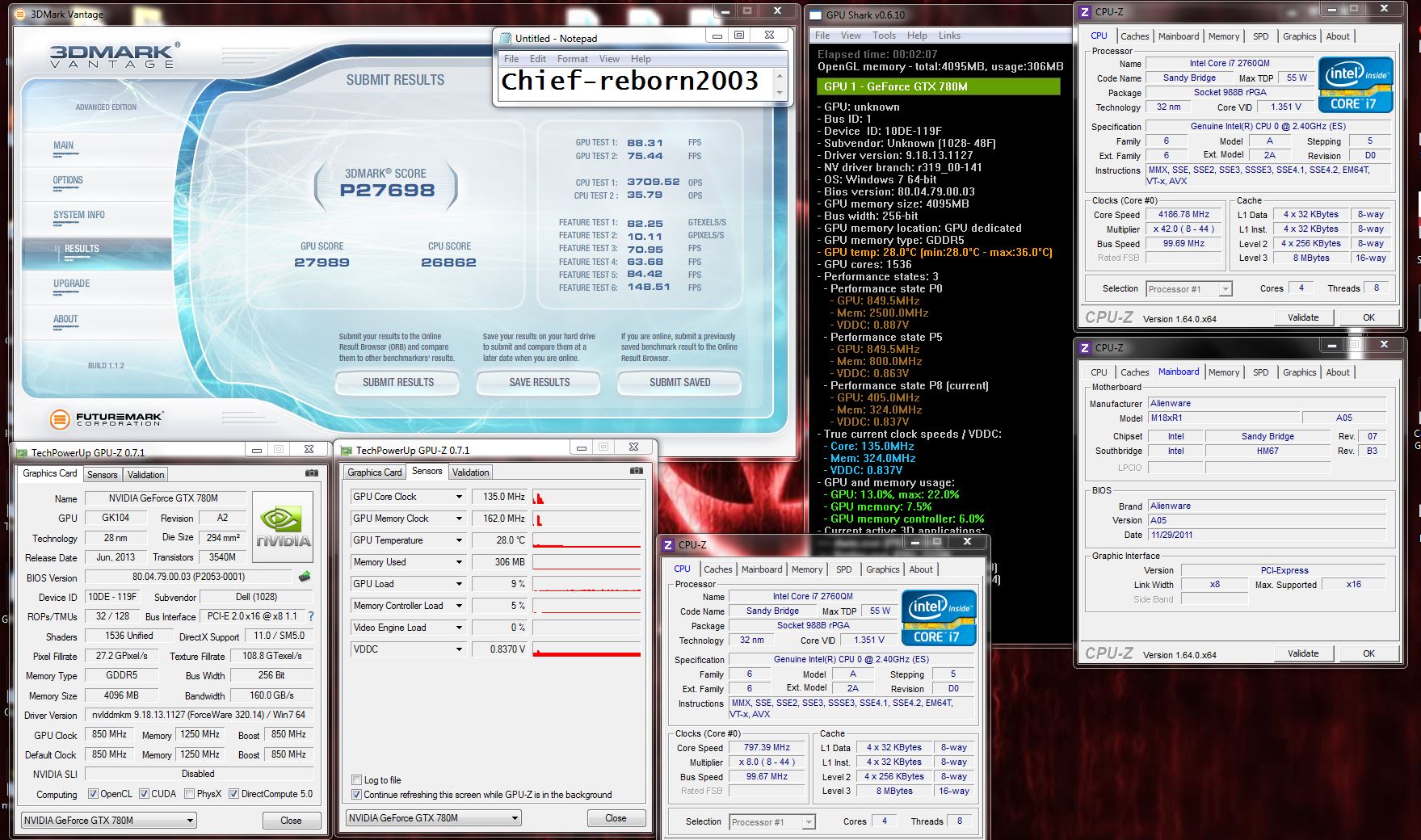

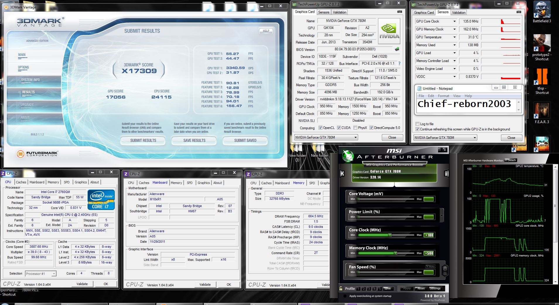

This is my best vantage: http://www.3dmark.com/3dmv/4682745
3dm11 won't complete due to PSU shutdowns on the combined test with the memory overvolt despite a 330W psu. Working on a way to get the laptop to stop telling the PSU to turn off.
My memory could only do low 4600s with no modification.

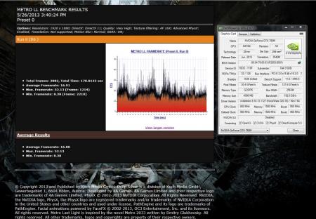

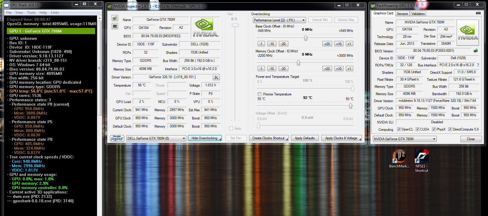

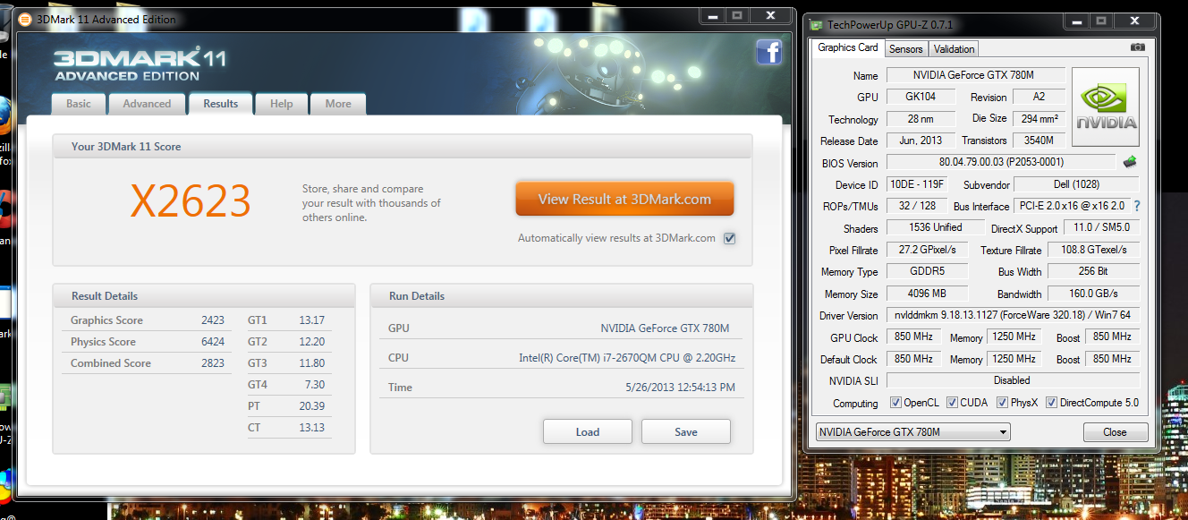

Haven't been here for a while! Unfortunately it looks like the 780m suffers from the same issue that the 680m did with anything but the MSI pre-release rom. I'm satisfied with my modded 4GB GTX 680m @915(980)/1125. But will definitely trade up once the issue gets resolved.
I will give you some proper numbers this weekend, regarding power consumption @ stock and possibly overclocked (if someone is kind enough to send me some tweaked vbios :P - I'm not naming anyone!)
So far it runs cool enough: 3dmark11stock.png
but still requires some better driver support I believe!

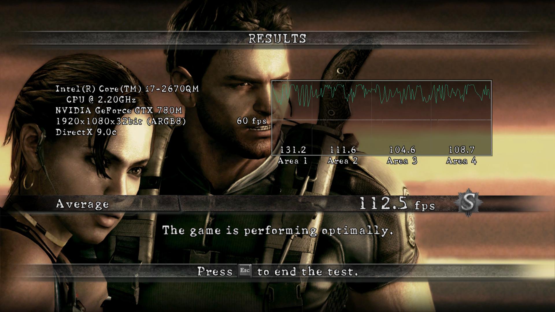

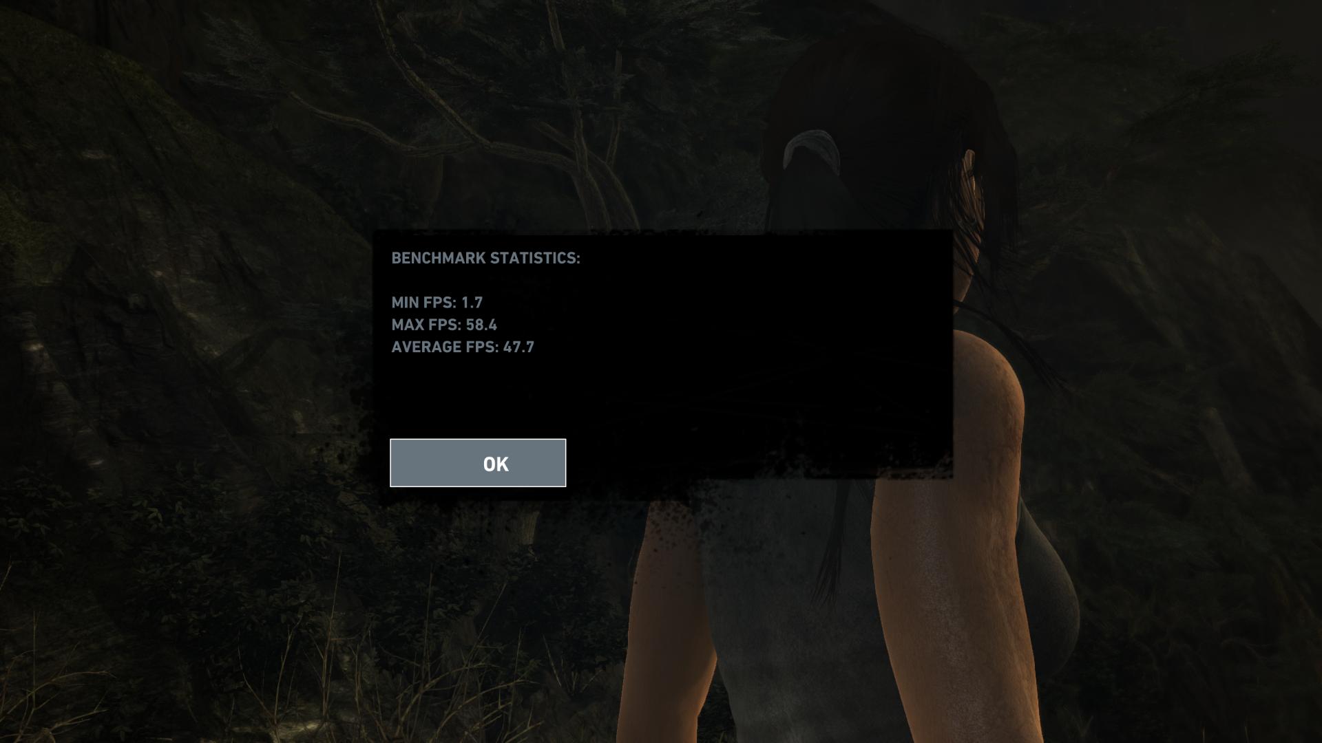

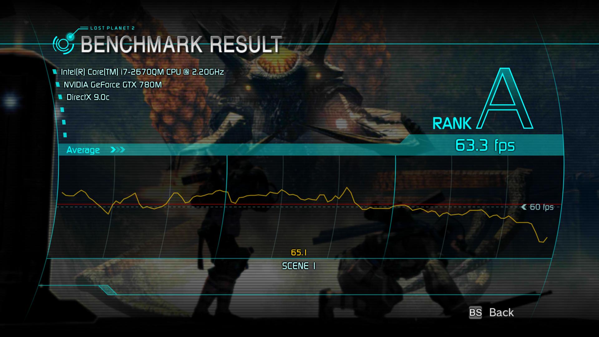

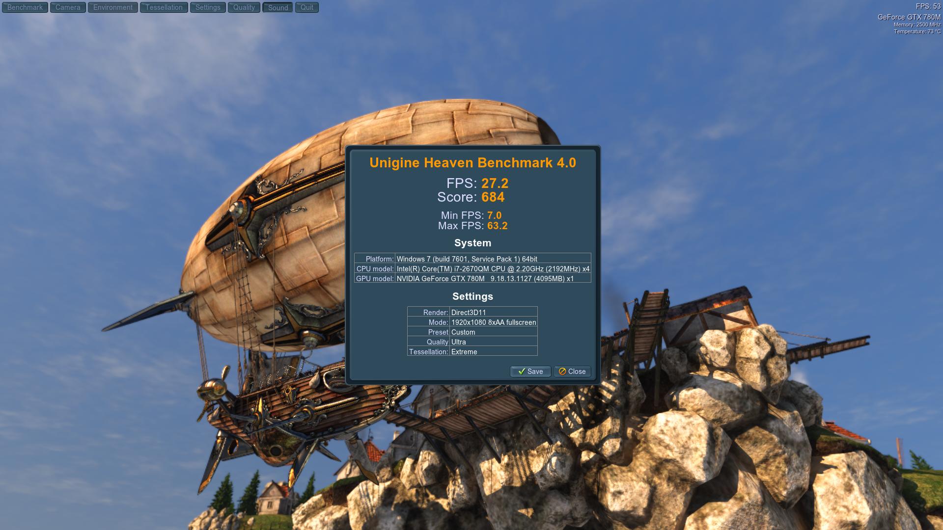

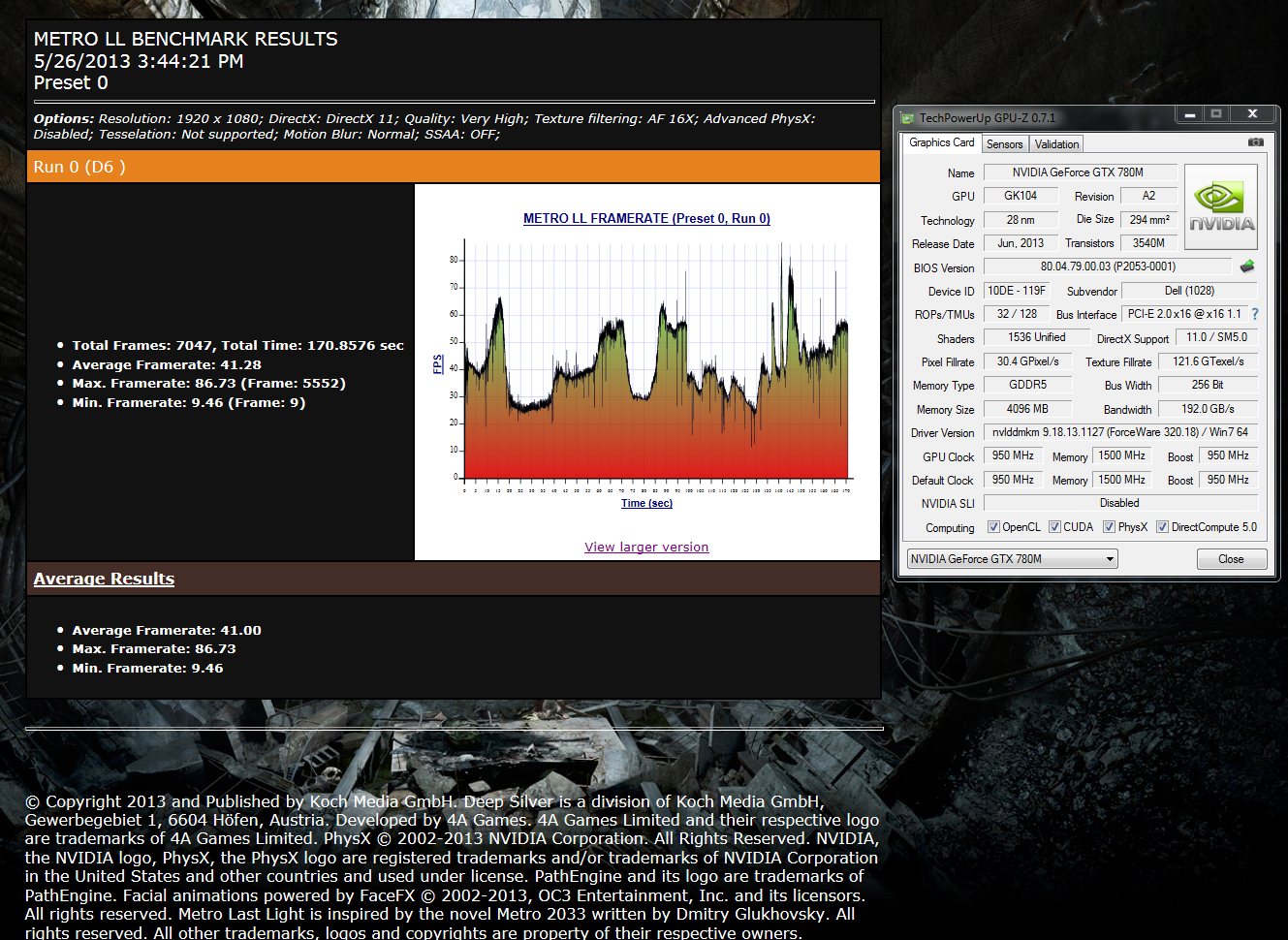

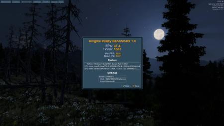

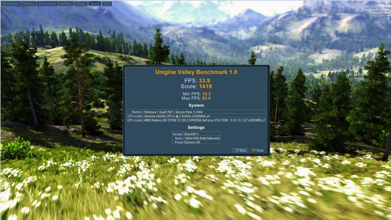

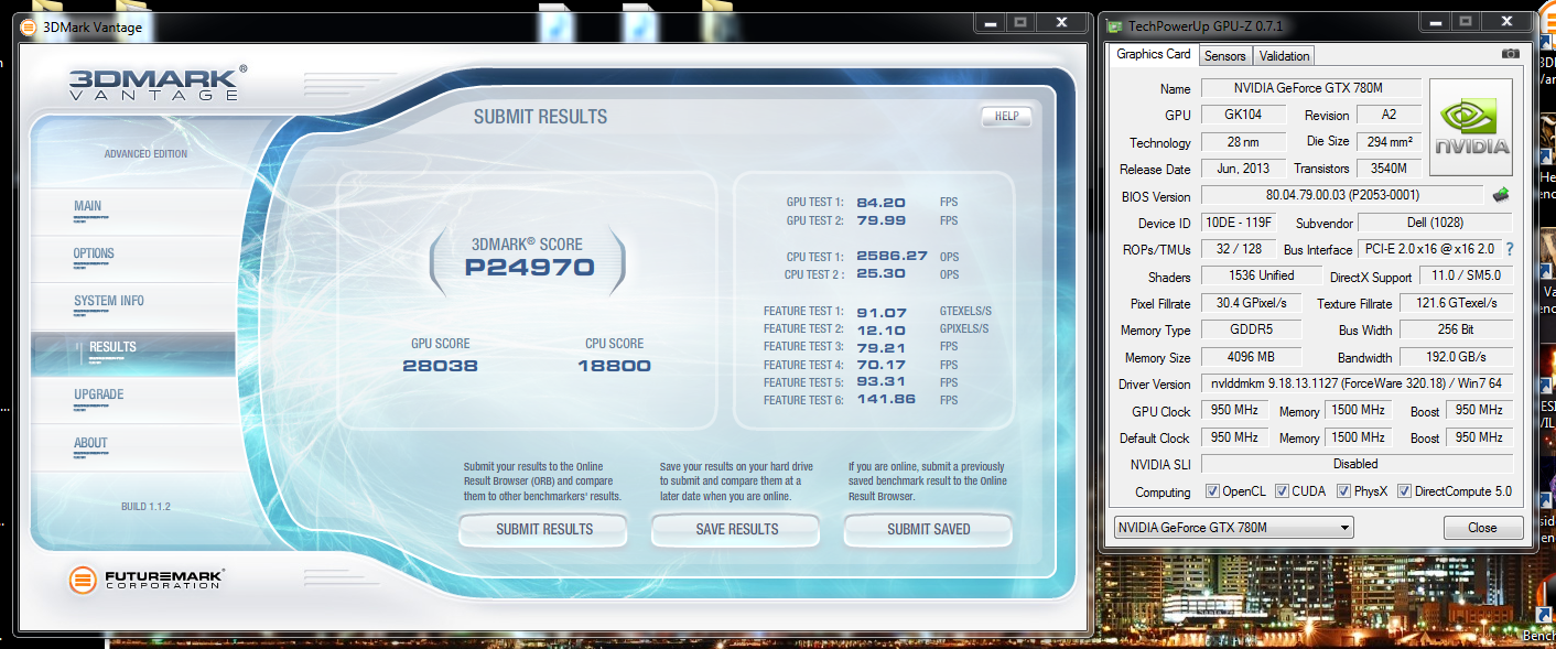

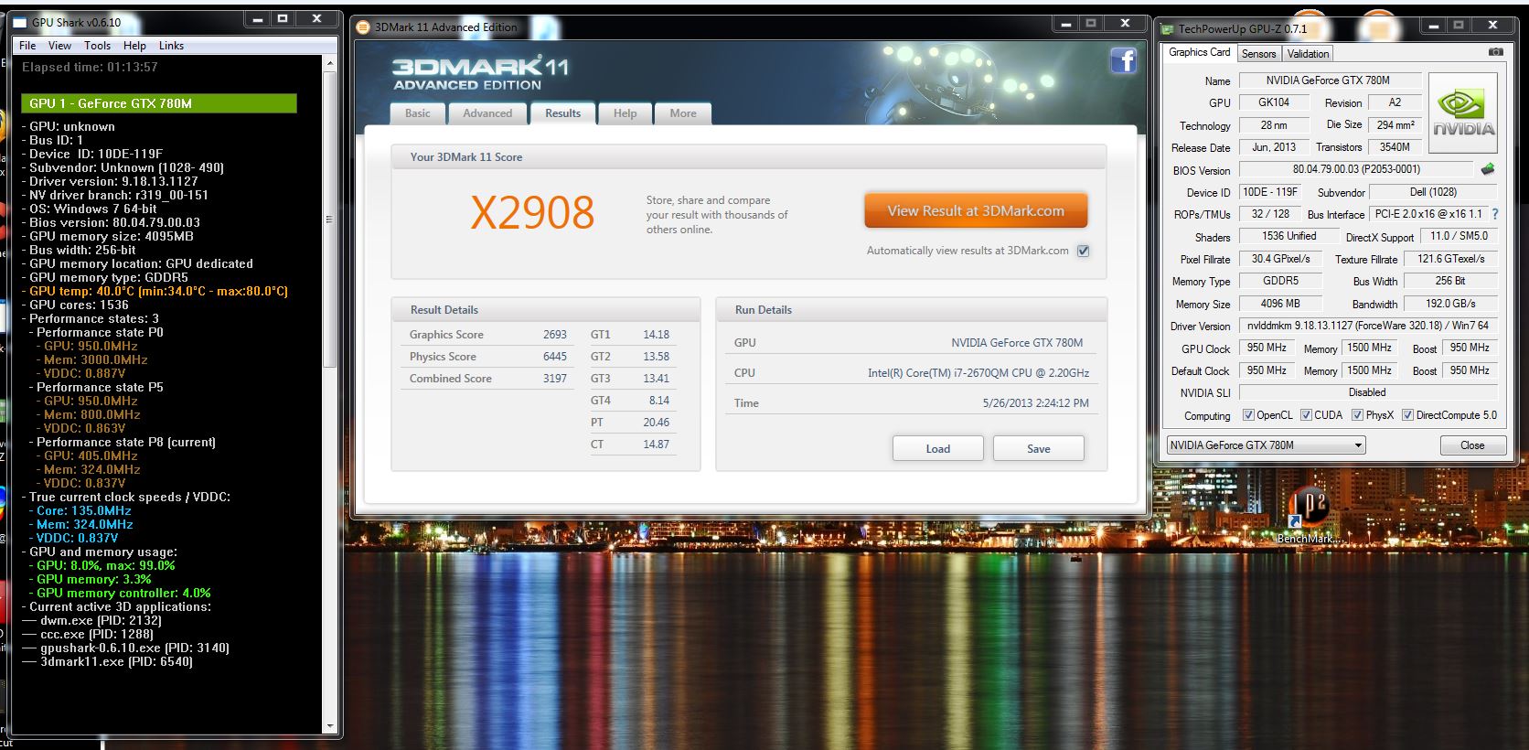

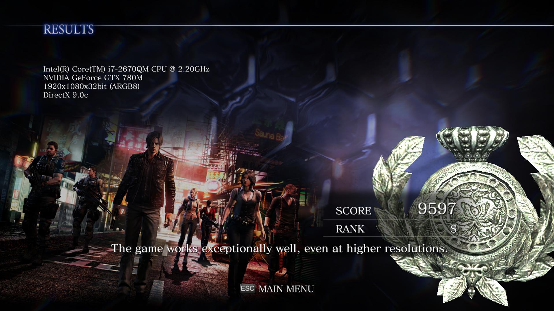

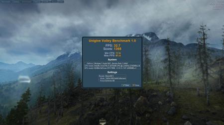

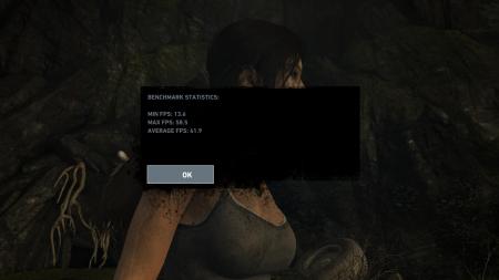

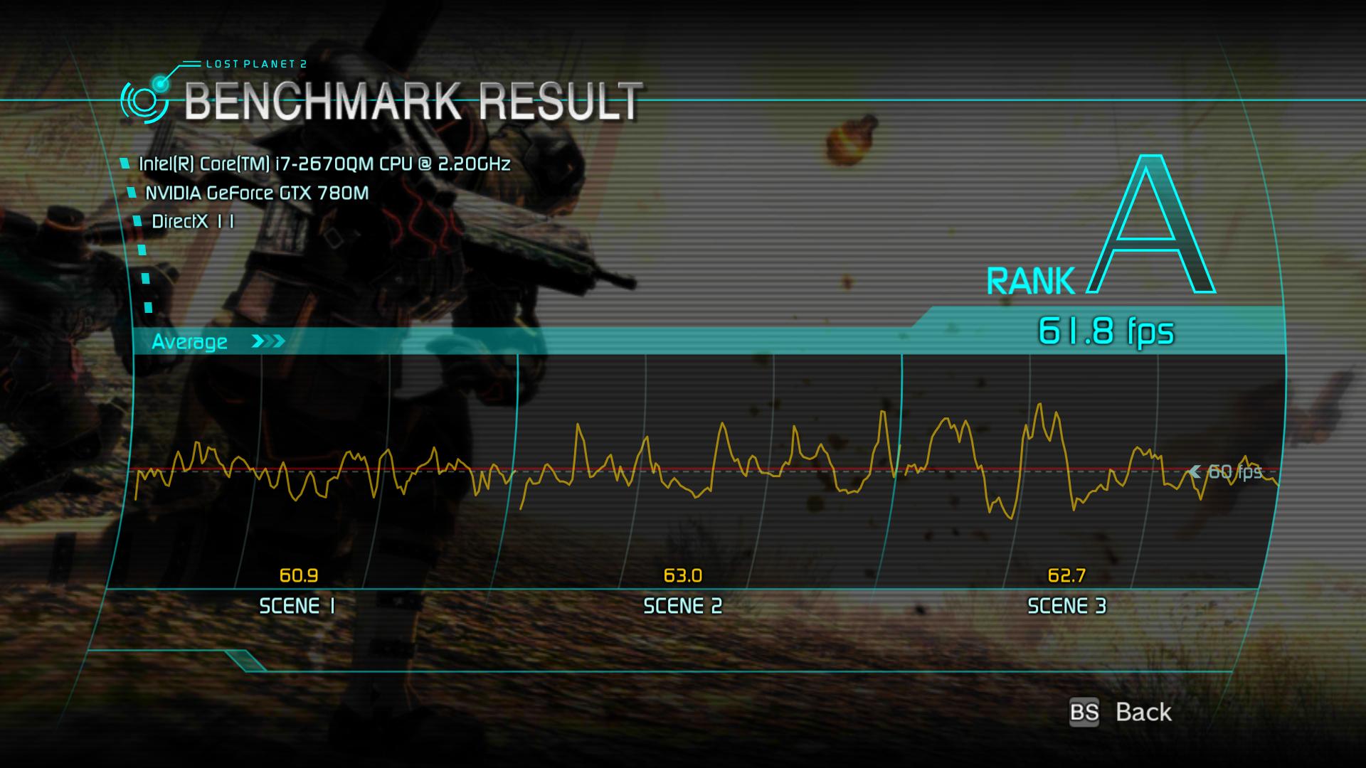

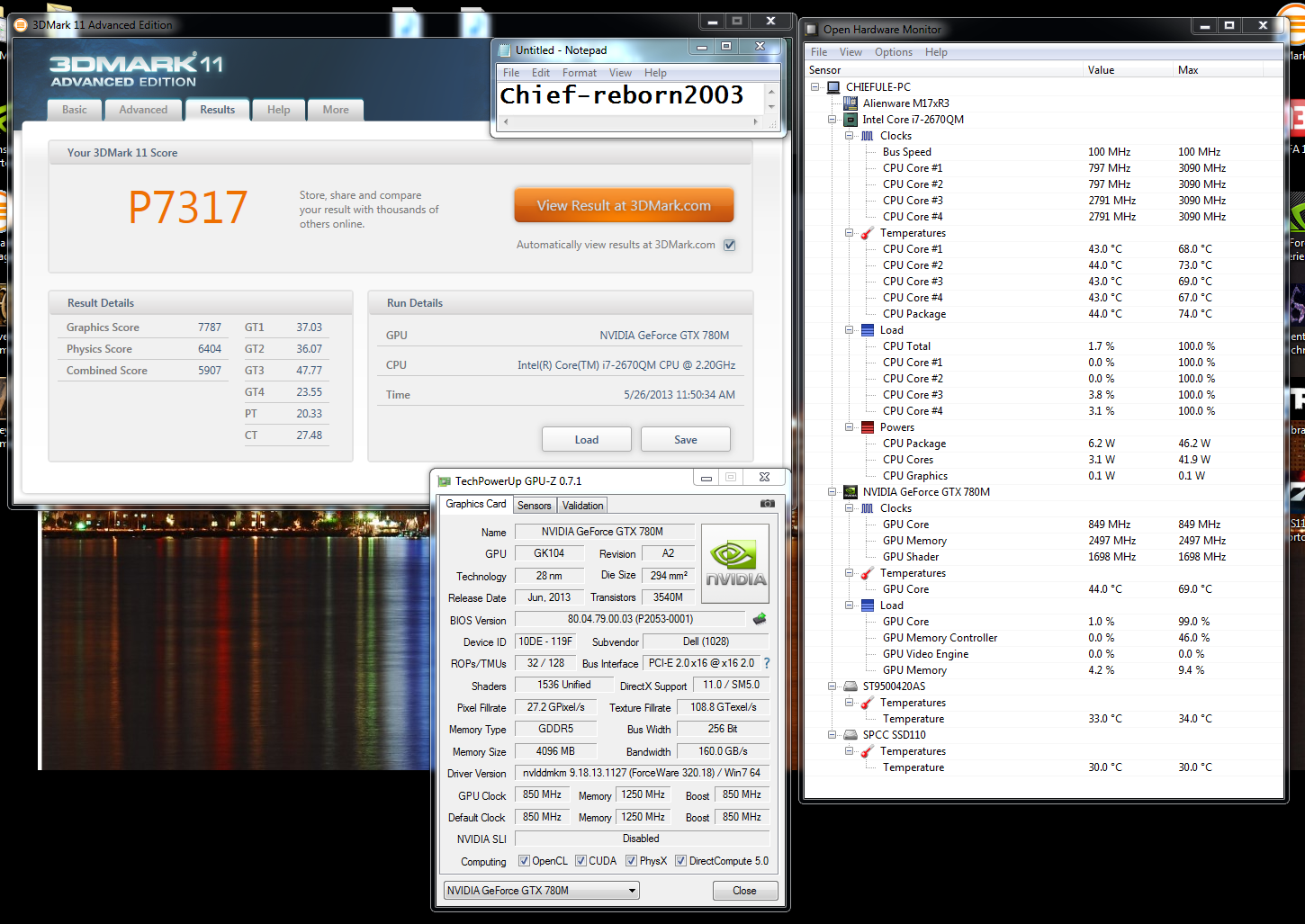

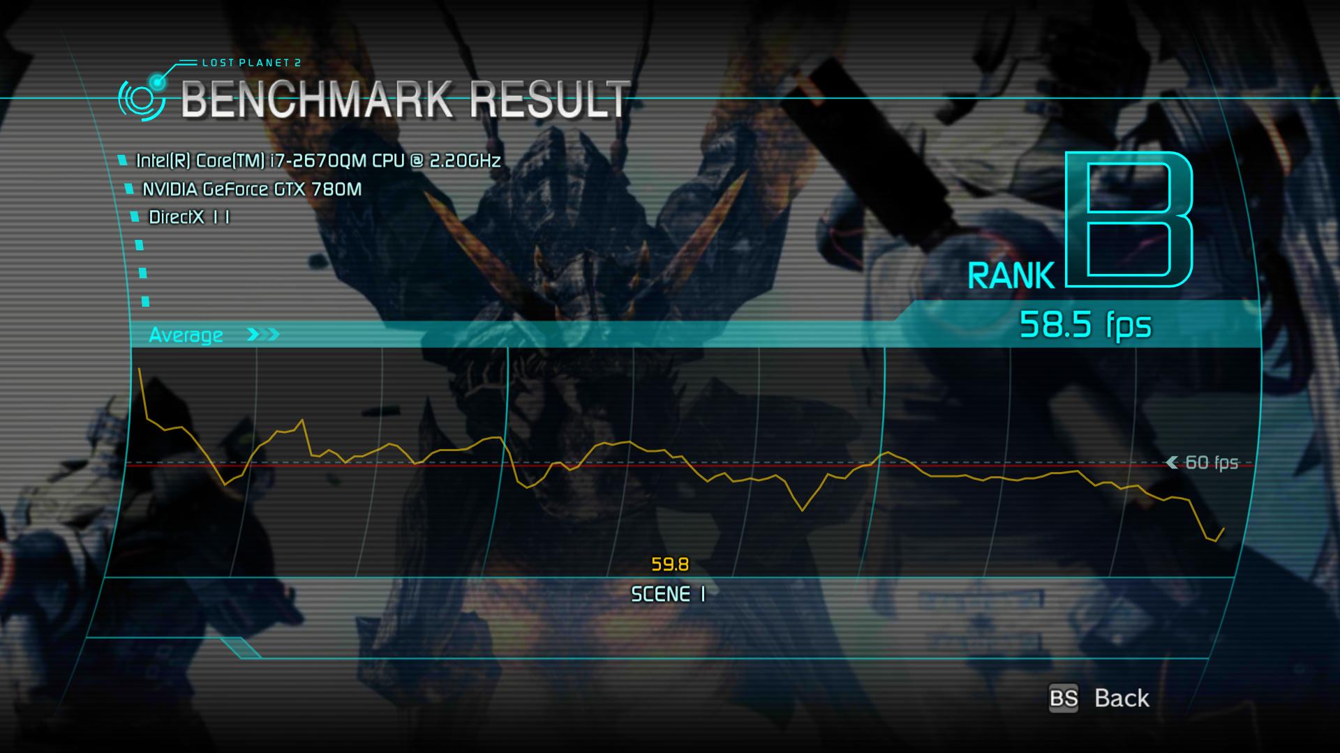

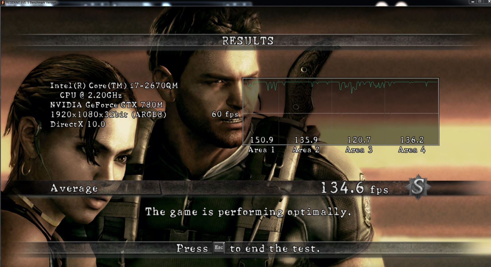

Running the GTX 780M in an Alienware M17x R3 :Banane02:
Every test is run to its MAX/Ultimate settings. All sliders moved to as far right as possible. ;)
Stock CPU and GPU clocks.
Stock CPU clocks and Overclocked GPU clocks @ 950Mhz Core + 1500Mhz MEM.
Cheers. :)
