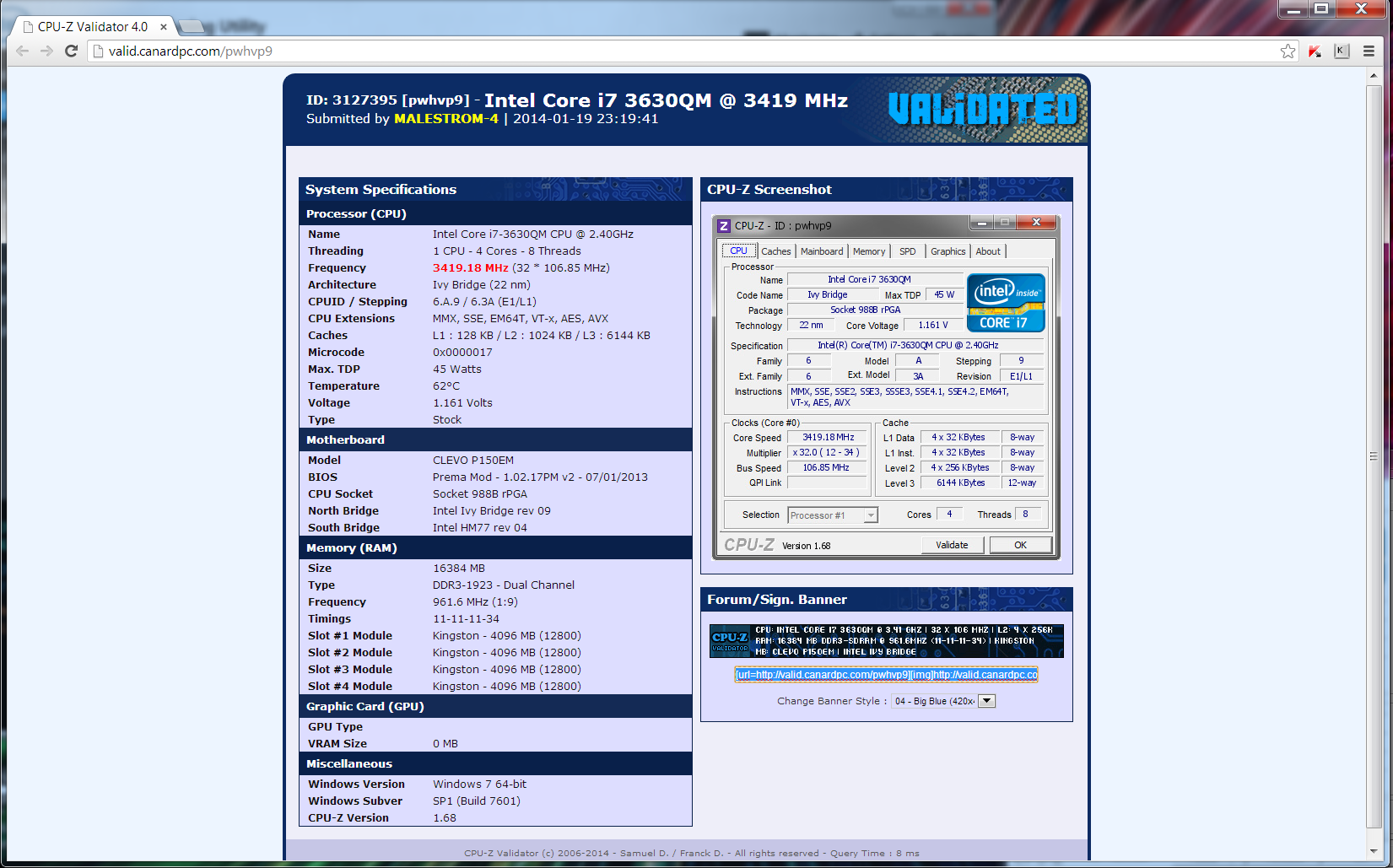

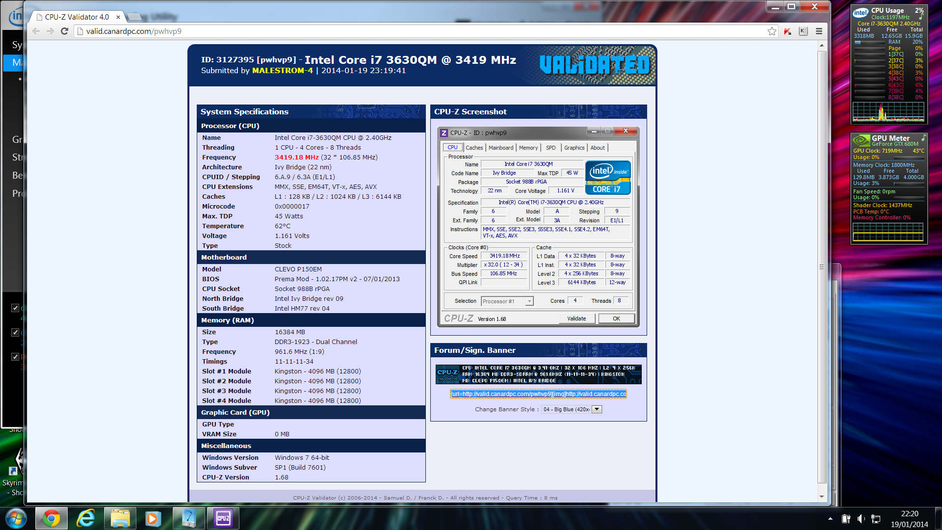

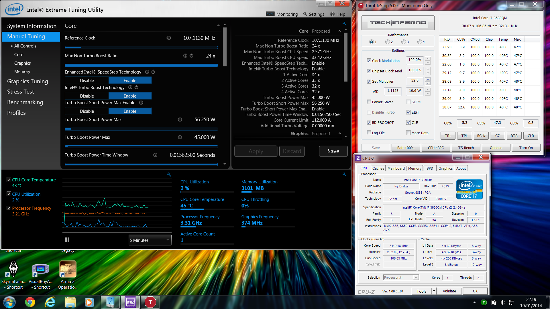

I did some more OCing for highest possible bclk (disregared if the gpu got dropped) and maxed out at 106.99 on cpu-z (107.18 reference clock) above 107.26 the system lags for about 5 seconds then crashes (well shuts down thanks to xtu safety features) I would experiment more but i almost corrupted windows using the "restart glitch" to bump the bclk past 107 and had to recover from the disc.
Thank you to prema for making this possible!!!!
Here's the fruits of my labour:
