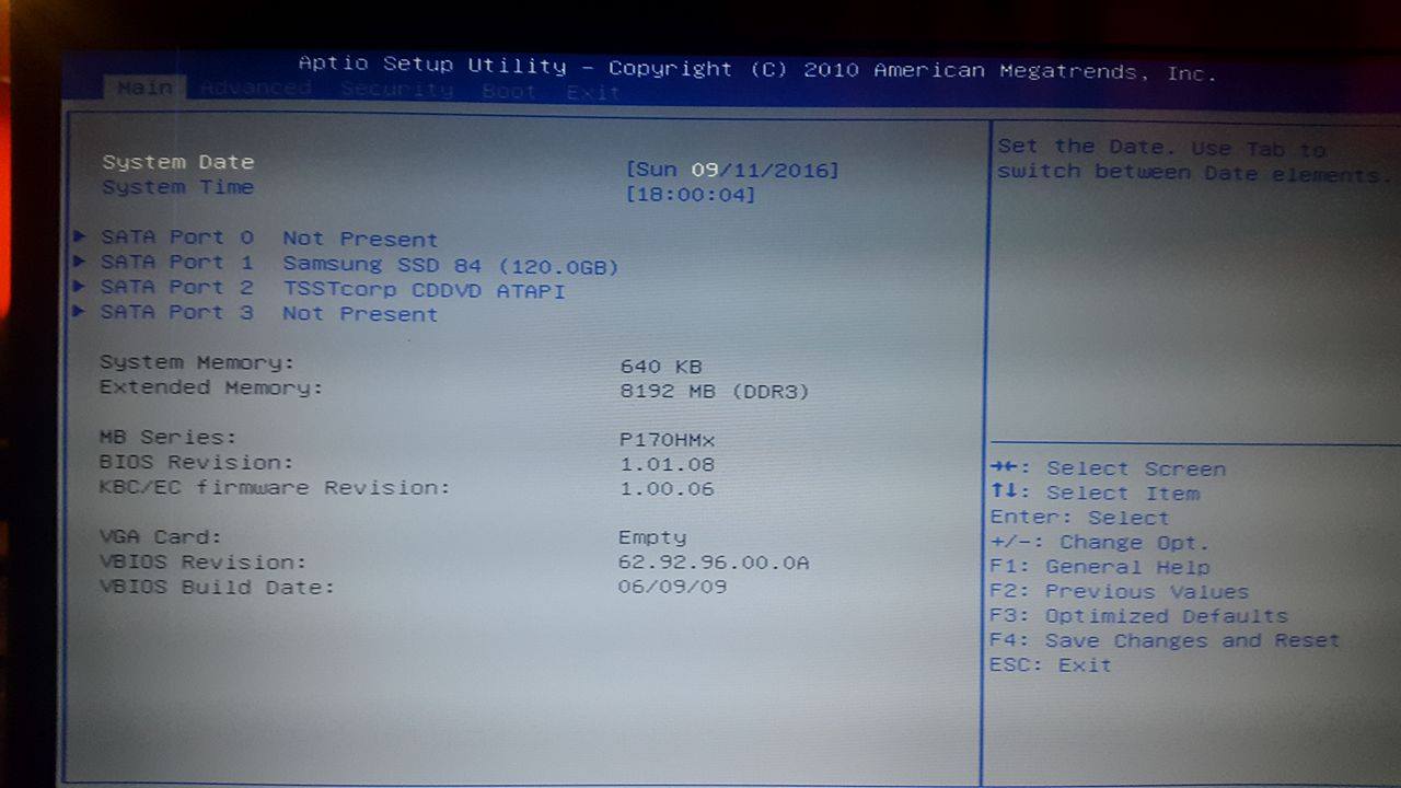

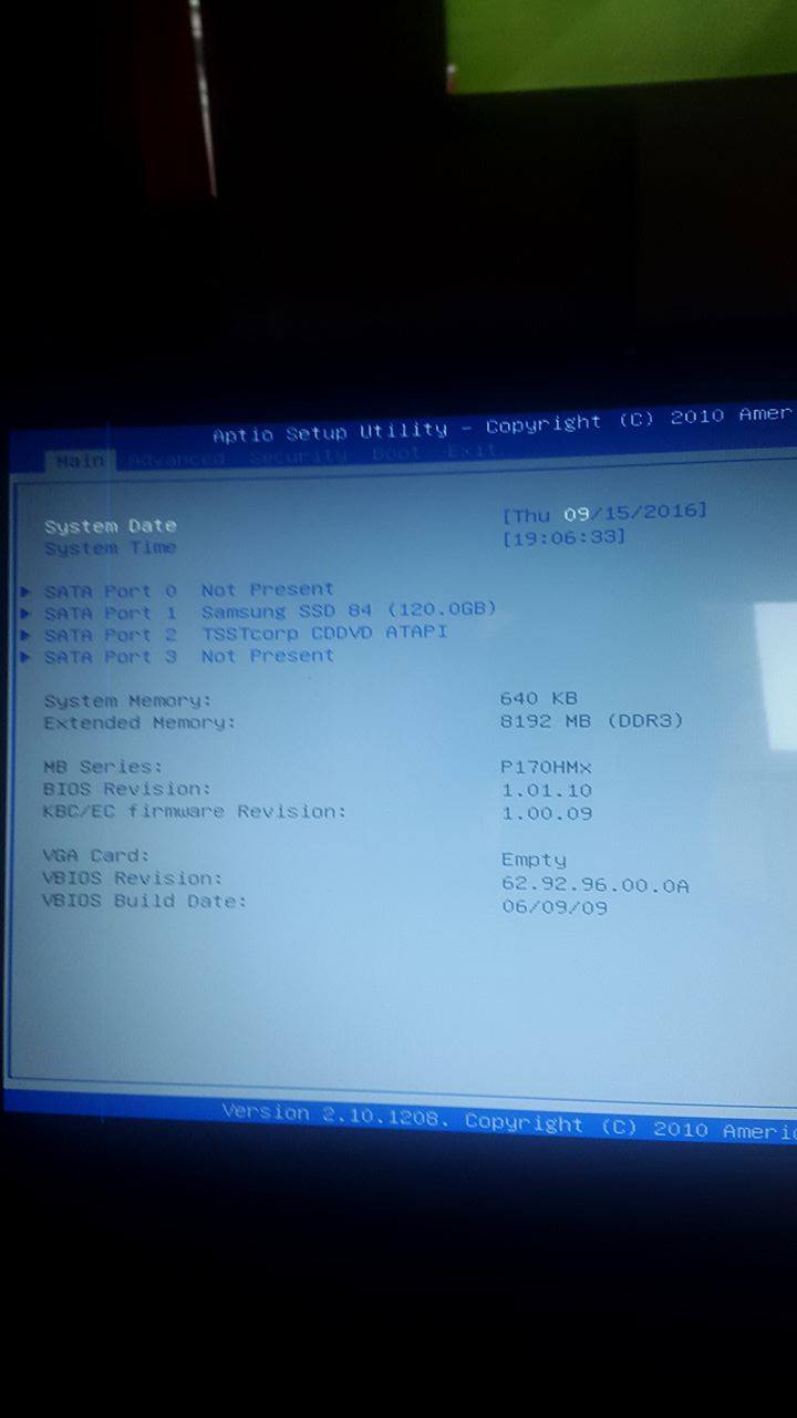

I need help i have an p170hm clevo and my GPU died then i was told nvidia gtx 260m should work in so i bought it because it was cheap .. :)
And now i got a picture and it is nice but i can't  install the driver to it. it's says it cant find the hardware when i try to install it. But i think my computer is locked some how but is there any way to unlock it and can a bios update be the solution?
Hope you can help @Prema Or anybody else. :D
On 11/9/2016 at 3:53 PM, Volds said:
I need help i have an p170hm clevo and my GPU died then i was told nvidia gtx 260m should work in it so i bought it because it was cheap .. :)
Bios cant recognice the gpu ? :/
Edited by Volds
