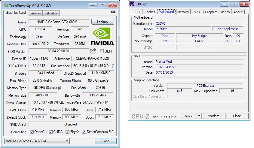

Hi Prema, my PC is so much better now, I was reading and making the preparations for flashing vBIOS, and saw something that's odd.
You said that Clevo v29 could brick, but my card is a stock v29. It will be fine if I flash v67 like you said before? I only want a BIOS that removes the throttling, my PC throttles a bit when well under 80ºC.
Pic of GPU-Z for VGA and CPU-Z for NB Model
[ATTACH]15969[/ATTACH]
No worries, that warning is ONLY for PxxxHMx systems, NOT P1xxEM.
