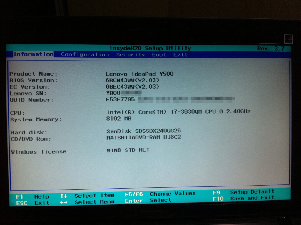

I just received my second Y500 with the 750M, first one a few weeks ago, second one on the 14th. They have both come with BIOS version 2.03 / 6BCN43WW. Here is the latest version, [ATTACH]7535[/ATTACH].

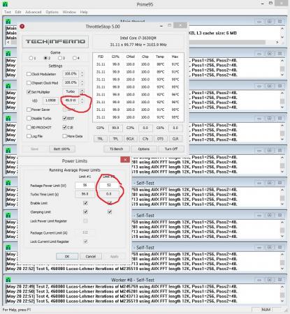

Actually you're not totally correct. What I have done is override the long duration power limit (either in BIOS or in TS), to 56W, and you will see the CPU maintaining 3.2GHz in Prime95 for as long as it doesn't not overheat. My CPU stays below 90C (no gpu load) in p95 running at 53W.

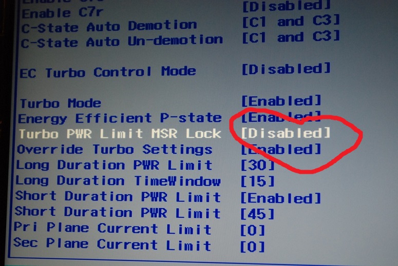

To override the power limits using TS, you have to disable the setting in BIOS which locks the power limit. It's a few lines above the long/short duration power limits in BIOS.

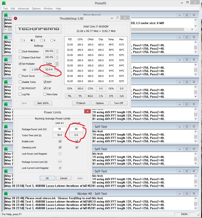

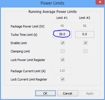

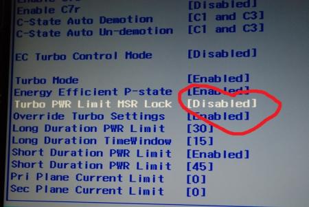

Mind taking a picture of exactly which setting you changed? I don't recall ever seeing a working setting that allowed you to increase the TDP of the CPU. The Long Duration PWR Limit and Short Duration PWR Limit settings don't work. The only thing I could change was the Long Duration TimeWindow setting which corresponds to this in ThrottleStop. It's controls the amount of time the CPU is allowed to exceed TDP and go as high as 56W before throttling back. Default is 28 seconds and range is 0 to 56.
Limit #1 and limit #2 for Package Power Limit (W), which correspond to Long Duration Power Limit and Short Duration Power Limit in the BIOS, are both grayed out in ThrottleStop and nonfunctional in the BIOS. I'm on the unlocked 2.02 BIOS.
[ATTACH=CONFIG]7566[/ATTACH]

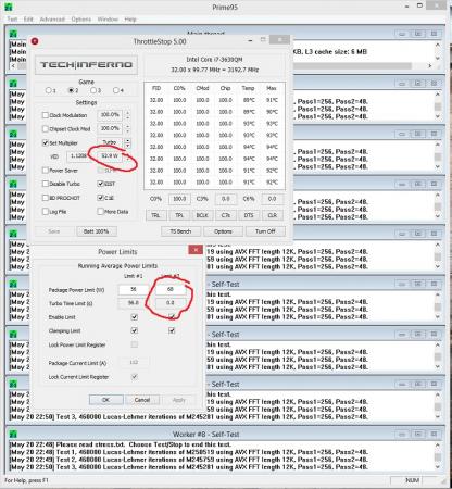

Disable this.

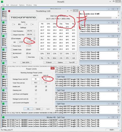

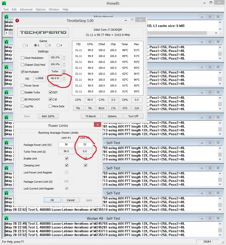

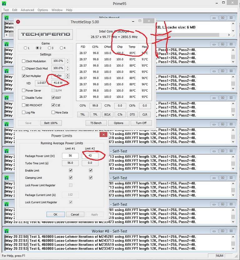

As you can see I can keep the CPU at so called short duration boost all the time. Give it 68W and it will take about 53W.
As I reduce the power, the CPU power drops and the speed drops slightly.
As I have said, you will need to provide at least 53W to the cpu to maintain 3.2GHz boost.
If you look at the temp, they don't really vary much. And I also also observed that at times the temp delta between CPU and master GPU is almost 15C. Which points to me a problem. The flaw is most likely the heat transfer rate from the die to the copper plate/pipe. It's not fast enough. Intel Ivybridge has rather high thermal density, and it will only get worse as Haswell comes out. I expect quadcore mobile Haswell and desktop Haswell to run as hot, if not hotter. Only the ULV range CPU will see lower temp. But since the fiasco with the low grade TIM between the die and the heat spreader in their Ivybridge CPU some time ago, I hope Intel will step up somewhat.
