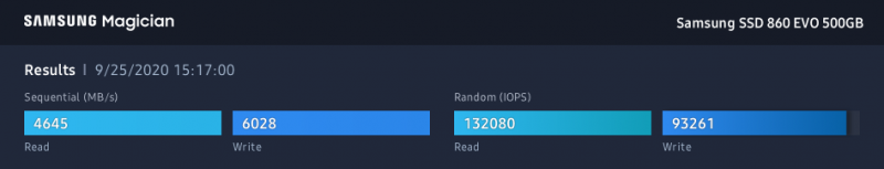

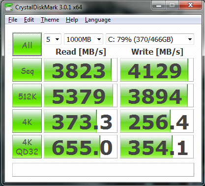

Greetings. Came upon a really interesting issue. I've replaced the drive in my 2570p with a Samsung 860Evo 500GB SSD and I get the following read/write speeds, as well as these ridiculous IOPS figures.
This is a SATA drive, not NVME. Meanwhile, the 860Evo 1TB in my desktop PC shows more reasonable 500ish MB/s transfer figures.
I am baffled. Any ideas?
Edit: this is due to the Samsung Magician software that makes the SSD somehow show the buffered RAM transfer speeds instead of the actual SSD transfer speeds. I've activated it on my desktop PC and now my 850Evo connected to an SATA 6 port shows 5.5GB/s sequential read speeds and 3.3GB/s sequential write speeds. Nice first post, well done me :/
Edited by cosmin_c
