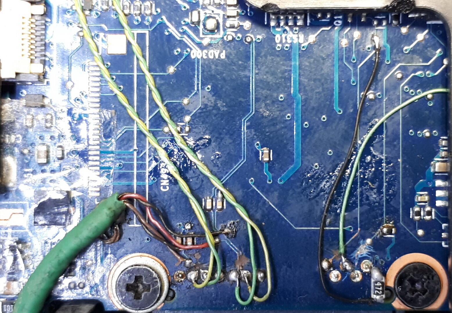

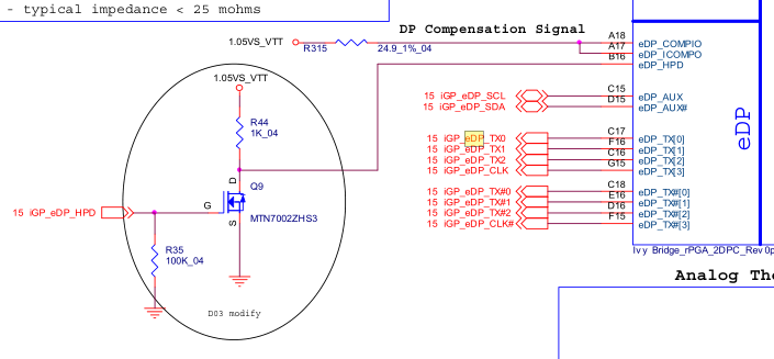

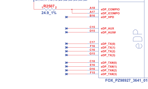

New user reporting in.
Even though I haven't received 2570p in my hands yet, i'm curious, is anyone tried an socket eDP mod? Since eDP is coming right from CPU and it's socketed in this model, there is not too much trouble to achieve it without loss of docking station functionality. One trouble is inversion schematic for eDP_HPD signal, but theoretically that input can be permanently soldered to vtt or gnd.
There are 3 variants:
1. just solder wires under the socket - if corresponding eDP pads exist on the other side of the motherboard;
2. place wires between socket and CPU, with inserting copper leads in the socket pits or making a lasso around corresponding CPU pins with it;
3. unsolder these pins from the CPU and solder wires to the CPU instead - very hard and compromise variant, actual in case when pins not hang in the air as described in schematic for the 2560p.
Yup, this is theory, but chances to get it to work are pretty big i think.

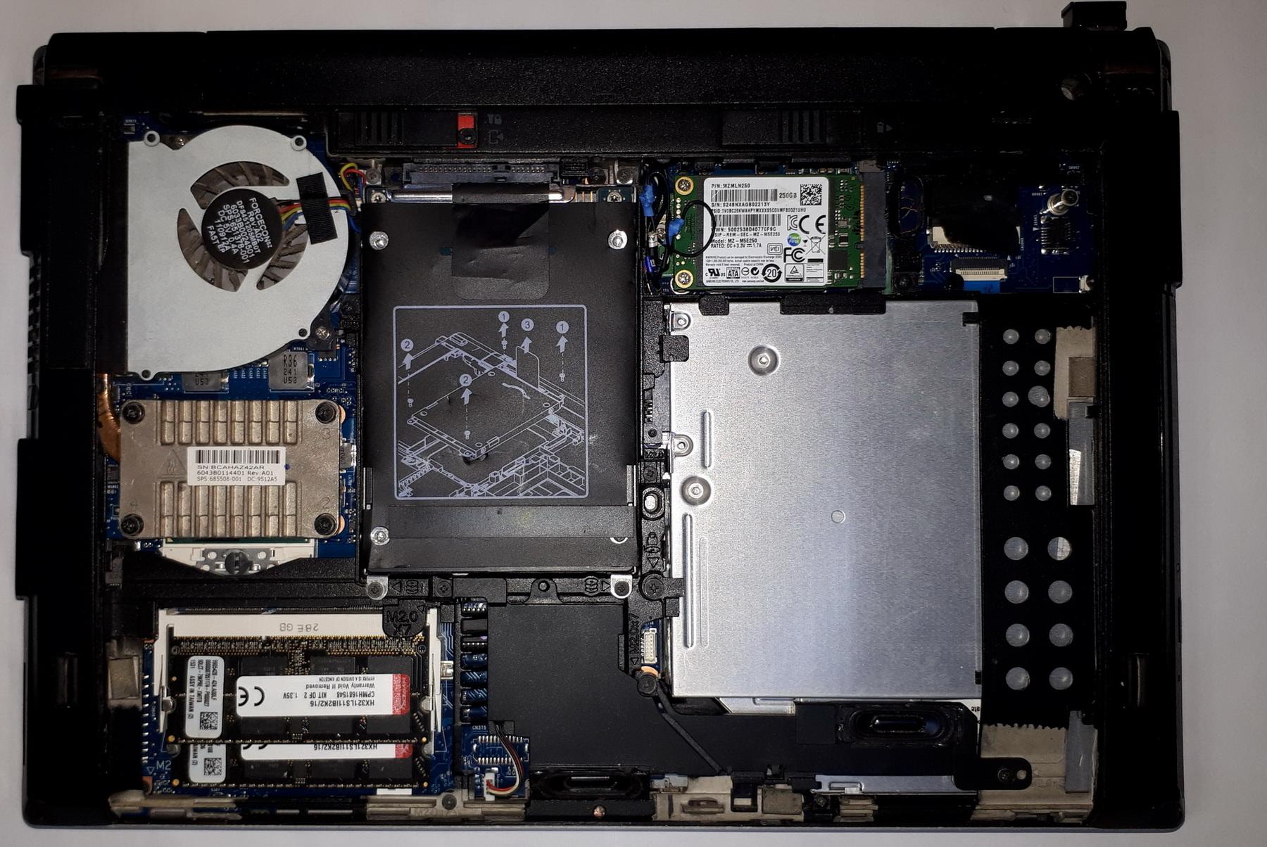

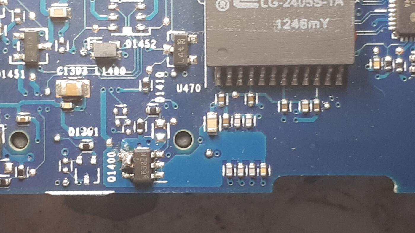

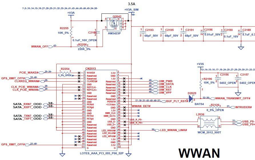

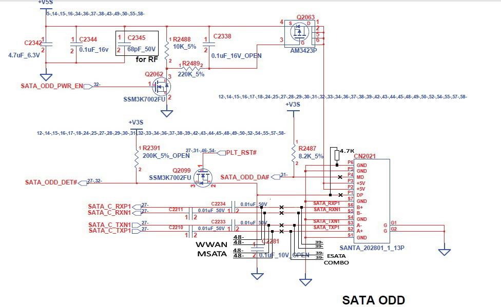

Hello, everybody. I've done this work by an other way. I was thinking about how to replace WWAN to mSATA. I soldered ways SATA ODD with WWAN socket. But for DWD RW I soldered ways from eSATA COMBO.
On the photo:
If the BIOS will turn off a WWAN socket you just solder the jumper on transistor:
The Windows installed on SSD, HDD just for files and I put back the DVD RW.

mSATA expansion is interesting feature not because its something unusual but its offers additional storage space without need in replace main storage or use external storage with this notebook. Even if this technology is dead, **70p series that not much worse than modern businessbooks (except display) can be upgraded with this particular type of storage.  In addition, mSATA SSDs now popular primarily on classified market with affordable price, that OEM samsung drives is exceptionally tasty offers.
@Onoakino Sorry, but i don't have time for video records. When i'll get some free time I can make full image from F.34 dump if it's full, but if you guys is not ok with same serials then nvram still needs to be replaced.

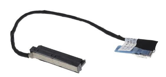

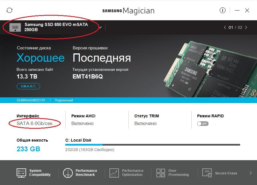

@invait53 did you check disk SMART's for interface errors? I've got DMA errors and fallback to 3.0Gb-mode on much shorter cables in times when i don't have internal SATA adapter.
I had the same problem. I tryed to solder wires from LVDS cable and it was working with 3.0Gb-mode. Finally I bought the SATA extention HP DV7-7000 DV6-7000 and took SATA wires from that extention. mSATA SSD works with 6.0Gb-mode. I think that in the SATA cable wires are special.
Edited by invait53

15 hours ago, juandante said:
But, one question, can you do a software RAID with mSATA and SATA ?
Yes, of course I can do RAID. The difference between mSATA and SATA is a formfactor only. That's why i did my mod. If I will use RAID I will still have the free caddy.
Edited by invait53
Yes but no, there is no need to have a free cady for the sake of having a free cady. First you gain only few grams if it is a weight problem so this is pointless. The only useful thing with the mSATA is either RAID0+1, for high resilience, but a laptop with high resilience if pointless,
or either having a 2TB hard drive and a high performance (800 to 1000 mb/s) RAID0 drive of SATA, this could be interesting. But you have still not told us about this question, is your drive in the WiFi slot or on the WWAN slot ?

  Test : 100 MiB [C: 60.9% (72.2/118.6 GiB)] (x1)  [Interval=5 sec]
  Date : 2019/09/27 20:25:04
    OS : Windows Server 2016  [10.0 Build 14393] (x64)
PS : I have a mSATA drive on a standard SATA adapter in my 2570p so I could do the same screenshot as you without the BIOS mod ^^
