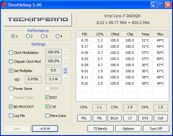

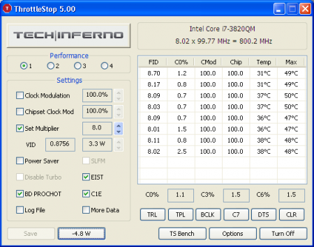

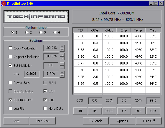

I'm experiencing higher power consumption under Windows 7 than under Windows XP.
Quite strangely, under WinXP average idle is 4.7W-4.8W even with 2nd HDD in ODD bay, but in Win7 it's hovering between 7.4W-9.2W.
ASPM enabled on all devices, msr 0x1B0 set to 0xF, no useless background services, min brightness, no wifi, etc. - same HW conditions on both OSes (no FDD/USB devices connected, no ethernet), disabled C1/C3 undemotion (both OSes), graphics set to max power savings
In Throttlestop the CPU package goes down from 3.7W to 3.2W on WinXP in about 2 minutes while on Win7 it stays on 3.7W forever.
I'm suspecting some issue with core parking but power management is untouched.
Anybody help?
WinXP:
Win7:
