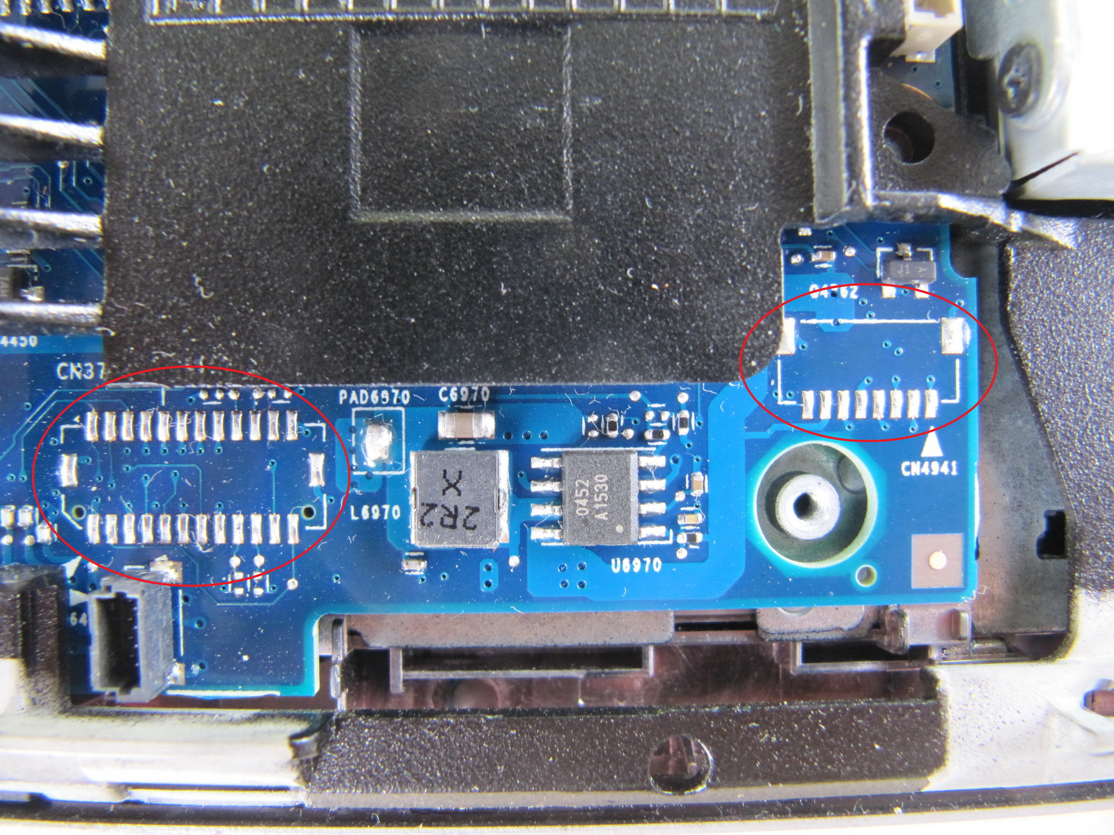

INFO: unbridged tracks on 2570P WWAN socket are mSATA but no BIOS support
According to a HP head engineer that I'm in contact with that developed the 2570P those extra unbridged tracks on the WWAN slot (pin 23,25,31,33) are mSATA. I was advised that soldering the lines will enable it electrically.
Problem is the code to enable that SATA port2 so it can be used was removed in an early development 2570P bios version. I've asked him to see if that code can be re-injected back into the bios for which I'm awaiting a reply.
If (likely) not, then the only chance of getting the mSATA part of the WWAN slot to work would be to do a risky 8470/8570 BIOS cross-flash. Keep in mind too that those 8470/8570 systems don't have mSATA boot support. They only support the mSATA SSD being used as a cache module alongside a HDD. Though I have read of users booting their HDD and having the BCD directed to then boot Winodws off the mSATA SSD.
To bridge the WWAN pins 23,25,31,33 solder SMT 0ohm resistors on the pads as shown in the image below. Image courtesy of pandaleo.

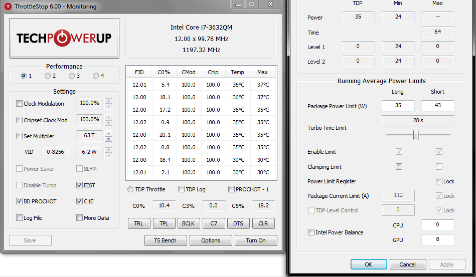

I have the same visuals as you except 45w/56w for Long/Short. I tried pushing the 'Time limit slide' and lock the 'Power limit register' -> Apply.
Started Prime95 and HWinfo only shows 100MHz x 27 at most :(

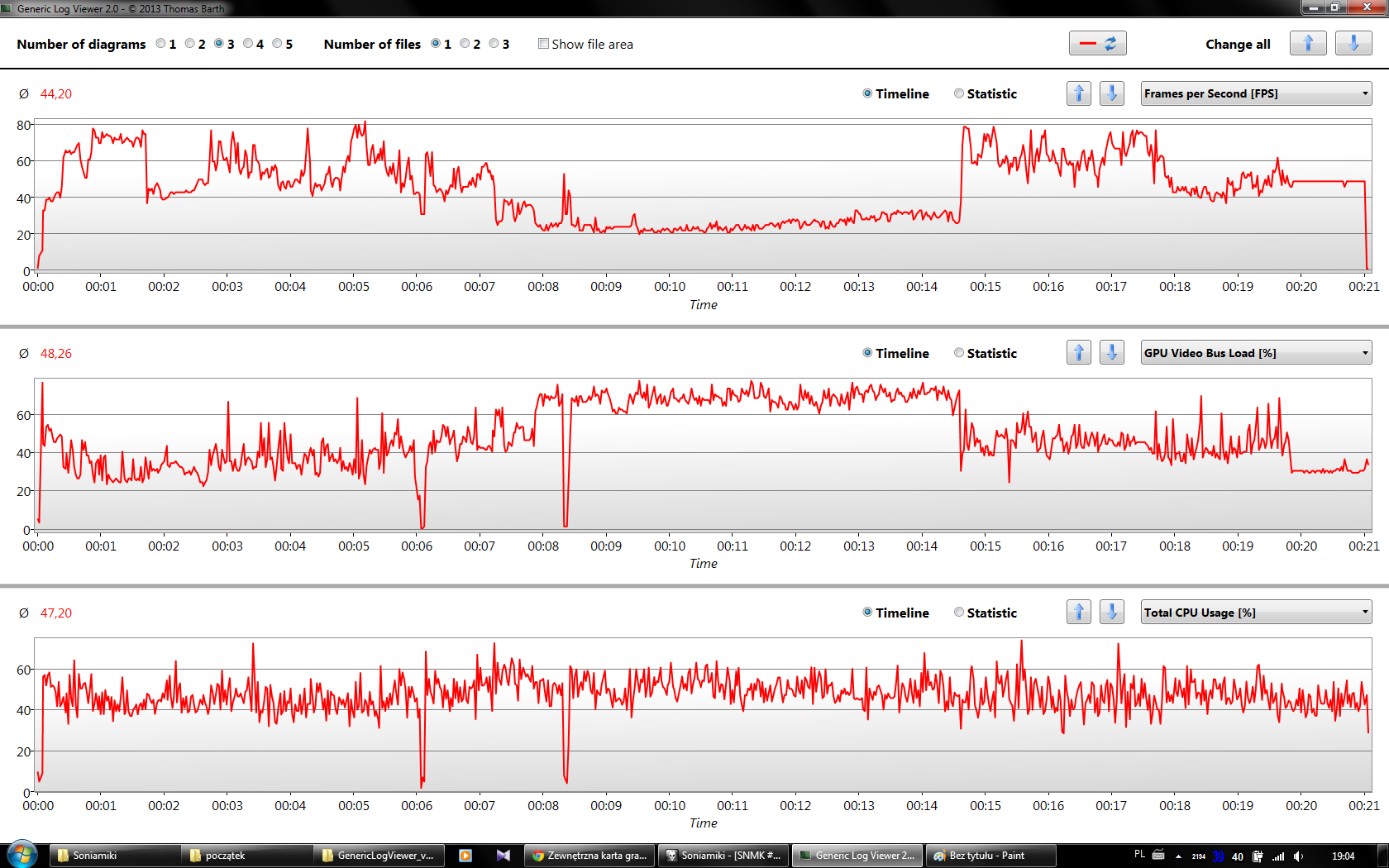

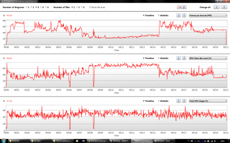

According to Throttlestop, TDP locking. What values should I set? Another interesting thing is that, during play BF4 single/multi on FHD and High preset, there is only 40-60% CPU usage. should be some around 100%, BF4 is really CPU dependant. There is no option of throttling cause max tempereature on core during one hour play was 79C. Other cores around 75C. 90W AC. High Performance.
Here You have picture with FPS, Video Bus Load and Max CPU usage. As You can see, the whole, long FPS drop (middle of third mission) is related to video bus load choking. On polish board we found some other games where GPU bus is responsible for huge fps drops. like Crysis3 (when come out on grass).

Try setting the turbo limit time = maximum to see if that makes a difference. You could have a go at setting the 45W CPU limits, ie: package power limits=45/56W.Not sure on that one since you are running a 35W CPU that might just ignore those settings.
