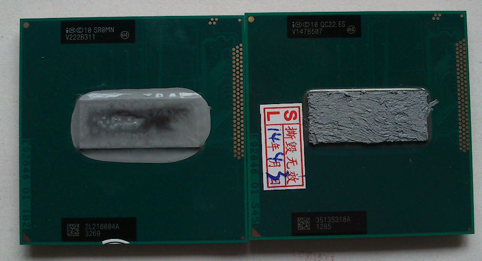

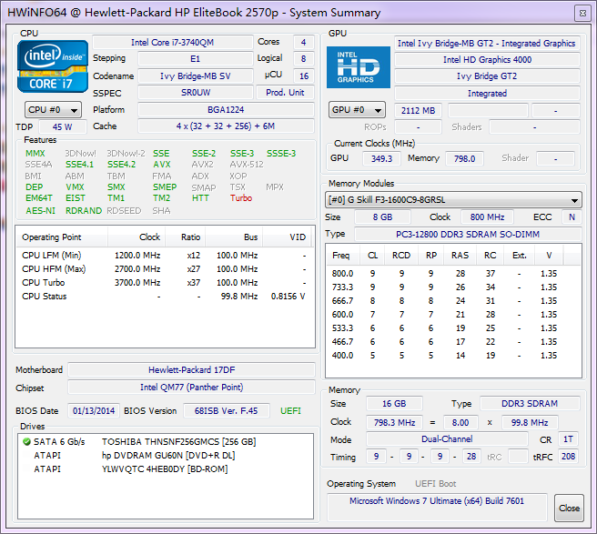

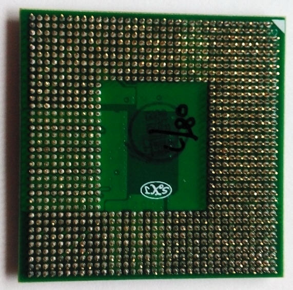

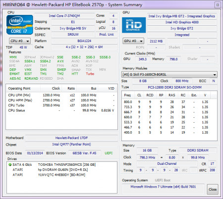

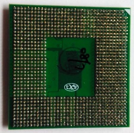

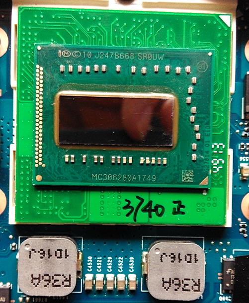

I replaced 3920xm QC22 es to 3740qm SR0UW BGA TO PGA and saved money. BGA TO PGA version cost about half price of original PGA version, just a little worry about the quality. The PGA pin is not so good at install to the socket. And it has two PCB boards, so is thicker than original PGA. I should pay attention to fixing heatsink screws slowly, prevent breaking the core. [ATTACH=CONFIG]12015[/ATTACH] [ATTACH=CONFIG]12016[/ATTACH] CPUZ detects it as PGA, but AIDA64 and hwinfo64 can detect it as BGA version. [ATTACH=CONFIG]12017[/ATTACH] also make a throttlestop test, cannot stand on x34, quickly get down to x33. x12 x23 x24 x25 x26 x27 x28 x29 x30 x31 x32 x33 0.8156 0.8956 0.9006 0.9156 0.9257 0.9457 0.9557 0.9757 0.9957 1.0157 1.0408 1.0658 10.8 19.3 20.5 21.7 23.0 24.5 26.4 28.2 30.2 32.6 34.7 37.1- 1884 replies

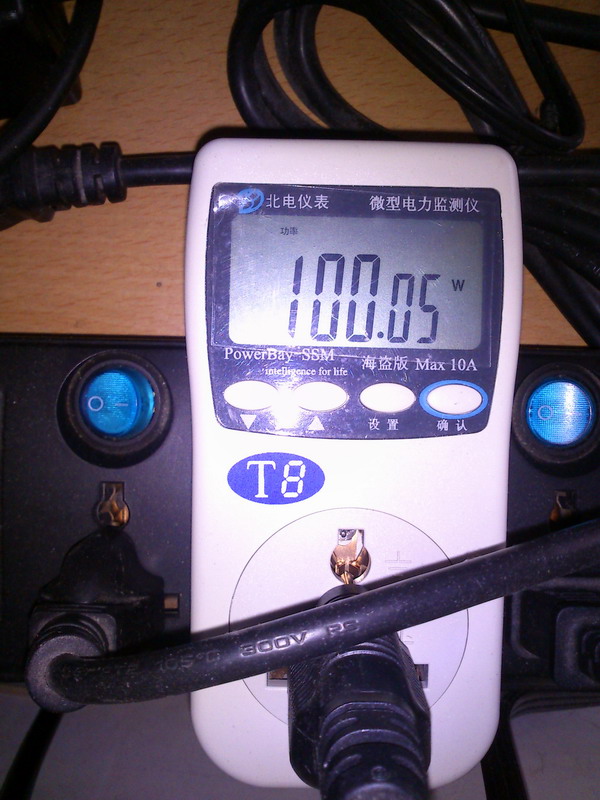

After tried MaxMulti, unfortunately nothing changed. I captured some screen below, hope it can help you. 1 thread can reach x37 2 threads can reach x36 4 threads get x32-33 I noticed when setting multiplier to x33 or higher, then run ts bench, it can reach x33 and quickly down to x32 forever. About 1 second at x33 by log. My AC adapter is 90w, I think it's no problem on power supply. When the CPU is on full load, the laptop only reach 60w. When using AIDA64 stress cpu,fpu,cache,memory and gpu at the same time, the whole laptop can reach 100w. I'm not sure if the bios limited or the cpu power supply circuit limited, from Tech Inferno Fan's thread, no cpu can get over 40w.- 1884 replies

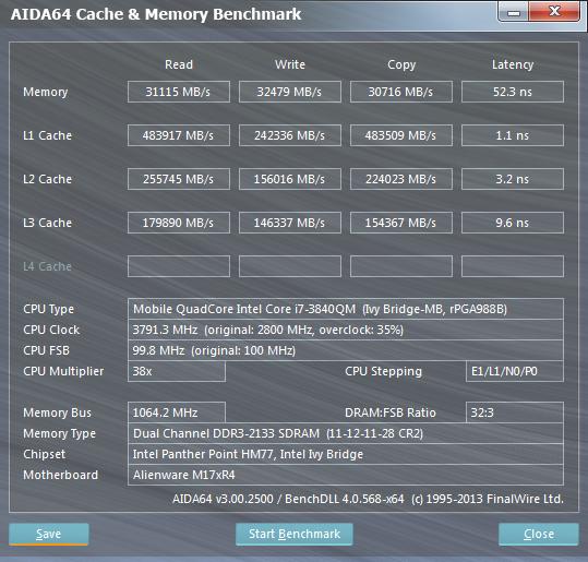

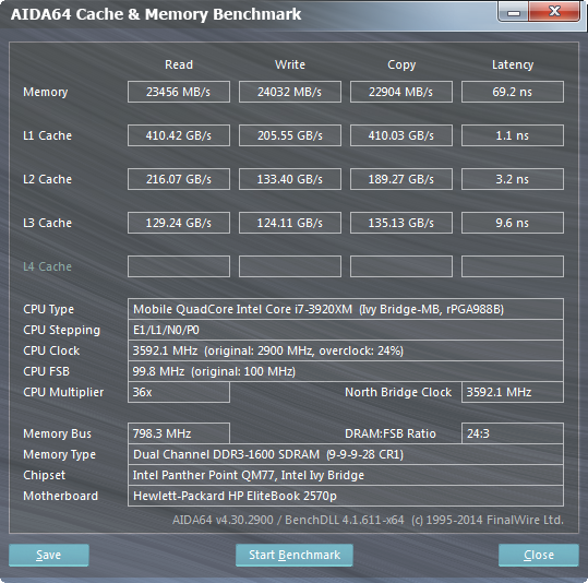

I've just upgrade 2x4G to 2x8G DDR3L, because 8G is not enougth for me. I used to creat 4g ramdisk to save temp files. And the test is below. It seems the same between them. Before: Hynix+NAYA 11-11-11-28 Now: G Skill 9-9-9-28 I am not sure if it can affect the HD4000 perform and the power supply, but the latency affect is no feeling as usual. If you have not enough ram, i recommend to upgrade 16g.- 1884 replies

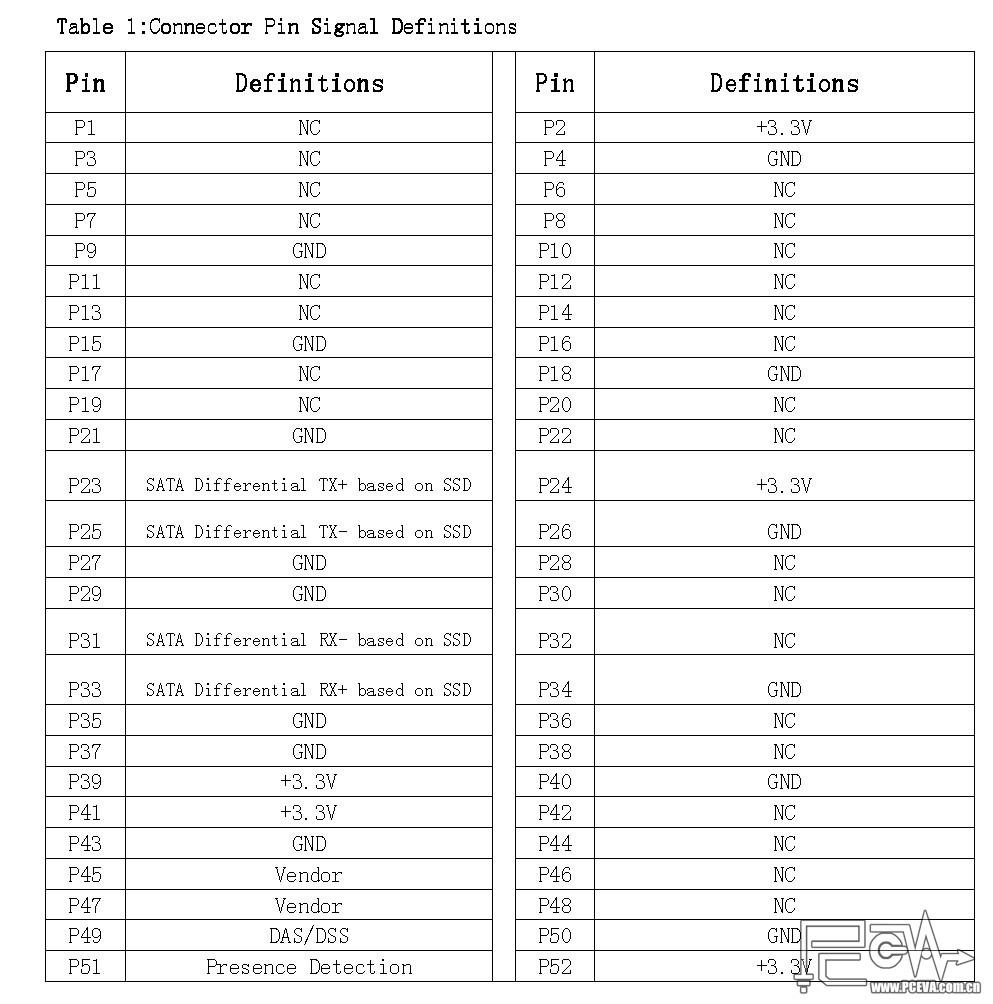

My msata SSD is TOSHIBA THNSNF256, the pin 23,25,31,33,45,47,49,51 are main, the others are power supply, GND and NC(pin 20 is not used at my ssd).So i don't know how hp detect the card is wwan.- 1884 replies

I've checked the wwan slot's pin, the power supply and GND pin are the same as msata slot, just pin 23,25,31,33 were cut by HP, so I connect them and test with a msata card. Unfortunately startup bios detect it is not wwan and disable it, maybe is whitelisted. And then I cover pin 45,47,49,51, it still stop at bios detect. So i think it also should remove wifi/wwan whitelist from bios.- 1884 replies

Sorry for my poor English.between msata and mini-pcie difference, pay attentention at pin43.reference: [url=http://bbs.pceva.com.cn/forum.php?mod=viewthread&action=printable&tid=74413]mSATA[/url][FONT=FONT]mini PCI-E[/FONT]1WAKE#23.3V3N/C4GND5N/C61.5V7CLKREQ#8UIM_PWR9GND10UIM_DATA11REFCLK-12UIM_CLK13REFCLK+14UIM_RESET15GND16UIM_VPP[FONT=FONT]Mechanical Key 齿[/FONT]17N/C (UIM_C8)18GND19N/C (UIM_C4)20N/C21GND22PERST#23PERn0 24+3.3Vaux25PERp026GND27GND281.5V29GND30SMB_CLK31PETn032SMB_DATA33PETp034GND35GND36USB_D-37N/C38USB_D+39N/C40GND41N/C42LED_WWAN#43N/C44LED_WLAN#45N/C46LED_WPAN#47N/C481.5V49N/C50GND51N/C52+3.3Vmsata[ATTACH=CONFIG]8908[/ATTACH]Does it mean pin43 connect to GND then pcie mode change to sata mode?If it can identify ssd, the last to do is how to boot from msata.- 1884 replies
