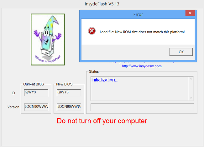

I expected something like that... The AW systems sometime have similar issues after downgrading with the USB recovery method and then trying to flash a bios.
The firmware image of the win8 bios of those systems have a different layout, I think that's what's causing the issue, also in this case.

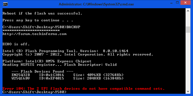

Ran into an interesting issue, when I attempted to run a backup using the flasher you've provided a few posts ago.
[ATTACH=CONFIG]5763[/ATTACH]
I get the same, wonder if one of the people who did rip the bios can apply it
I was able to dump the BIOS with svl7's utility!! The trick was to run the *.exe's in admin mode and unblock ALL files, this prevents Windows 8 seeing them as malicious files.
jovian, ShiftedView, I was not able to see clearly the error you get, but look at the post above, it might solve the problem.
Apparently to unblock the files, you can right-click on it and click on "Unblock File" according to this link: How to Unblock Files in Windows 8
Hope this can help.
