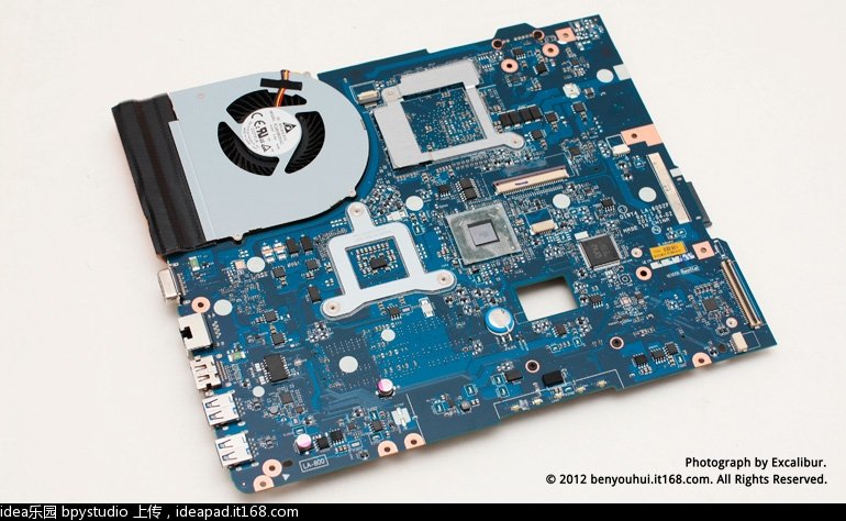

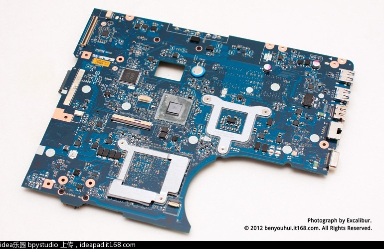

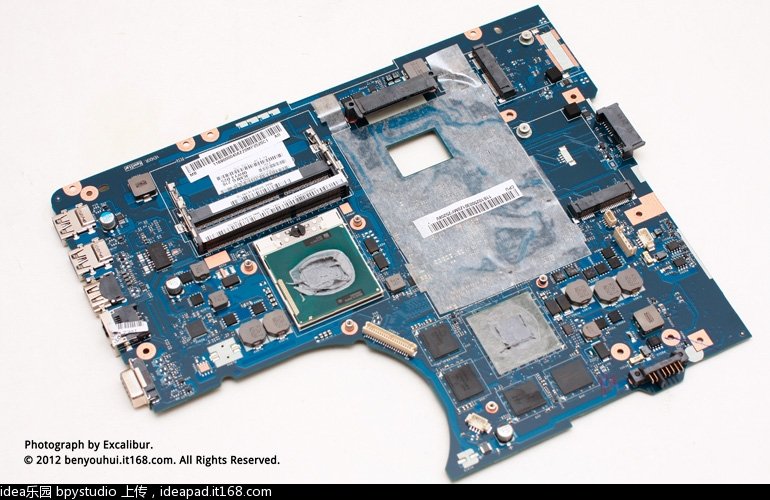

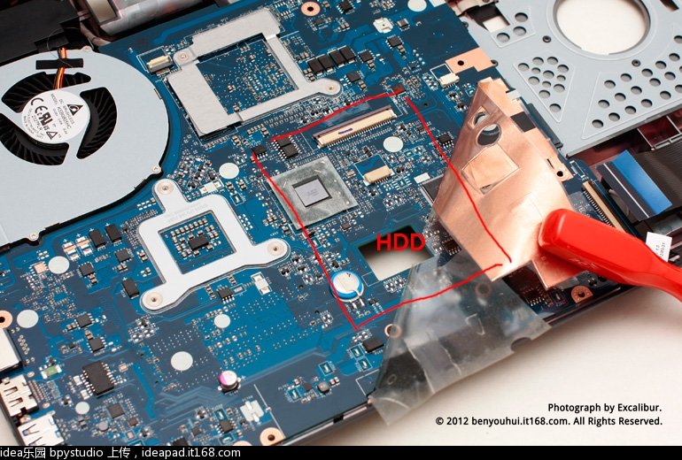

  1. I have dig some in web and I have found this: LINK. Take a look at page 36. I have found that i dont have R1207, R1208 and R1209 - who know what else. R1207 is 0Ohm 0402 smd resistor so it is shortcircuit. R1208 and R1209 are 100Ohm 1% 0402 smd. So it is no problem to buy it and solder. I have found mPcie connector for about 2$. So if it will work it will be very cheap mod. But if somebody could provide HIGH RESOLUTION images of Motherboard with Third mpcie it would be nice. I would like to compare it with my one and may be i will find another passive element that is missing on my Motherboard. (sorry for my bad English).
  2. Recently I was thinking about the same. I was curious if it is possible to solder second mpcie port. I was looking around the Web for hi res pictures of MoBo with originally soldered mpcie port because I wanted to compare it with my MoBo just to be sure there is no missing smd component. I think that I will borrow an oscilloscope from my friend I will measure something on this pass. I will be looking for 3V and 1.5V and may be for some digital signal. pinout

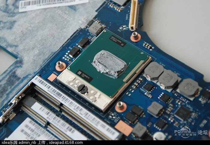

  4. Is it safe to overclocking 660m to 1000MHz? Does it not generate to much heat?

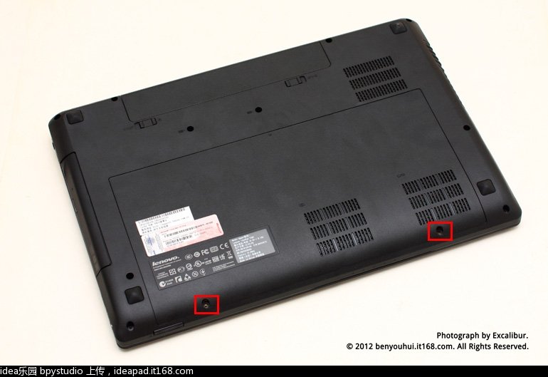

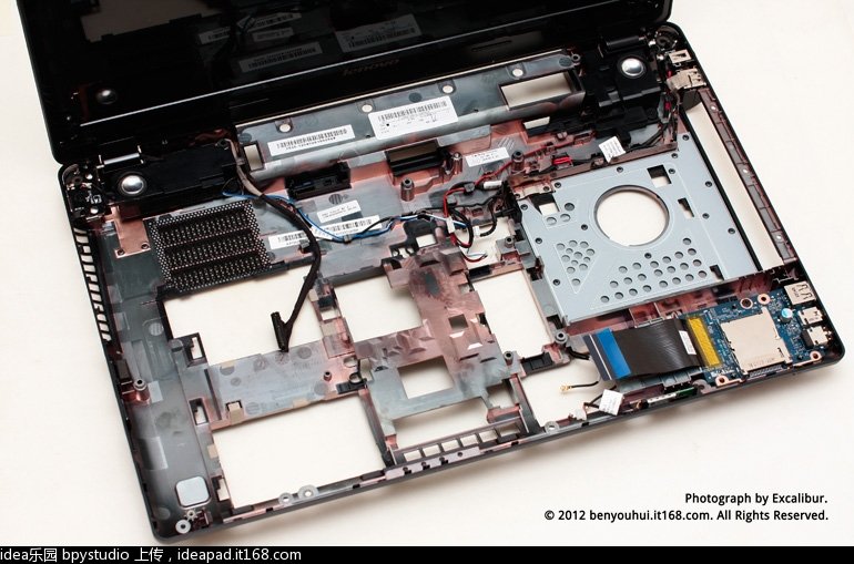

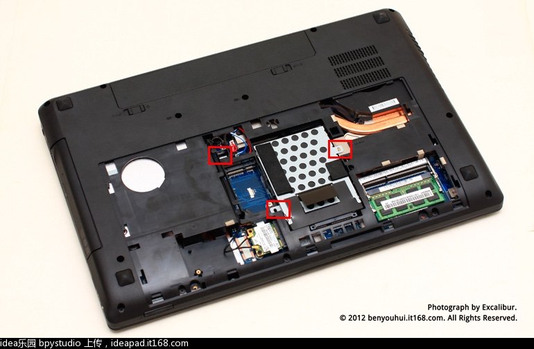

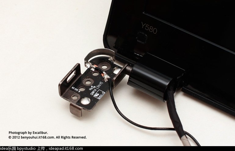

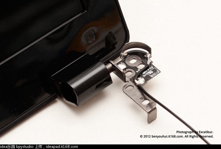

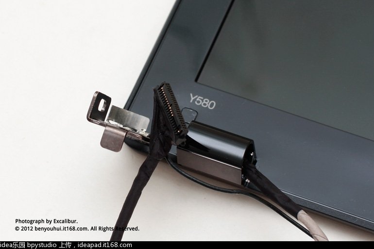

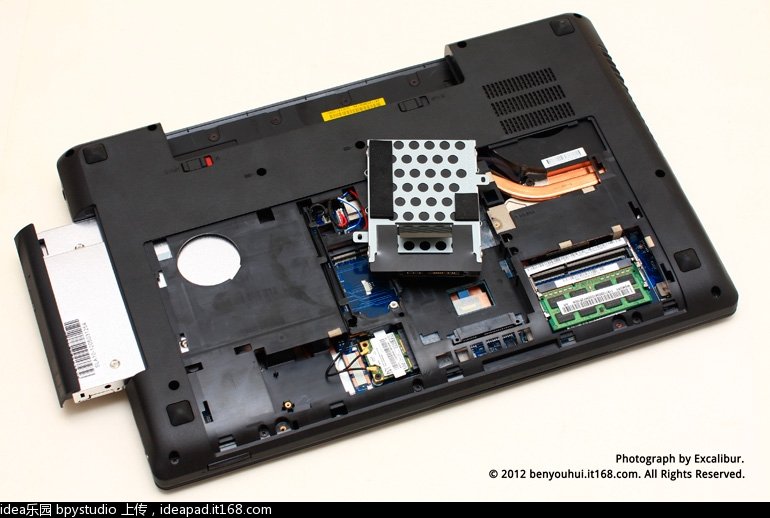

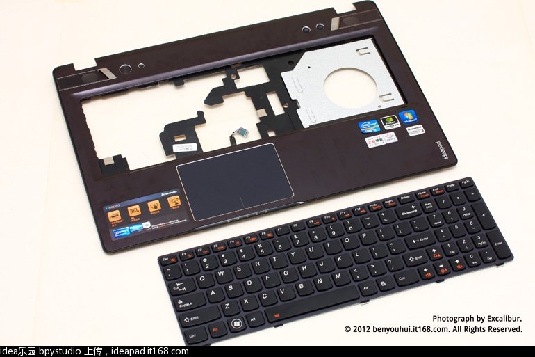

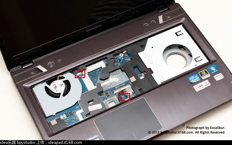

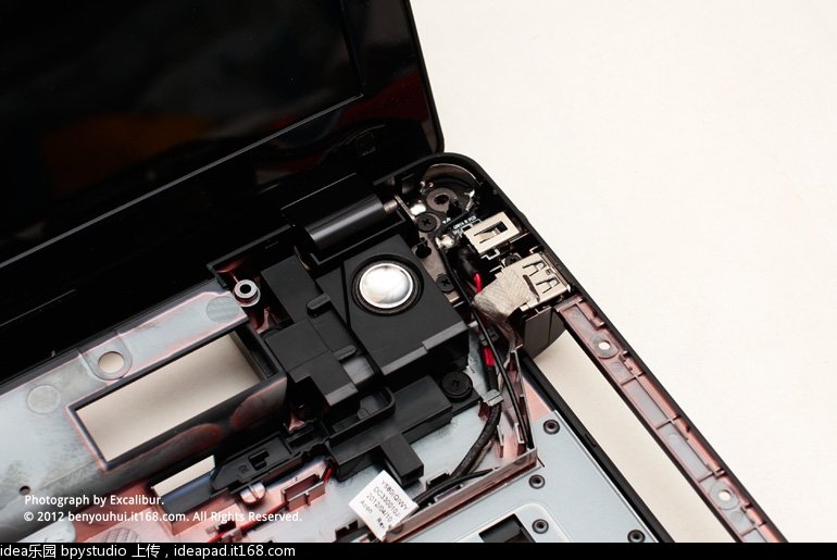

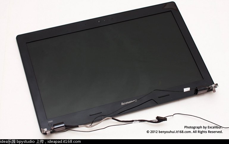

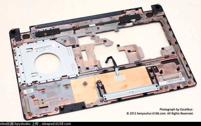

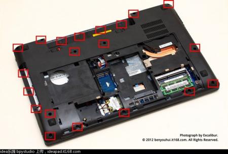

  7. Hello everybody, Today i will show You how to mount 3rd antenna to Lenovo y580. The new antenna came from LENOVO G550. I took shorter one (black one). Oryginally it was placed on display panel next to the camera. Look like that: I was trying three different places. 1st place was a TV card slot. The long cable was convoluted and placed over the antenna. 2nd place was black plastic below heatpipe, and over RAM. But i can not close the back cover so i resigned of that place. 3rd place was a left speaker. To take off the keyboard you have to unscrew 3 screws. Then you have to undermine the three hooks. I used a driver's license because it is lean and hard, respectively. Take a look at "Lenovo Y480/580 Hardware Maintenance Manual" on this post (end of 1st post): LINK page 46. You need to remove the three screws instead of two do not read page 45. Then you have to remove keyboard bezel. Use the same manual as above but page 48 to 50. Then, stick the double-sided tape antenna. Take a look at images. I have done some speed tests. My router: ASUS RT-N66u My PC 1: SSD 128GB, Gigabit LAN My PC 2: Lenovo Y580 SSD 128GB, WiFi 5GHz, WiFi card 3rd location Intel 6200: Max Download from PC1 to PC2 = 100Mbit/s Intel 6200: Max Download from PC2 to PC1 = 100Mbit/s Intel 6300: Max Download from PC1 to PC2 = 135Mbit/s Intel 6300: Max Download from PC2 to PC1 = 135Mbit/s I have done some performence tests. 1st place - very large disturbance, unstable connection, avg speed 80Mbit/s 2nd place - very large disturbance, unstable connection, avg speed 90Mbit/s 3rd place - no disturbance, stable connection, avg speed 135Mbit/s

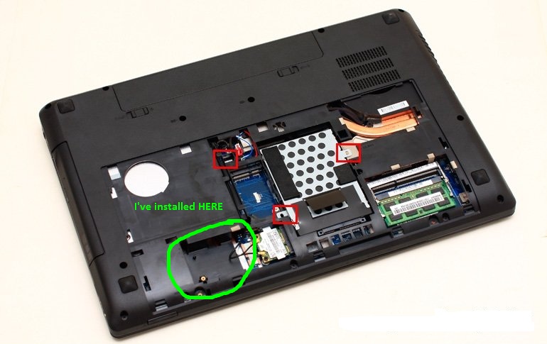

  8. Some of You wrote that you have installed intel 6300 wifi card. So I assume that you have added 3rd antenna to your Y580. Please tell or better show me where have you installed it? I installed my in TV card place. I have to come really close to my router (ASUS RT-N66u) to get 450Mbit/s. I wonder if I installed my 3rd antenna correctly.

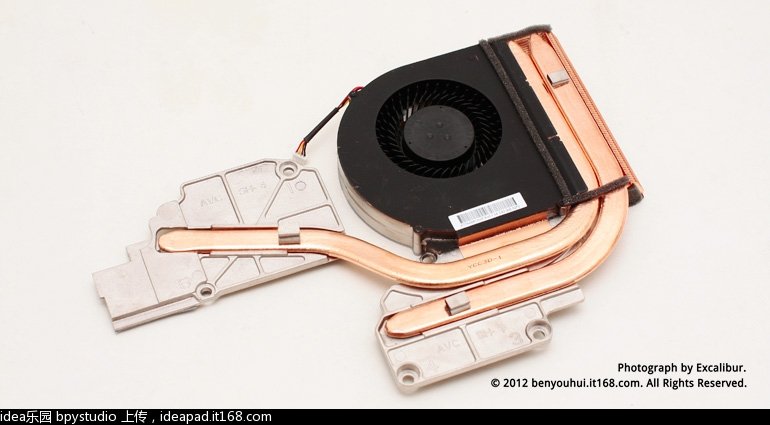

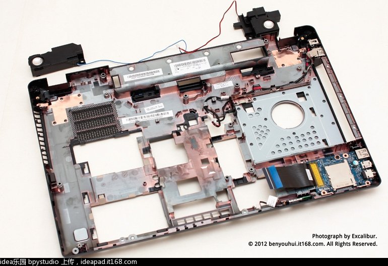

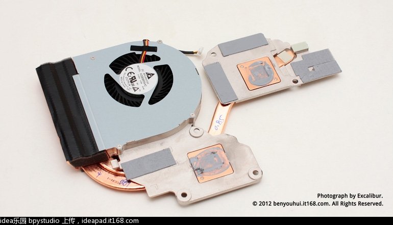

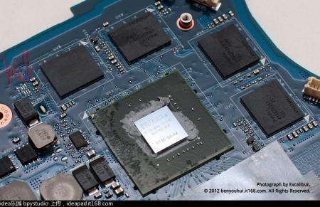

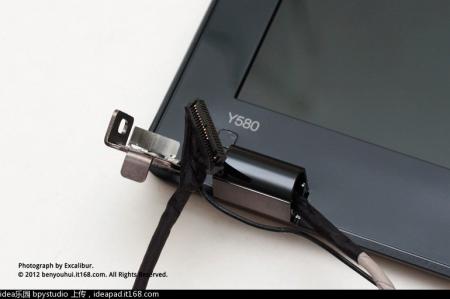

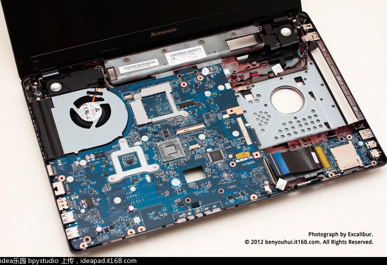

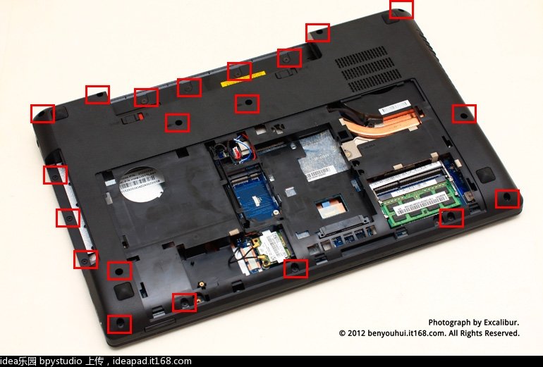

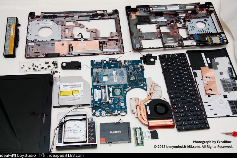

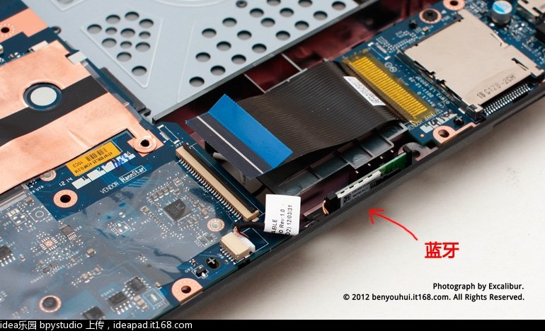

  10. Hi all, http://download.lenovo.com/consumer/mobiles_pub/ideapad_y480_y580_hmm_1st_edition_mar_2012_english.pdf 1. It's not my photos, originally posted at: DIY 2. Last link is to PDF manual created by Lenovo 3. ENJOY
