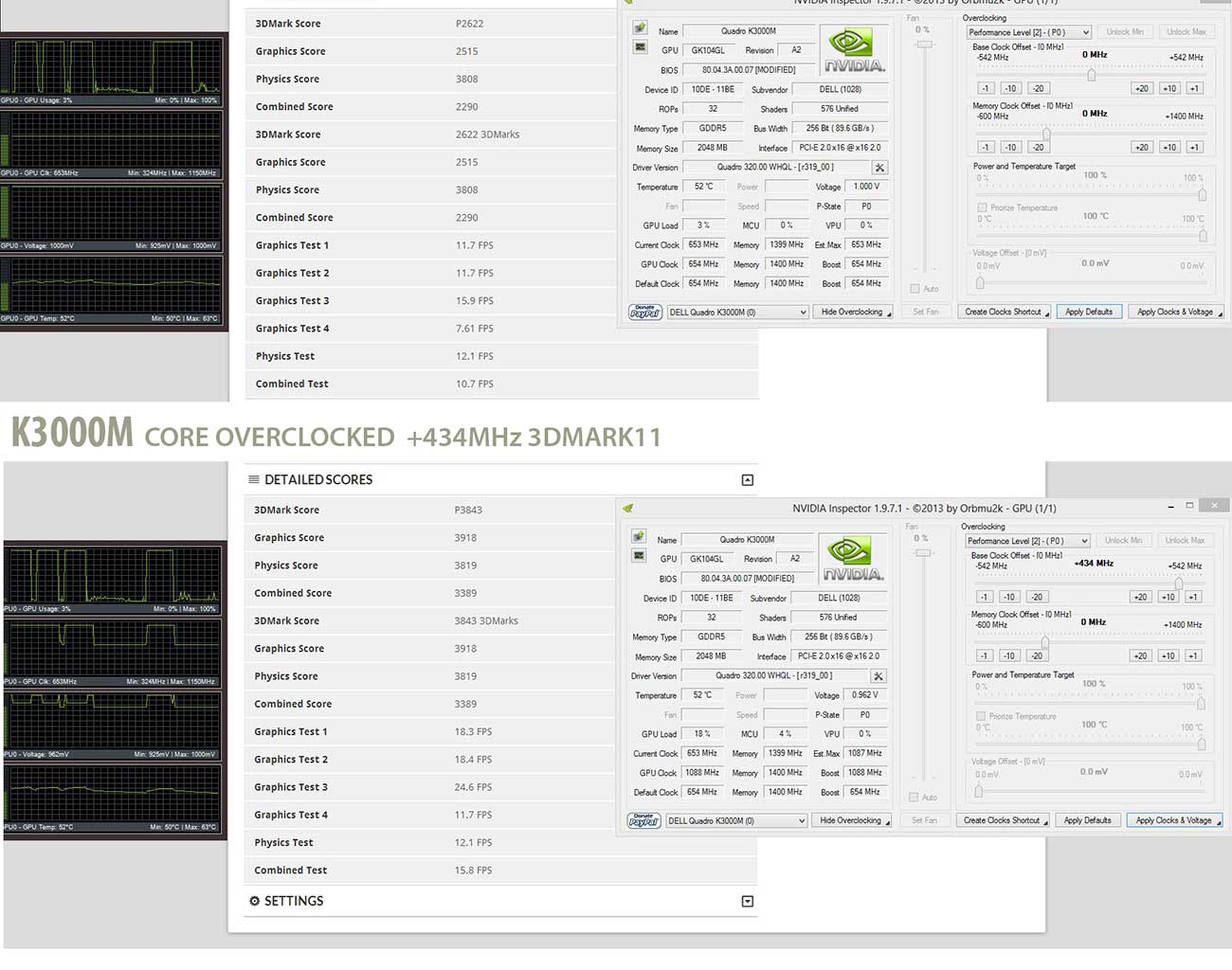

My quadro K3000M performance is almost the same as i had with my old 580M GTX in alienware M17x. Thats with +135MHz core OC. I just wonder how much can you push it in M6700 with stock voltages? I will definetly try K3000M vbios mod, but i dont wanna fry the card...
With just unlocked vbios (without OV), this card overclock perfectly. However, with OV vbios the real fun begins. :)
Nice 3dmark11 score, is that OC-ed score if so, then what was the original score:)
I have vbios mod and running my card +400MHz (CORE) and it gives me around 50-60% performance gain (~4000p in 3dmark11) with K3000M, and it is still cool and stable :)

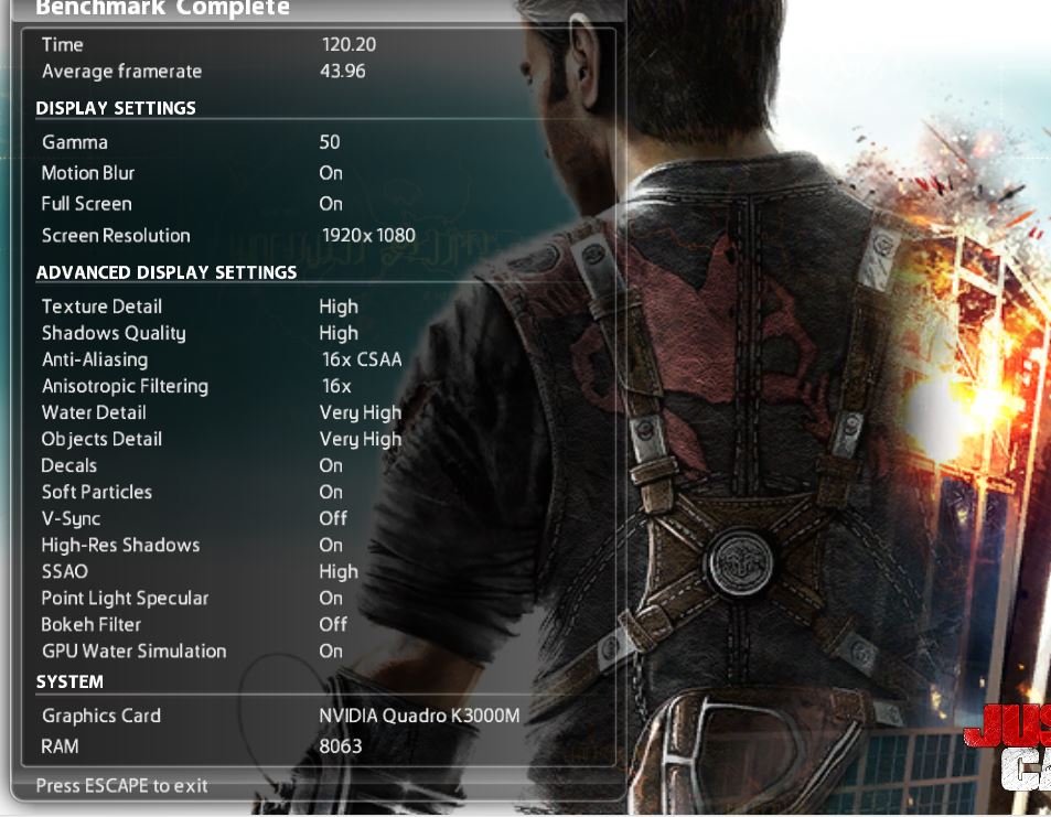

Just cause 2 maxed out (16xAA 16xAF ULTRA settings)
