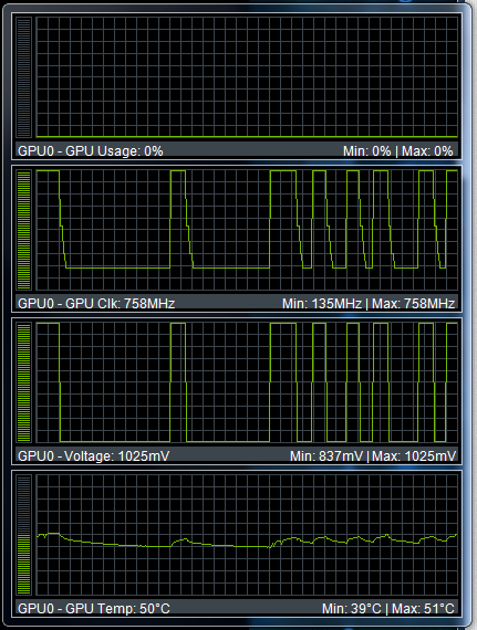

I have not touched anything related to system/drivers since December.
Today, after I noticed the issue, I decided to see if it was driver related. Uninstalled the drivers, did a driver sweep, then reinstalled the graphics drivers and receive the same issue.
There are certain occasions it would drop into the rest state, but I cannot force it to happen.
I uninstalled MSI Afterburner and noticed it to happen less as frequently and used Nvidia Inspector to view the clocks, but the issue still occurs.
This issue only began happening within the last four days in which I did not install anything.
EDIT: As of now, it jumps between 135, 231, 405, 758. This was just simple typing into this post and moving the browser around.
I've checked a list of system restores...the last one was since March 28 when I updated Java.
That MSI uninstall has improved the rest state condition however.
As for the OS being a possible culprit, there were no Windows/Microsoft related software or updates I've done.
As of now, after a reboot since uninstall of MSI Afterburner, its been at 135. If I do any action that just seems to load or move, it will go to 758 (instead of 405) and stay there for a few seconds before dropping again.
EDIT:
Attached image of what's going on. Playing with only a few applications at a time.post-7519-14494994996615_thumb.png
EDIT2:
The issue somehow resolved itself... I'm running the same applications and its capping at the 405 Mhz mark (which is good, its not very GPU intensive at all). Thanks for the help though @svl7.
I reinstalled MSI Afterburner and the issue has not reoccurred.
