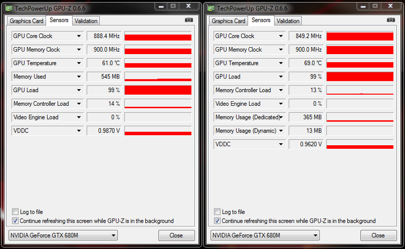

Do you guys get any throttling in any thing else? I mean, out of all the games and benchmarks other than 3dmark11 test 1? Anyone?

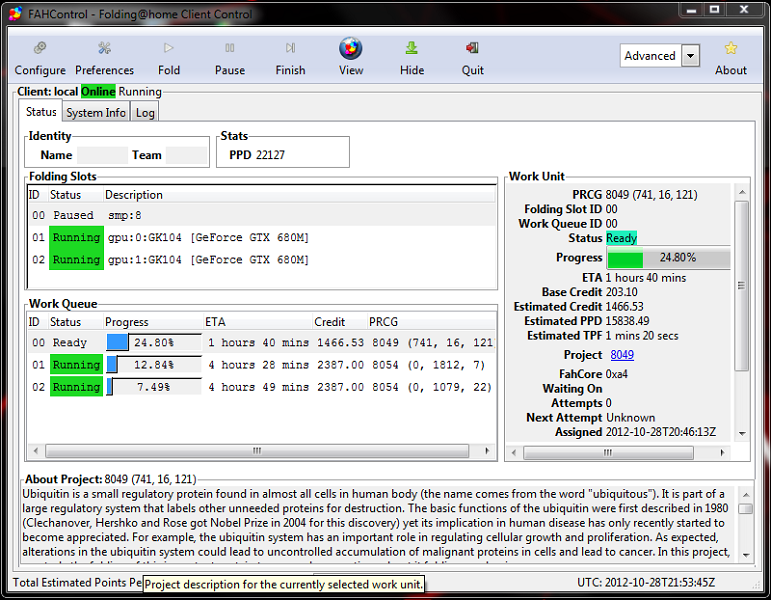

For anybody interested in another stress test, Stanford recently updated their assignment servers with the Dell GTX680m device ID's.
I've been getting a solid 22,000 PPD using both cards. 24/7 stable and running cool on 850 base ROM (no OV or OC).
I can get 900/2250 (+50, +450) with the 850 non-OV version. It does not throttle with the heaven demo. But I have not pushed it hard yet. That will happen this weekend.
Did not manage to do any specific benchmarking, but I managed to run at 950/2250 (+100, +450) for about 6-7 hours with various games and no throttling according to MSI afterburner. The GPU and memory speed graphs are just nice and flat and at the values I expect to see (~980 MhZ for GPU and 2250 for the memory). The GPU utilisation was about 97% and the temp never exceeded 80C.
next weekend, I'll try pushing it further. looks like the 850 non OV non OC version has lots of headroom.
I manage to get mine stable at 895/2480. I also tried higher clocks in heaven that seemed to be stable, but when I launch Trine 2 (very gpu intensive game) the gpus starts throttling within a minute.
Even with these low clocks the gpu may throttle after playing for 1-2 hours, but easy to solve by using fn1 a few minutes.
I also noticed that memmory clocks give pretty high fps increase with these cards.
