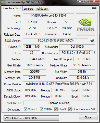

Hi everyone! New here but wanted to chime in with some feedback and questions.
Just picked up a M18xR2 with A05 BIOS and GTX680M SLI. Tried using afterburner to change core clocks but couldn't - only memory clocks worked. Went and downloaded this guy which gave me a modest boost to 819, but still couldn't get afterburner to change core clocks.
I've read that the M18x bios is preventing software OC, so I flashed from A05 to A07 - afterburner still won't work. Flashing A08 failed - loss of sound hardware after reboot.
What I'd like to do is go past 819 on core with a simple tool like afterburner. Is there a particular vbios I should be using, or has Dell crippled things with a lousy system bios? Any/all help appreciated!

[ATTACH=CONFIG]5211[/ATTACH]
Flashing to the new bios means if you wanted an unlocked bios with a lot of overclock options more than standard it may be hard if not impossible to flash to one once on A08 and A07, im sorry. The vbios is the only thing that controls the 680m. Some one here may be able to direct you right to the thread for dell 680m overclock vbios.
I would recommend trying the vbios named "Dell 680m - 850 base - 889 boost - OV - OC" on the first page. That one seems to work well for me. I've been able to run the core at 1000 and the memory at 1200 with it. Afterburner does not show the core frequency increase, but it shows the memory. If using Afterburner does not change the clocks (you will only know if it's working by running benchmarks and comparing the before and after) then possibly also try nVidiaInspector to see if that works for you?

Hi Luscious, welcome! I need to clean up this thread a bit, there's a 'newOCedition' of the Dell version somewhere attached to one of the posts, it will allow you to overclock the core. I guess I can slightly improve it, will post a newer version when I find time. Still haven't solved the throttling of the Dell card at higher clocks though... only bricked my card twice while experimenting a bit.

@mw86 - Yeah, I'm not too worried about the unlocked system BIOS ATM. A08 seems to be working fine, and I've been able to get a good 4.2 OC that's 24/7 stable. I'm not looking to break records, just a fast rig that can handle things like F@H SMP.
@Keith1341 - I'd like to take that one for a test drive, but I'm still below the 5 post limit :-( 850 seems very doable on core, but the fastest I've been able to get memory has been 1200 - anything higher and I start getting artifacts in 3DMark11.
@svl7 - Thanks! Would definitely be happy to look at a newer vBIOS. I've yet to see my GPU throttle at 819 or at it's stock speed. Does the OC vBIOS unlock the core for use with afterburner or have you set it to a fixed speed?
