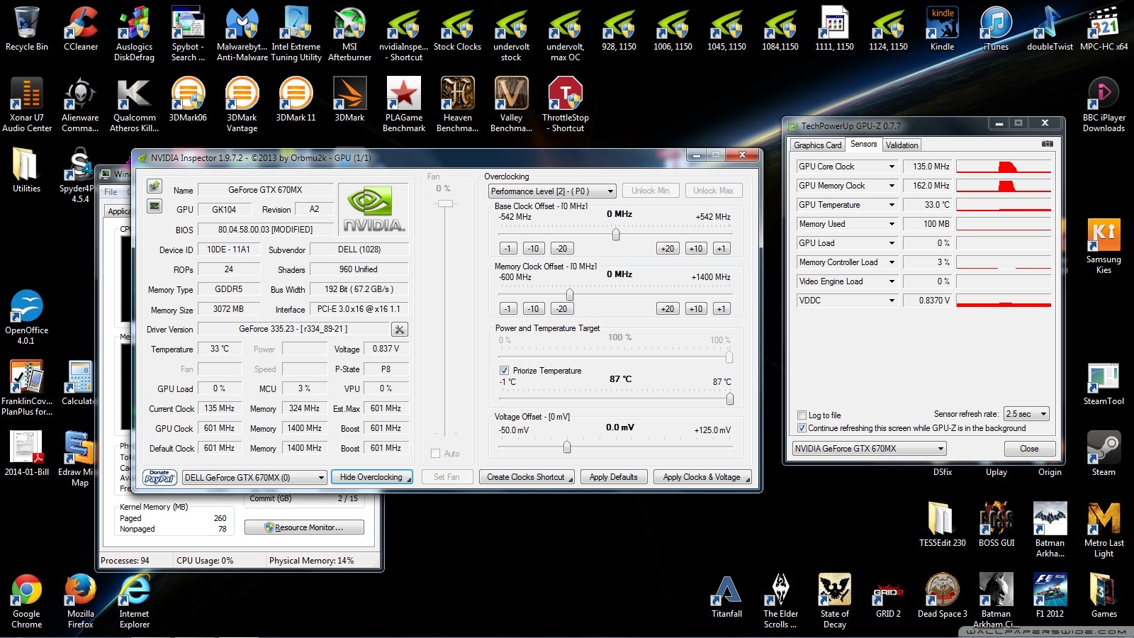

@svl7, I noticed something has changed in NVidia Inspector recently, I think it's due to the latest NVidia drivers. I noticed that 'Prioritise Temperature' has suddenly become a choosable & configurable option, previously it was greyed out, or not there at all (as far as I can remember). I thought this might be of use or of interest to you. Do you know why that has suddenly become a configurable option with the latest drivers? Could it have anything to do with why in the latest drivers users like Mr Fox have had throttling problems since installing the latest drivers (and apparently can't be fixed by installing previous drivers)?
Here's a pic showing what I'm talking about re 'Prioritize Temperature':
I have had that option for a while, even before updating to latest nvidia drivers. Unfortunately, it doesn't do anything. I can change the slider, but when I hit apply, it goes back to 87C: http://i.imgur.com/zCaoqtj.png

Yep, a properly modded vbios can fix this. Unfortunately, there is no properly modded vbios for the 880m available right now.
Cheers for the reply. :-) So, was it like that from the beginning for you, or do you think it's something that's been enabled in one of the drivers in the not so distant past? I'm pretty sure I've not seen it before (but I could be wrong!).
I dont normally use nvidia inspector but I think I remember seeing that option when I opened that program a few months ago. I quickly lost interest in it since that option doesn't do anything for me.
