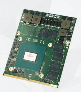

Anyway I have found an Aetina version of the GTX 1060 MXM, analytical specs link :
  • Model Number M3N1060-MN
  • Bus Type MXM 3.1
  • Memory Size 6GB GDDR5
  • Memory Clock (MHz) 4000 (8.0 Gbps)
  • Form Factor MXM graphics module version 3.1 Type B
  • Dimensions (mm) 105x82
Will this work you think?

PS :  I assume that this MXM board for the Clevo P7 series, with a separate power supply socket, across the PCI pins, will not work?
It also looks like it's wider.
