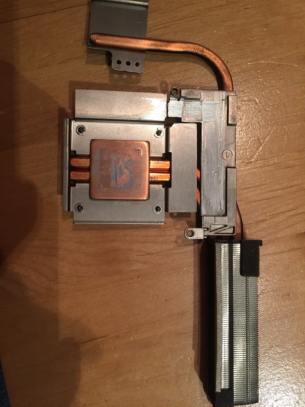

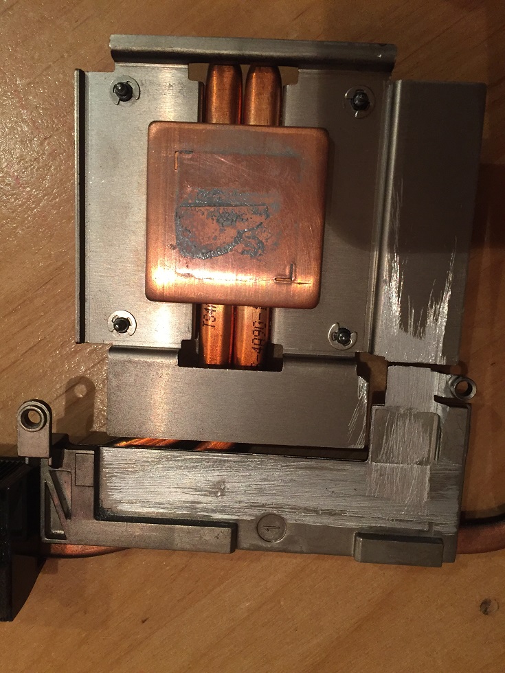

Bloetschkopf Posted December 25, 2016 Author Share Posted December 25, 2016 Yes,i did it by myself.I modified the GT72 Heatsink like the Picture. The Card is a MSI Card,but Youhave to change a Driver Inf for working. After this the Cards works like every Card without any Issues. 1 Quote Link to comment Share on other sites More sharing options...

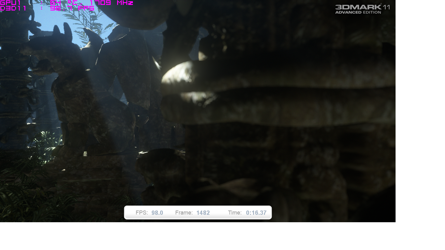

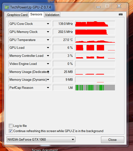

andrzejz78 Posted January 1, 2017 Share Posted January 1, 2017 3dMark11 throttlen, Limits TDP only 78W Quote Link to comment Share on other sites More sharing options...
Bloetschkopf Posted January 1, 2017 Author Share Posted January 1, 2017 Have You more than 60 Fps in 3Dmark11? I can`t see anything about 78W Quote Link to comment Share on other sites More sharing options...
andrzejz78 Posted January 1, 2017 Share Posted January 1, 2017 3 graphics test 3Dmark11 even 100fps;)Immediately give screenshot Quote Link to comment Share on other sites More sharing options...
