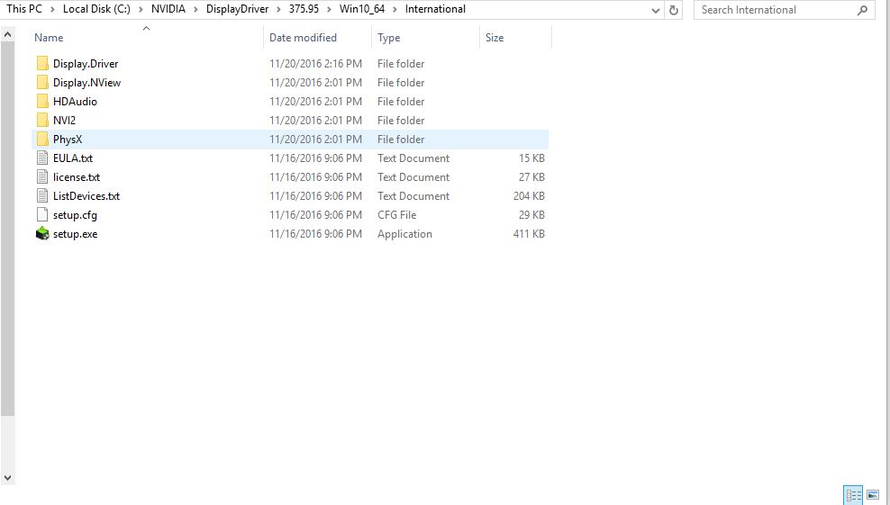

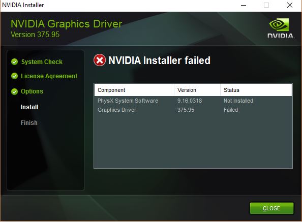

Before I proceed, let me tell you my system info. I have an Alienware m17xR4 and I have the latest Windows 10. I recently bought nVIDIA gtx 970m and the laptop is in switchable graphics mode (the graphic card won't work in dedicated graphics mode).
I will also mention everything I have done so far.
1. I flashed Prema's bios mod for 970m
2. I disabled driver signature enforcement using the menu in F8.
3. I ran DDU and used "clean and shutdown" option.
4. Then I downloaded nVIDIA 375.95 drivers using the link you mentioned in your post. I extracted them.
5. I went to the Display.Driver folder and overwrote the two files nv_dispi.inf (including nvdmi.inf) for Alienware windows 10.
6. I deleted the unnecessary folders. This was the list of files I had.
7. Then I ran setup.exe. I have tried both custom and express install but still I get the "failed" message.
Please help!!!

@joluke@inphtech YOU'RE RIGHT! The driver signature enforcement disabling is valid for only one boot!
Since I disabled driver signature enforcement first and then I ran DDU, I was no longer in the disable driver signature enforcement session.
I'm sorry for my noobiness! THANKS A LOT @joluke@inphtech
AND THANKS FOR THE MODS @J95!
