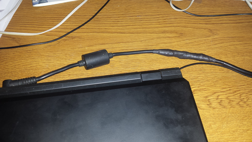

  2. Is there a prema vbios already O.C for gtx 980m?
  3. You can see in the picture. I was having this issue with my old unmodded 180w PSU as well.
  4. Really?? So I need a 330w PSU? It only turns off if I use Premamod vbios, without tweaking the voltage.
  5. Hi, I tried to solder the original plug-in jack of my 180w PSU to a DELL ( Flextronics) 240w PSU. I connected the ID wire to the ground and white to white as you instructred, but the Adapter shuts down 1-2 min after GPU is under full load. I have a Clevo P157SM and upgraded 2 summers ago to a GTX 980M which needed more power. It is only doing this while using prema's vbios. I didn't change any settings. My laptop was working well with the 180w as well, but many users reported that it needs more power. Need a bit of help. Thanks!
