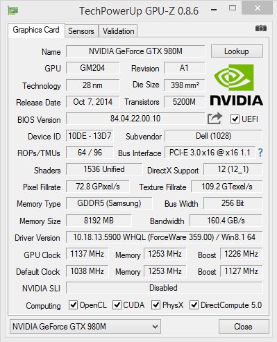

Maxx73 Posted February 22, 2016 Share Posted February 22, 2016 (edited) Hi Do you have any best drivers then 359.00 and 358.50 to my 980M PCI\VEN_10DE&DEV_13D7&SUBSYS_05AA1028&REV_A1 PCI\VEN_10DE&DEV_13D7&SUBSYS_05AA1028 PCI\VEN_10DE&DEV_13D7&CC_030000 PCI\VEN_10DE&DEV_13D7&CC_0300 Spoiler I can't start Fallout 4 and The Division Beta on dedicated graphics they are starting with Intel HD4600 - I know that because when games start graphics fan almost doesn't work and processor fan starting with maximum RPM... I install modded drivers fromhttp://downloads.eurocom.com/support/drivers/upgradeyourlaptop/Alienware/ Version 359.00 and 358.50 and still same problem. Of course i try start both games with right button with hight performance nvidia graphic processor After that I enter to device manager and manually turn off INTEL HD graphic but that don't help... I update bios to A14 (alienware 17r5 (2013)) I try Fn-F5 as well ... Edited February 22, 2016 by Maxx73 Quote Link to comment Share on other sites More sharing options...

bamse1 Posted February 27, 2016 Share Posted February 27, 2016 Hello guys, I've recently installed a 980M 8Gb card into M17x R4 (A12 standard/manufacturer bios, UEFI, Optimus enabled, Windows 8.1, Drivers 358.50 from Eurocom) and it seems that the card isn't running at it's full potential - meaning that I can't score more than 6500 in firestrike (graphics score around 7800), although I saw much higher scores from other users.I don't want to OC yet, the score above mentioned is at stock clocks.Can you please help me with some information regarding what should I do to increase the performance because I've just spent around 900 USD for not even 40% performance increase from my old 7970M, so I'm thinking that I must be doing something wrong...Many thanks in advance! Quote Link to comment Share on other sites More sharing options...

J95 Posted February 29, 2016 Author Share Posted February 29, 2016 On 2/22/2016 at 10:10 AM, Maxx73 said: Hi Do you have any best drivers then 359.00 and 358.50 to my 980M PCI\VEN_10DE&DEV_13D7&SUBSYS_05AA1028&REV_A1 PCI\VEN_10DE&DEV_13D7&SUBSYS_05AA1028 PCI\VEN_10DE&DEV_13D7&CC_030000 PCI\VEN_10DE&DEV_13D7&CC_0300 Reveal hidden contents I can't start Fallout 4 and The Division Beta on dedicated graphics they are starting with Intel HD4600 - I know that because when games start graphics fan almost doesn't work and processor fan starting with maximum RPM... I install modded drivers fromhttp://downloads.eurocom.com/support/drivers/upgradeyourlaptop/Alienware/ Version 359.00 and 358.50 and still same problem. Of course i try start both games with right button with hight performance nvidia graphic processor After that I enter to device manager and manually turn off INTEL HD graphic but that don't help... I update bios to A14 (alienware 17r5 (2013)) I try Fn-F5 as well ... Uninstall drivers using DDU "Clean & shutdown" -> Install latest Intel drivers -> F8 Disable driver signing -> Install v361.75 nvcvi.inf (Optimus fix) -> Manage 3D settings -> set "high performance nvidia graphic processor" On 2/23/2016 at 6:02 PM, 82280zx said: I need to report a bug with 352.84_PEG_MOD_win10 drivers for a M18XR2 with a 980m after shutting down windows 10. The system would boot what looked like normal but after a bit the screen would go black then I would get a mostly white screen with a mouse cursor, you could also see some colors in the white but speckled everywhere, then after a short moment it would go to a flashing screen with white squares on the bottom, I would have to hard power the system down, after that though things came up normal the bug seemes to occur after a shutdown every time (I was using Prema V2 vbios as well). I rolled back to an older driver 347.25 and that problem disappeared, I also tried out the newer driver @J95 had posted, I got it to install fine with no issues but I ran into throttling issues =/ so I rolled back but thank you guys for all your hard work! We would be lost without you guys. I also ran across another issue but not related to this driver, for those that use a M18XR2 with a 980m I seem to get random lock ups in games, I think I've narrowed it down to hwinfo64 controlling my fans (which sucks cause this helps my temps when they kick on earlier instead of 76-77), I'll keep testing to see if this was the issue. DDU "Clean & shutdown" -> Safe Mode -> Flash Prema's vBIOS CLEVO_8GB_GTX980M_OC_PM_v1.1.1 -> Install PEG MOD v352.84 Full_Profiles_4_v352.84.txt, please follow instructions to the letter. On 2/27/2016 at 7:19 AM, bamse1 said: Hello guys, I've recently installed a 980M 8Gb card into M17x R4 (A12 standard/manufacturer bios, UEFI, Optimus enabled, Windows 8.1, Drivers 358.50 from Eurocom) and it seems that the card isn't running at it's full potential - meaning that I can't score more than 6500 in firestrike (graphics score around 7800), although I saw much higher scores from other users.I don't want to OC yet, the score above mentioned is at stock clocks.Can you please help me with some information regarding what should I do to increase the performance because I've just spent around 900 USD for not even 40% performance increase from my old 7970M, so I'm thinking that I must be doing something wrong...Many thanks in advance! DDU "Clean & Shutdown" -> Disable driver signing -> Flash Prema's vBIOS CLEVO_8GB_GTX980M_OC_PM_v1.1.1 -> Install PEG MOD v353.00 + Full_Profiles_8_v353.00.txt 4 hours ago, Billy54 said: Anyone else run into the (most likely optimus related) problem where after upgrading your gpu, the integrated graphics card becomes the default display adapter for external displays? My 680M couldn't handle 4k gaming, and my new 980M won't even display in 4k. The integrated chip's max display output resolution is some form of 2k... DDU "Clean and Shutdown" -> Install latest Intel HD drivers -> Disable Driver signing -> Install NV drivers v361.75 (Optimus Fixes). Quote 361.xx Requirements: Due to driver incompatibility (black screens, TDRs, BSODs...) with previous vBIOS versions you must flash latest @Prema's v2 980M & 970M (Please consider donating to Prema) Quote Link to comment Share on other sites More sharing options...
