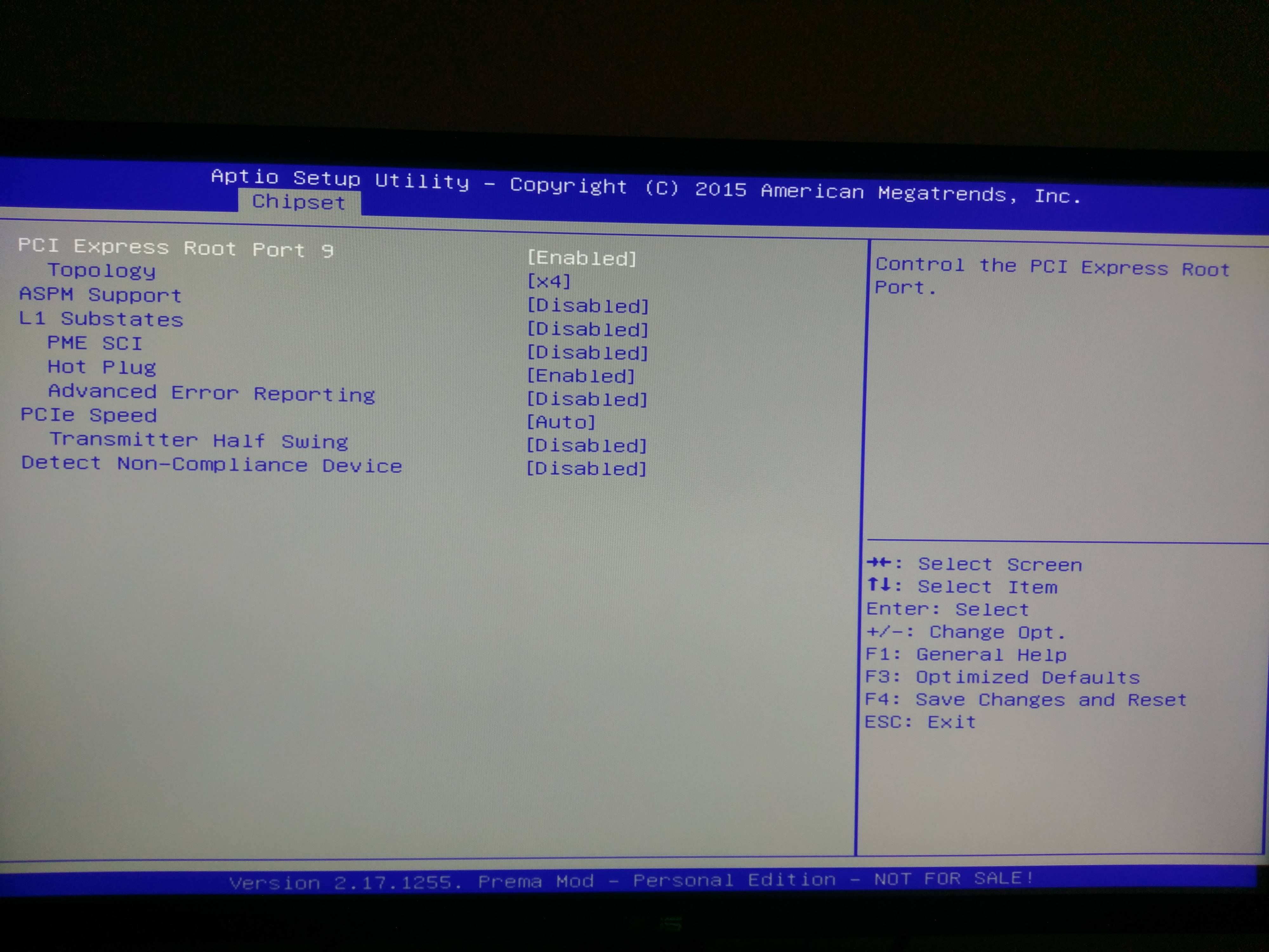

I managed to get the new drivers working on my system, might or might not work for you guys :
Went into the BIOS and disabled - Advanced Error reporting for the PCIe slot i had my GTX 1080 connected to.
Spoiler
Also not sure if this is possible with every BIOS or not. Since i dont quite have the standard issue Prema BIOS.
  Reveal hidden contents
Great investigation.  Rightly so, if don't have such a BIOS setting then the problem persists with newer NVidia drivers.

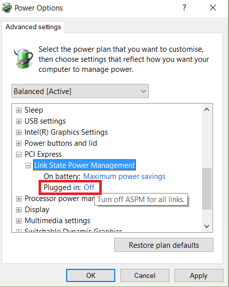

Can you disable ASPM in your power profile using pic below  (PCI Express -> Link State Power Management -> off ), re-enable ASPM in the BIOS and see if this power profile setting gives an equivalent fix?

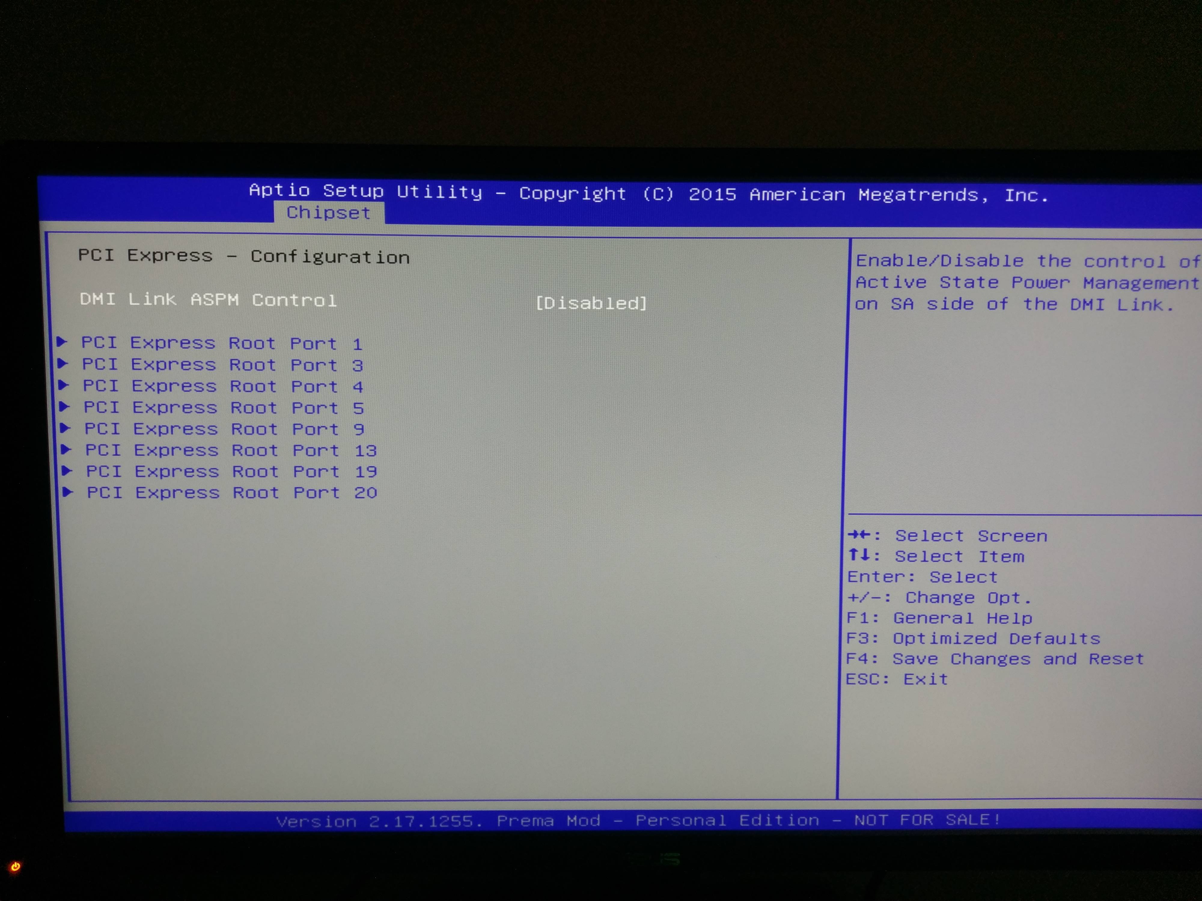

Ill give that a shot. But i have ASPM disabled everywhere in my BIOS. Do you think ASPM might be causing this? I have it disabled in my power profiles as well.
Never quite used it in a long time, since it caused some issues for me, a while back.
It was a total brain fart while doing something else in the BIOS, figured since the system says the card is reporting problems, just make the card NOT report those problems :P

Ill give that a shot. But i have ASPM disabled everywhere in my BIOS. Do you ASPM might be causing this?
Yes, per previous message pls disable ASPM in power profile and enable it in BIOS to see if this is a fix for users without extensive BIOS options like you have. Based on your previous comments, it appears ASPM is causing error 43 in the newest NViDia drivers.
That didnt help.
I set Advanced error reporting back to Enabled and Enabled ASPM as well, along with double checking if its enabled in the power profile as. With the drivers installed and working, there was no change and things were normal, but if i reinstalled the drivers, it would result in a code 43. I had to disable Advanced error reporting again in order for the drivers to install and then i could do whatever i please. Enabling or disabling either of the settings didnt cause any issues or changes, after a successful installation.

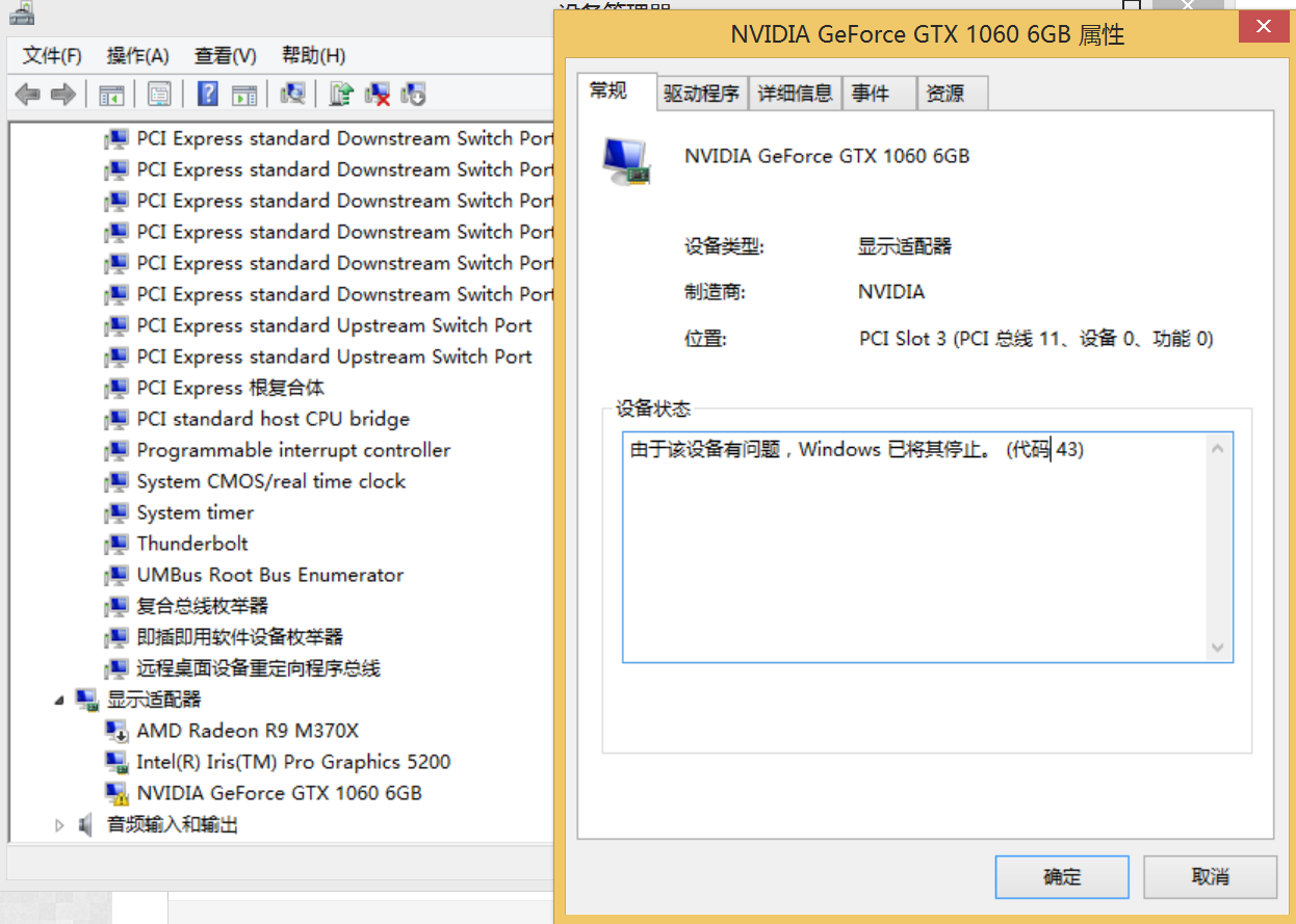

I ‘'ve following the instruction in this thread and finally got error 43 on my GTX 1060, and my external monitor got nothing but black. How could I solve this problem?

I'd like to confirm my theory earlier concerning the Code 43 device error.
Seems like the newer nvidia drivers are trying to reset the graphics device while installing but such feature called "Hotplugging" is not safe on laptops so the BIOS actually partially disables the device to avoid further conflict.
So the solution is enabling "Hotplug" in the PCIe settings in BIOS.
For those who are not able to access the advanced options, You will either have to wait for Nvidia to fix it or actually install a custom BIOS (This is dangerous).
@Tech Inferno Fan @GTANAdam
So here are my findings in relation to AER and Hot Plug using the latest drivers 375.70 :
  • AER - Enabled + Hot Plug Enabled - NO CODE 43 / ERRORS
  • AER Disabled + Hot Plug Enabled  - NO CODE 43 / ERRORS
  • AER Disabled + Hot Plug Disabled - CODE 43
  • AER Enabled + Hot Plug Disabled - CODE 43
So AER doesn't seem to the culprit here, its Hot Plugging. This would lead me to believe they are trying to optimize hot plugging of eGPU's. Since it seems to work 8 out of 10 times when i plug in my GPU over TB3.
So if you guys have the Hot Plug option in your option in your BIOS for PCIe ports, maybe that will help. Or if @Tech Inferno Fan can implement it in his setup.
Props to @GTANAdam for noticing the Hot Plug being enabled.

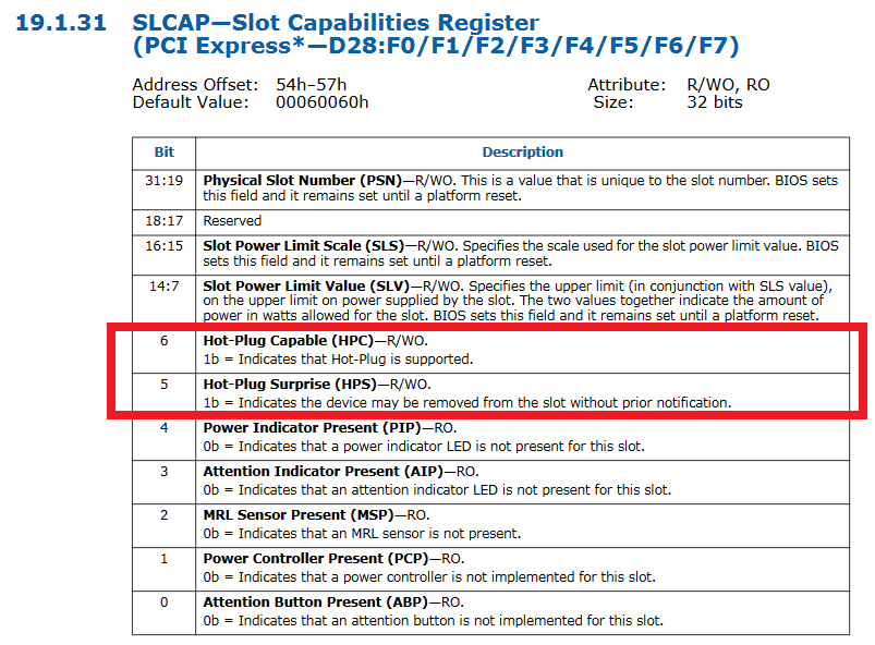

@bloodhawk, @GTANAdam, great troubleshooting in getting to the bottom of this.
Unfortunately the PCIe port hotplug bits are read and write-once (R/WO), so we can't change them after the BIOS has set them as shown from Intel's datasheet extract below. I've also confirmed these are write-once by attempting PCI writes to the register and seeing it doesn't change.
