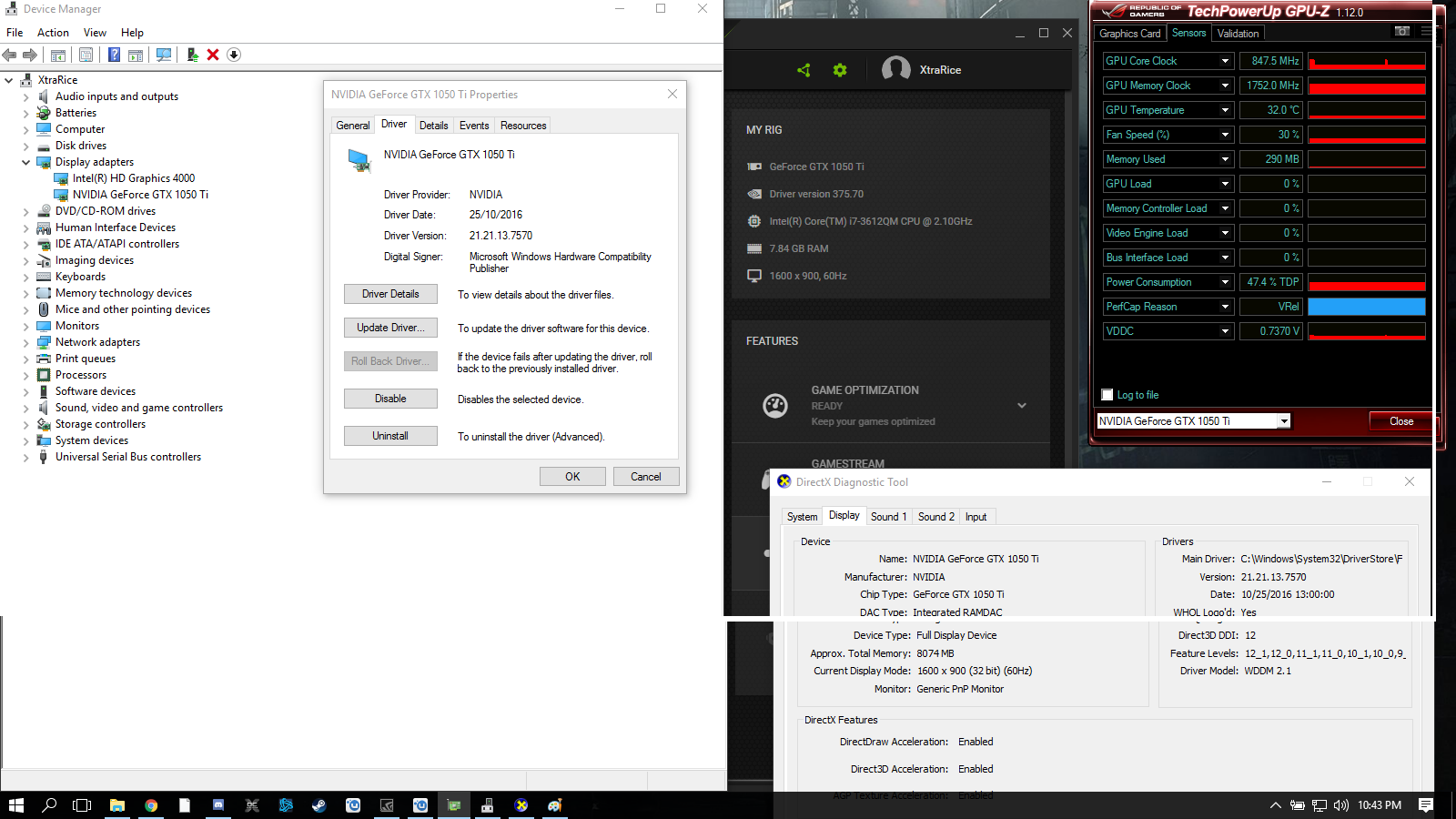

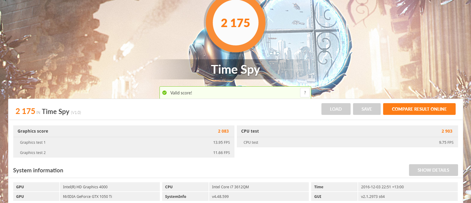

  5. flashed my bios with the version that opens all option available (got it from a forum about bios mods). with regards to the "evidence" i will post it here once i get home as im still at work
  6. yes, but for those who do, you guys don't need to mod the nv_dispi. just enable hot plug/swap for your Mpcie. if you have uefi MB just enable it, if you have bios, search for a way to open/unlock all option just install like you would normally do and ignore the error 43 you will get, restart your computer and the error 43 should be gone. however i had to go back to 375.63 as im experiencing problems when im playing the division.
  7. if you can enable hot plugging on your mpcie thru your MB then you dont need to do any modding. im currently using gtx 1050 ti oc on my acer aspire v3-471g windows 10 laptop with exp gdc beast v8.0 setup with no mod . just mod my bios to enable all option and VIOLA!!!
